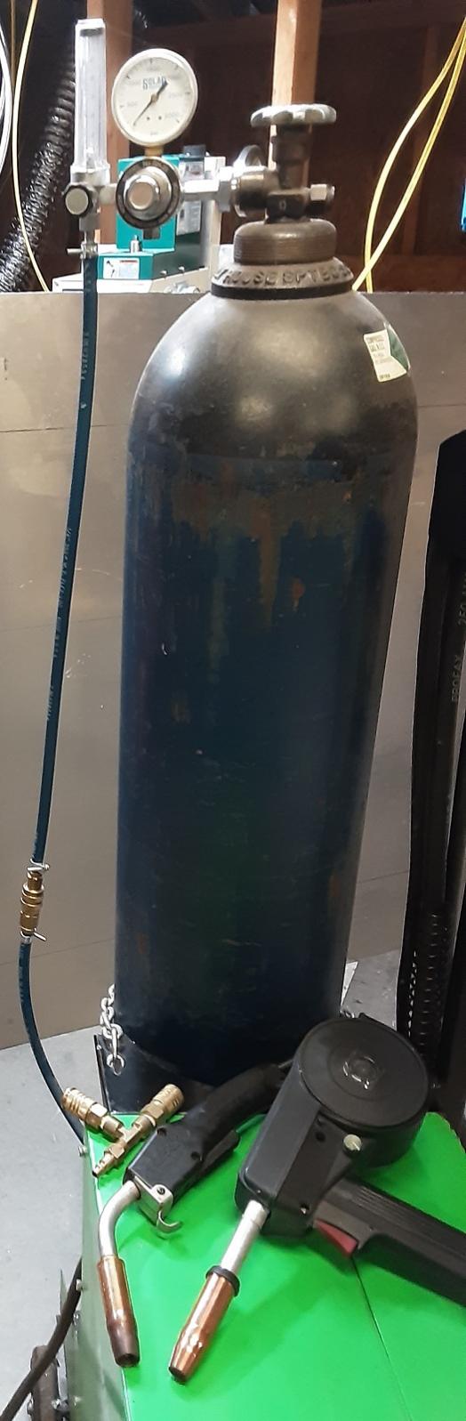

ID:	13946 This is what I use on my MTS 251Si and MTS 221STi.

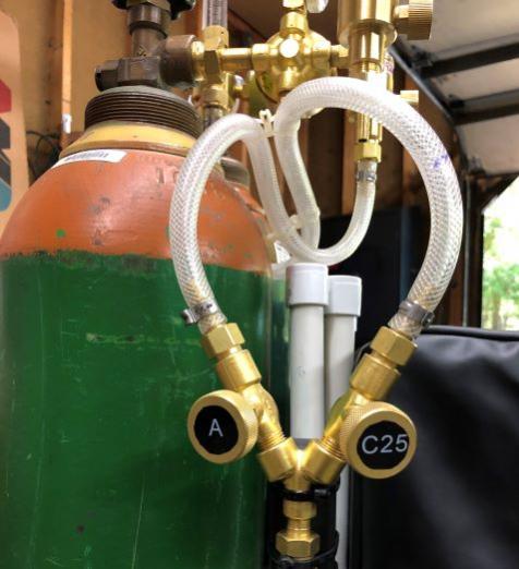

    Ive been searching for a solution for this very problem and couldn't find much info on two bottle connected to one welder. I found tons of info on one bottle and two welders though, anyway I just ordered what should solve my problem from Amazon. I got a Y connector which fits my gas lines from my argon and c25 bottles, short gas hose, and adapter to connect a short hose from the Y to my Everlast MTS251si multi process unit. Everything fits standard hose ends and I'm just waiting on the short hose to connect to the welder. Hopefully this helps someone else. After trying too switch from TIG to MIG and I didn't connect the gas line which resulted in me emptying my c25 bottle into the air (Rookie move I know), I'm a home hobby welder and recently switched from a Lincoln MiG to the MTS251si. Anyway, I decided I needed to get a better method. I was already planning to do this but just could never find info of what exactly I needed.
    Here what I ordered, hope this helps someone else.
    Y Connector
    https://www.amazon.com/gp/product/B0...A1QZKSFGQN5HY7
    Argon Hose - 18"
    https://www.amazon.com/gp/product/B0...A317TR1CT4N6E9
    Fitting Adator
    https://www.amazon.com/gp/product/B0...A32RJSSCTUIP2F

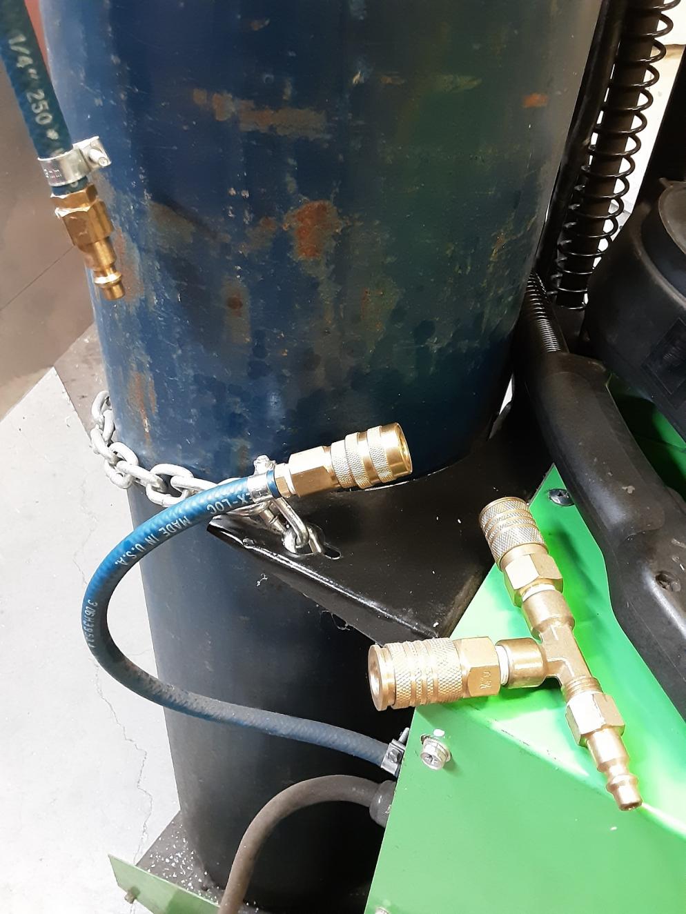

    I use the same quick couplings that you find on compressed air hoses. I keep the 100%argon tank on my TIG cart and 75/25 on the MIG machine. I just put the two close to each other when I want to swap gas or mix gas to get a higher argon mix for spray arc. I've done this for about 10 years with no problems.
Name:	mig gas setup 1 - Copy.jpg
ID:	14026...Click image for larger version.
Name:	mig gas setup - Copy.jpg
