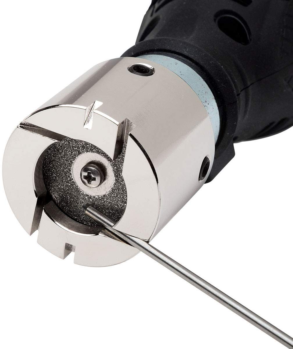

    I noticed a seller on Amazon having a clever new style tungsten grinder that will fit on a Dremel tool, of which I have two.
    https://www.amazon.com/ALUMINUM-Elec...4889437&sr=8-3

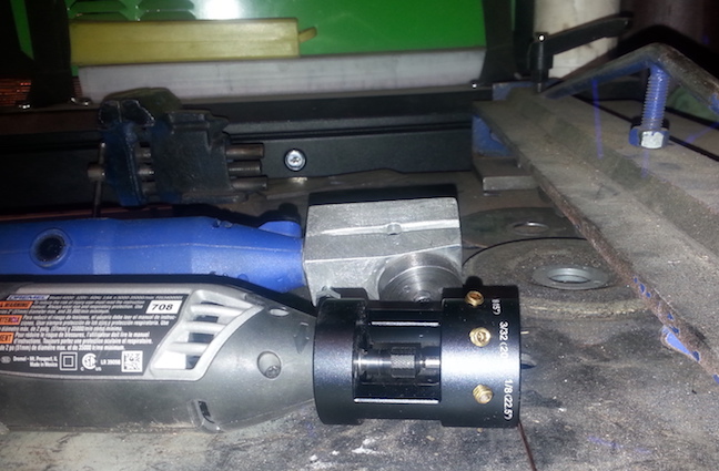

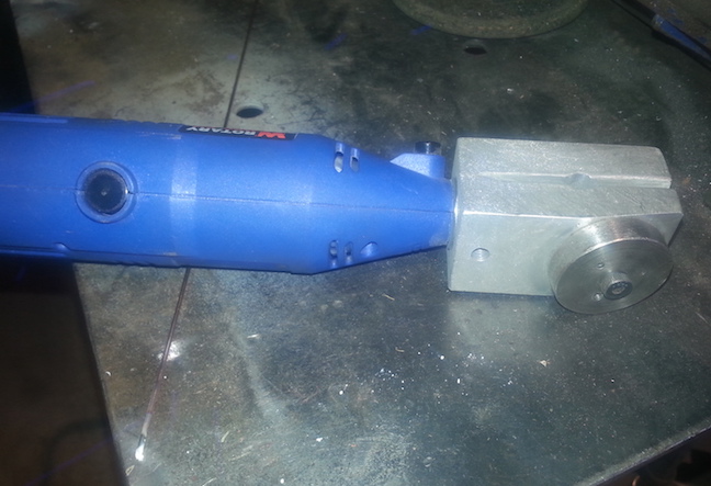

    I mean, I already have a dedicated Dremel-style tungsten sharpener that has a fixed-angle to it, and it doesn’t need any collet change-outs, like the typical Sharpie designs ($250-$400) seem to do. So, I do still like my current one OK, and it was only about $150, including the rotary tool, some years ago.
    But, this new style on is priced well, at about $98, if you already have a Dremel or similar thread-on style tool. It’s “4-sizes x 4 degrees”, with tungsten cut-off feature.

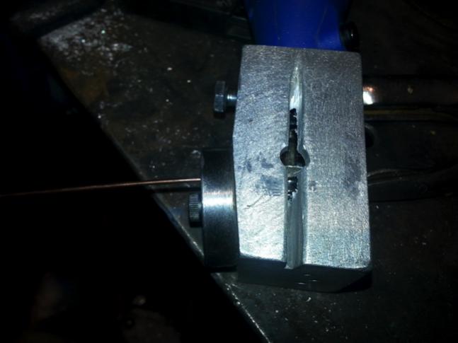

    My sharpener didn’t have a tungsten cut-off ability, until I made a channel in the billet aluminum head.

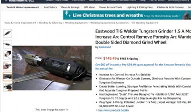

    Eastwood has a similar designed one that comes with the rotary tool too, at about $149, but only handles 1/16” and 3/32” tungstens, with two grind angle for each. Which is all I use, anyway. So, that’s a good value too, I think.
    https://www.amazon.com/Eastwood-Tung...XV76NN1DJYZXPJ

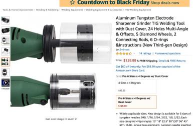

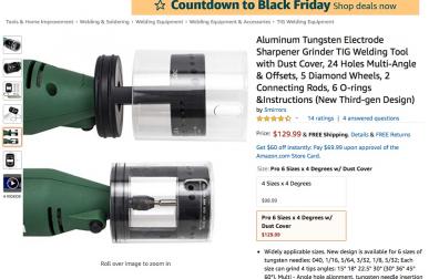

    Gee,
    I noticed further, that's there's a 3rd generation version of this thing, priced a little higher too.
    Not that I'm affiliated with, compensated by, or shilling for the seller or producer in any way.
    I'm just sharing as an enthusiastic welding market consumer/observer.

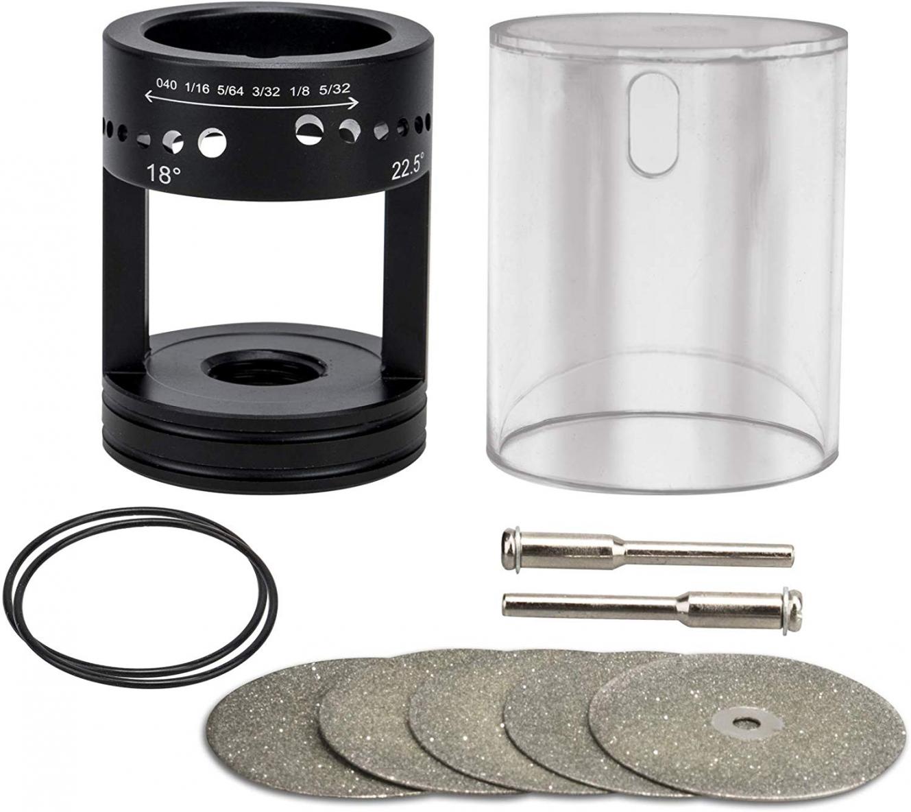

    https://www.amazon.com/dp/B07ZF8JPQ8/ref=emc_b_5_t

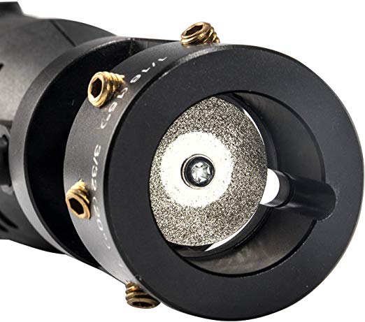

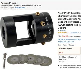

    Well,

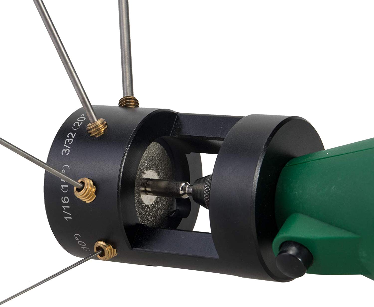

    I bought the billet or extruded "aluminum" GEN 2 tungsten grinding head that threads onto a Dremel, of which I have two, one being under-utilized, of course, which seemed to influence my decision a bit.
ID:	13916 Click image for larger version.

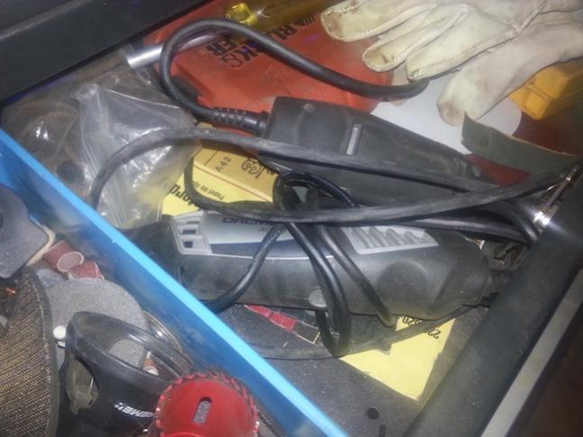

    I’ll include a pic of my current turret-head style rotary tool. It’s an OK one, but it’s ready for a new diamond wheel anyway. Maybe I’ll give it away for free to some Everlast Forum member here who doesn’t have one yet, and actually owns an Everlast TIG welding unit. See details below.
    Anyway, there was a $10-off coupon on Amazon today for this item (Black Friday?), free shipping, and no sales tax (out-of-state seller on Amazon), so the total came to $88.99.

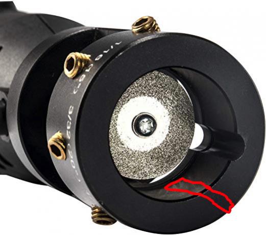

    Yeah,
    When this thing arrives, I may use a Dremel cutting wheel to cut a little channel to lay the tungsten into, like the Eastwood ones have, as a sort of catch-all slot to remove any molten blobs that suck up on a tungsten tip, rather than using the cut-off slot.
    Otherwise, you have to back out and interchange one or more of those allen screws, to have your preferred tungsten size (I'm almost exclusively using 3/32") placed in whatever particular degree angle you like. I'll probably mover that 3/32" on to the 30 degree hole. My old, turret-head had a fixed angle of about 20 degrees for all three tungsten sizes.

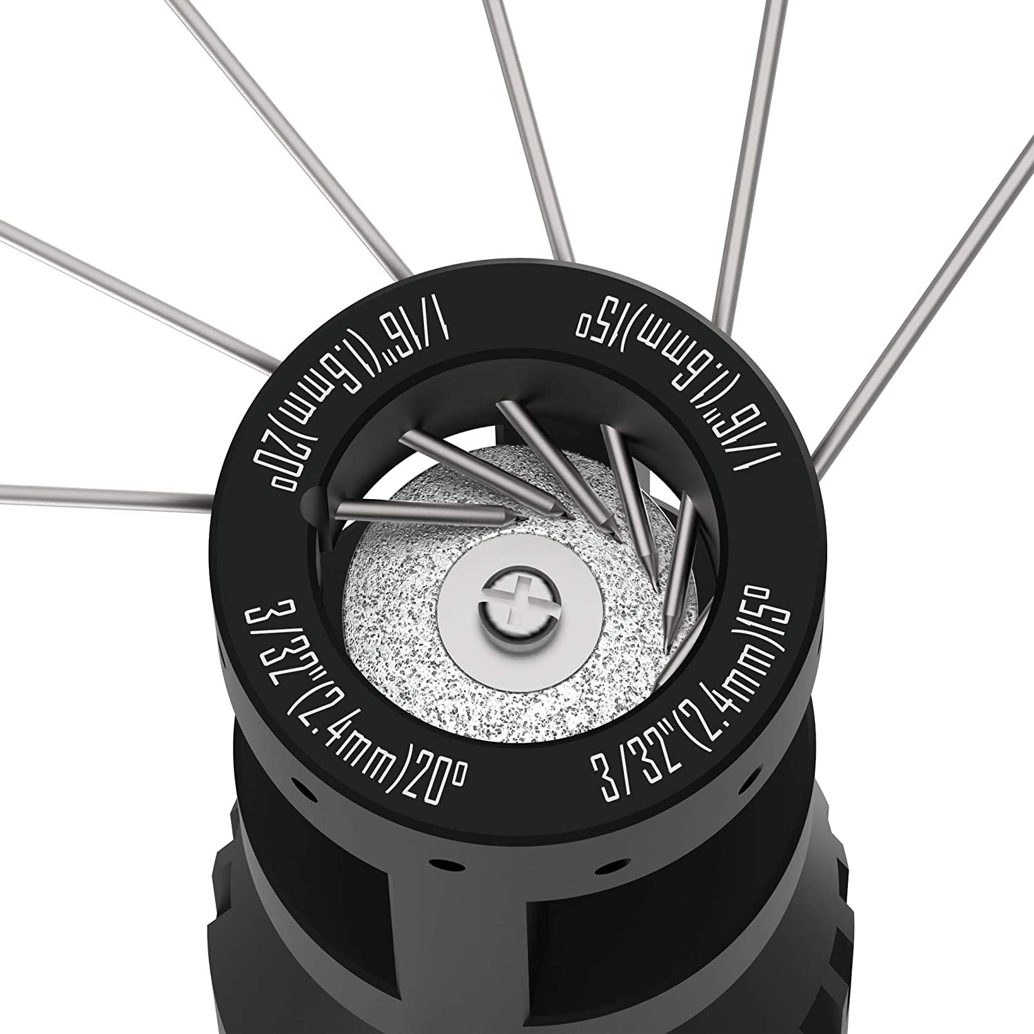

    Well,
    This thing arrived today. It works well. Screwed right on to a Dremel. The 3/32" slot is at 20 degrees, and maybe I'll just leave things as they are for a bit. The fresh new diamond disc cut fast and without much pressure, which showed how much the old unit called for a new disc.
    The diamond wheels/discs are a little bigger than the one on my old unit, so the old one will not get a new wheel.

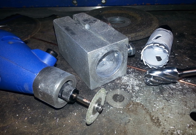

    OK,
    I got a little compulsive and found a hole saw and burr bit to ream that barrel out on the turret head a little bit so that a new, slightly larger diamond wheel/disc fits into the old tungsten grinder.
    So, my old tungsten grinder is very fit for usage now.

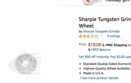

    I mean, Sharpie charges $19 just for one spare diamond wheel/disc.

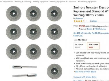

  18. Default
    Nice,
    Amazon!
    The 25mm ones.
Name:	3 Mirrors.jpg

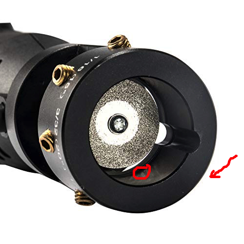

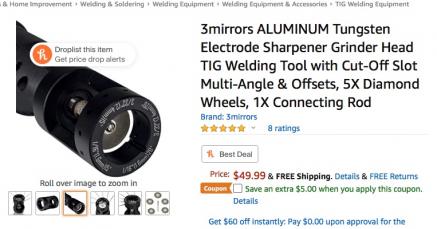

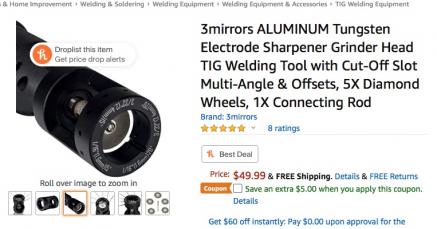

    Gee,
    These tungsten grinder heads for Dremel tools keep getting better, and cheaper ($49, free shipping, no-tax, 6061 aluminum CNC)!
    https://www.amazon.com/3mirrors-Elec...grinder&sr=8-5
    This one is only for two sizes, but allows two angles for those two sizes. I mean, I still like mine, as it has the 1/8" ability too, which I'll often use for a 3/32" tungsten, just to get the tungsten tapered down for the 3/32" slot.
    Of course, it would be an easy task to drill any of those existing hole/slots for 1/8" too.
    And, again, "Not that I'm affiliated with, compensated by, or shilling for the seller or producer in any way." Inadvertently, maybe, I suppose.
    So, more choices and better prices for TIG welding customers is a MARKET VICTORY!
