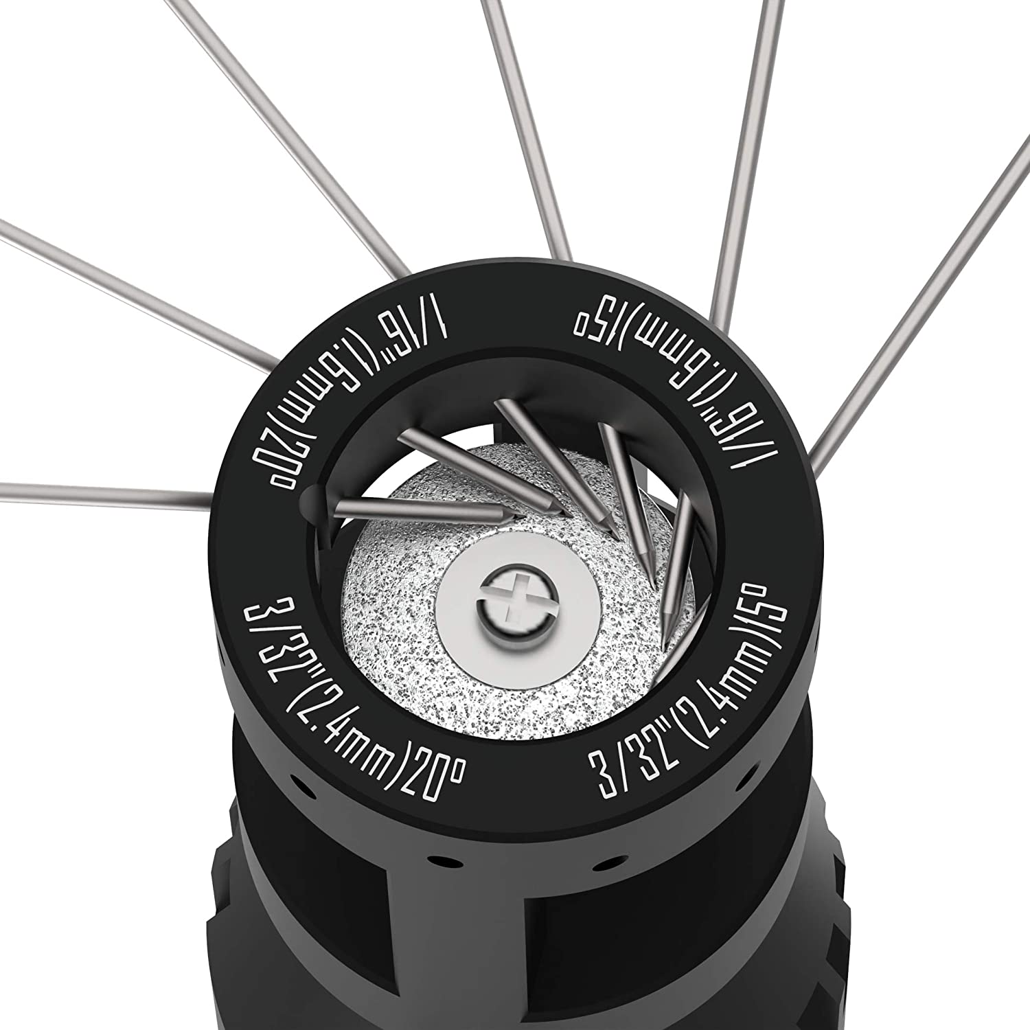

    Gee,
    I noticed further, that's there's a 3rd generation version of this thing, priced a little higher too.
    Not that I'm affiliated with, compensated by, or shilling for the seller or producer in any way.
    I'm just sharing as an enthusiastic welding market consumer/observer.

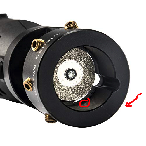

    Yeah,
    When this thing arrives, I may use a Dremel cutting wheel to cut a little channel to lay the tungsten into, like the Eastwood ones have, as a sort of catch-all slot to remove any molten blobs that suck up on a tungsten tip, rather than using the cut-off slot.
    Otherwise, you have to back out and interchange one or more of those allen screws, to have your preferred tungsten size (I'm almost exclusively using 3/32") placed in whatever particular degree angle you like. I'll probably mover that 3/32" on to the 30 degree hole. My old, turret-head had a fixed angle of about 20 degrees for all three tungsten sizes.

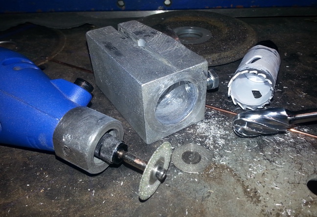

    OK,
    I got a little compulsive and found a hole saw and burr bit to ream that barrel out on the turret head a little bit so that a new, slightly larger diamond wheel/disc fits into the old tungsten grinder.
    So, my old tungsten grinder is very fit for usage now.
    Why did I buy a new one again? Ha, ha, ha...
    Anyway, I'll send it along when you forward a shipping address to me, ProMetal. You're going to like it even more now!

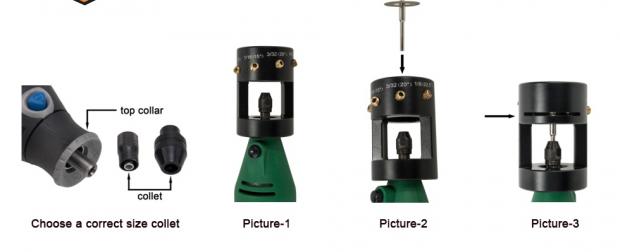

    Gee,
    These tungsten grinder heads for Dremel tools keep getting better, and cheaper ($49, free shipping, no-tax, 6061 aluminum CNC)!
    https://www.amazon.com/3mirrors-Elec...grinder&sr=8-5
    This one is only for two sizes, but allows two angles for those two sizes. I mean, I still like mine, as it has the 1/8" ability too, which I'll often use for a 3/32" tungsten, just to get the tungsten tapered down for the 3/32" slot.
    Of course, it would be an easy task to drill any of those existing hole/slots for 1/8" too.
    And, again, "Not that I'm affiliated with, compensated by, or shilling for the seller or producer in any way." Inadvertently, maybe, I suppose.
    So, more choices and better prices for TIG welding customers is a MARKET VICTORY!
