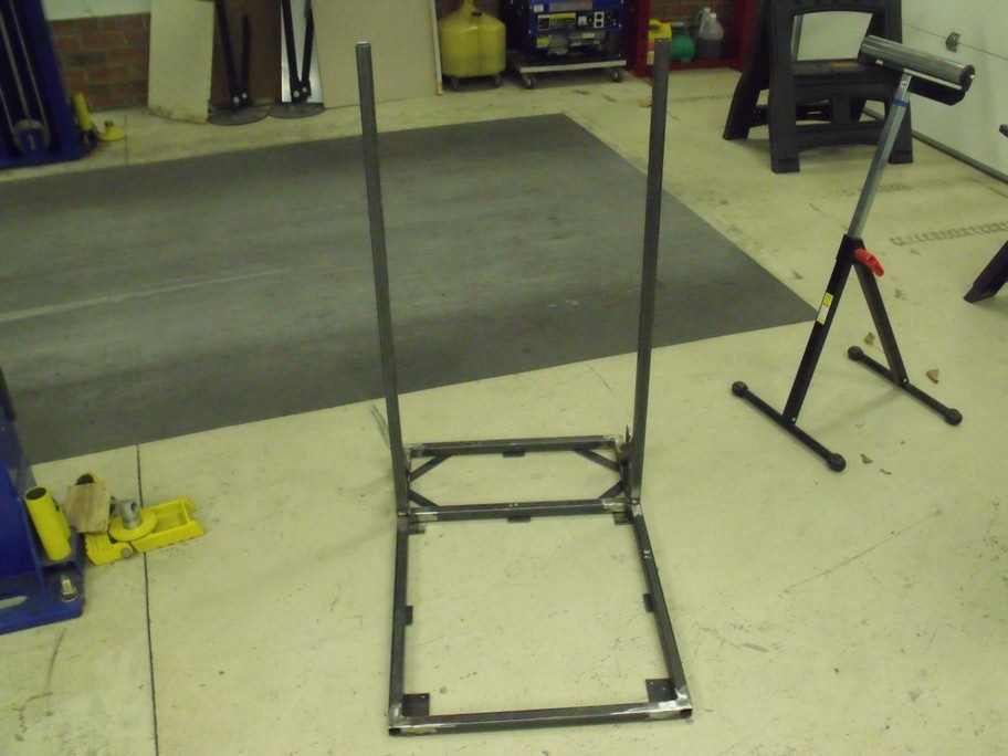

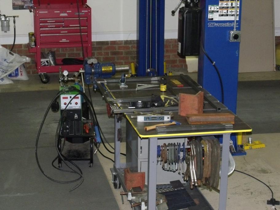

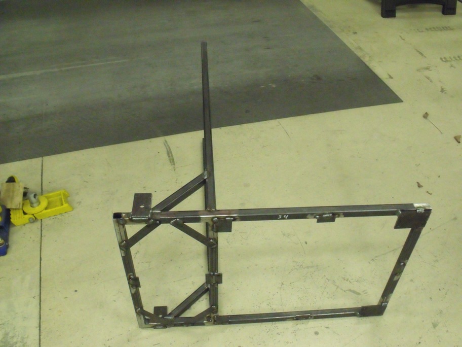

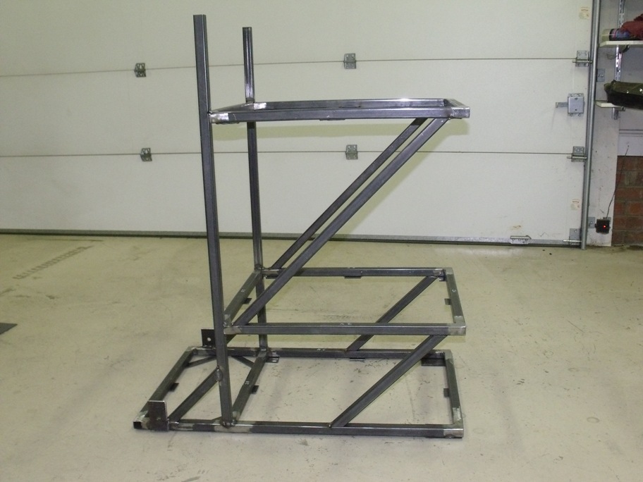

    This is the start of my welding cart, It will have three shelves. The bottom for storage, or maybe a drawer. the middle will hold my Mitec plasma cutter and a future W300 water cooler and the top will hold me 250ex tig and I-Mig 200, there is room for two bottles of any size I may need. I will be adding holders for my cables, peddle and filler rod.
    Pic # 1 is the basic frame layout
    Pic # 2, 3, 4, are different views of the frame and main upright shelf tabs and attachment plates for the wheels and casters.

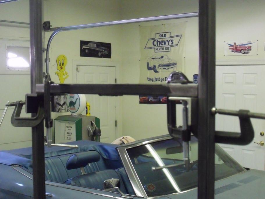

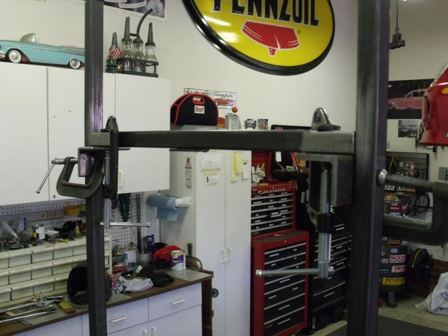

    Default Cart update pics
    Here are some pictures of my progress on the welding cart.

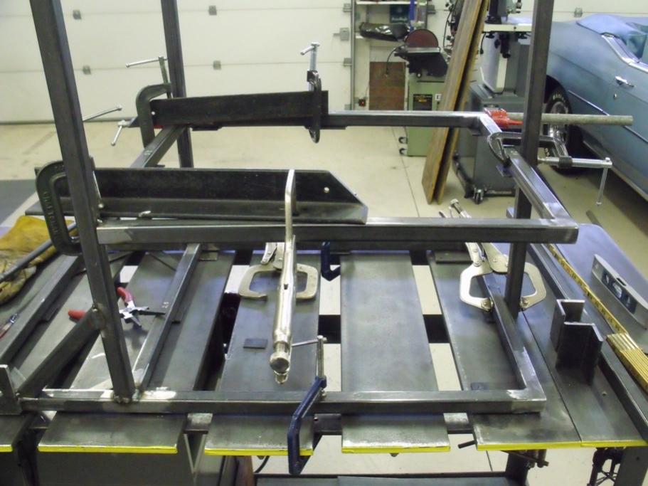

    Pics #1 & #2 setting the horizontal shelf bracket between the uprights

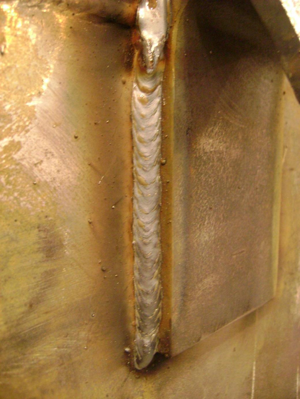

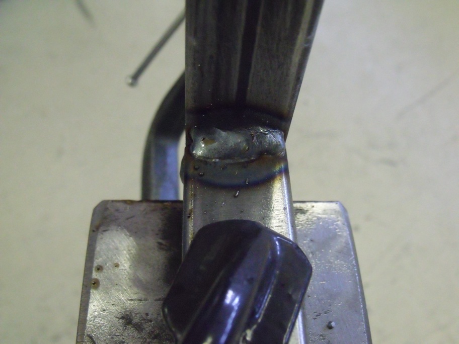

    #3 & #4 close up of two of my better welds please critique, I want to learn
    #5 & #6 Bottom shelf being fit up for welding.
    #7 Braces added to bottom shelf
    #8 Cart skeleton is ready for final welding.
    This has been a good learning experience for me please let me know the good and bad you see in the cart. I will be adding the shelves, hangers for the cables and a way to secure the tanks. Any ideas on those things would be great
    Ray I take it that you are right handed?
    You're putting too much metal / weld on. You either need to move faster, or turn down your wire speed a little. If your travel speed is acceptable or even a little slow for you, turn your voltage up. In other words the weld looks too cold.
    Here is a vertical up Mig weld I did, doesn't it look hotter than your?

    Default settings for pic below
    Shield
    It is 14 Ga tube and it was a fillet weld Settings were 18v, 215 IPM with .030 wire and 75 / 25 mix.
    Thanks for the input.
    Move faster, making your weld profile flatter, look at shield arc's weld he has ripples, and a flatter weld, that's the kinda thing/look you should try for.
