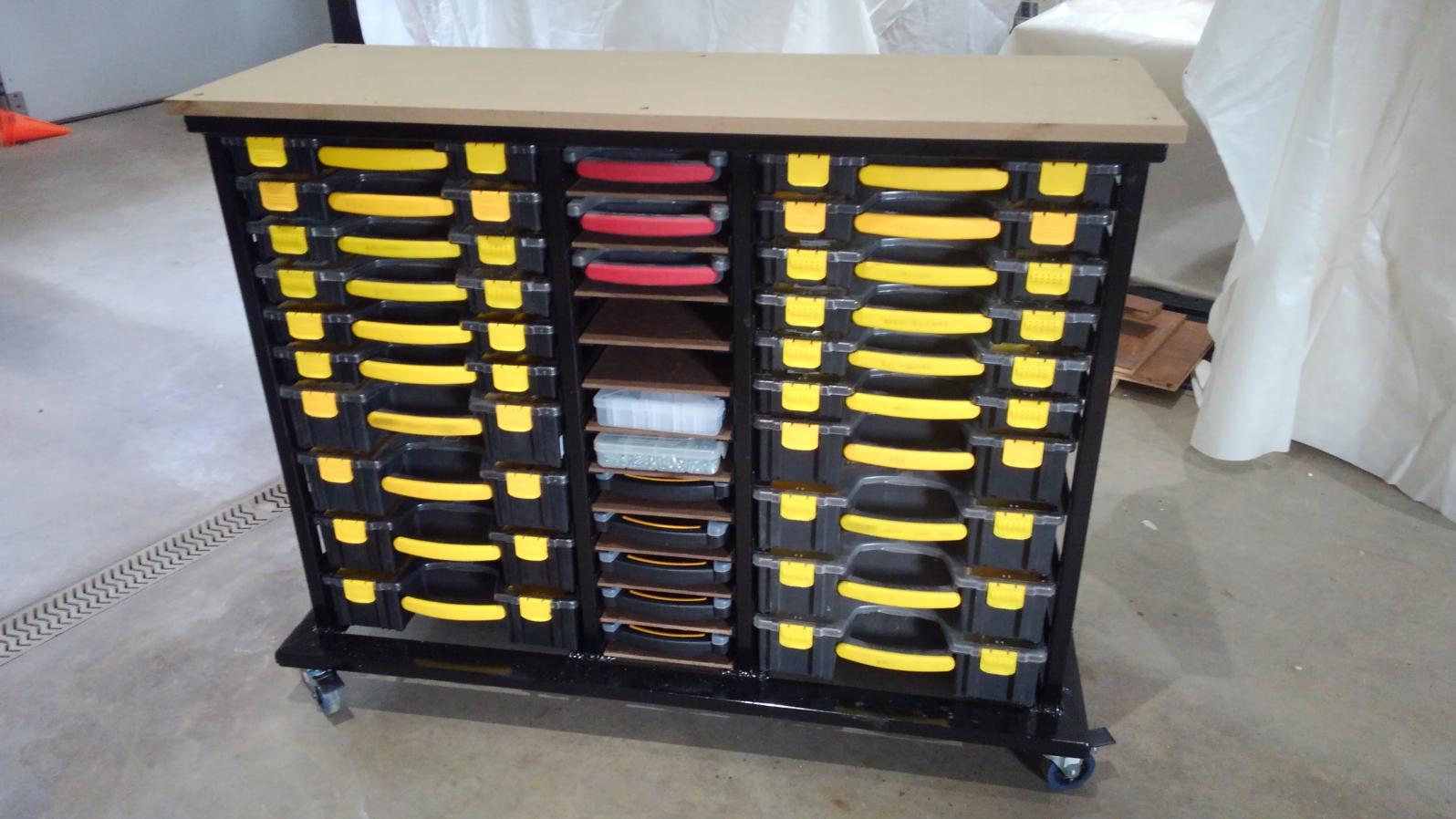

    Not exactly my first project, but the best one so far. It really cleaned up the shelves in the garage.

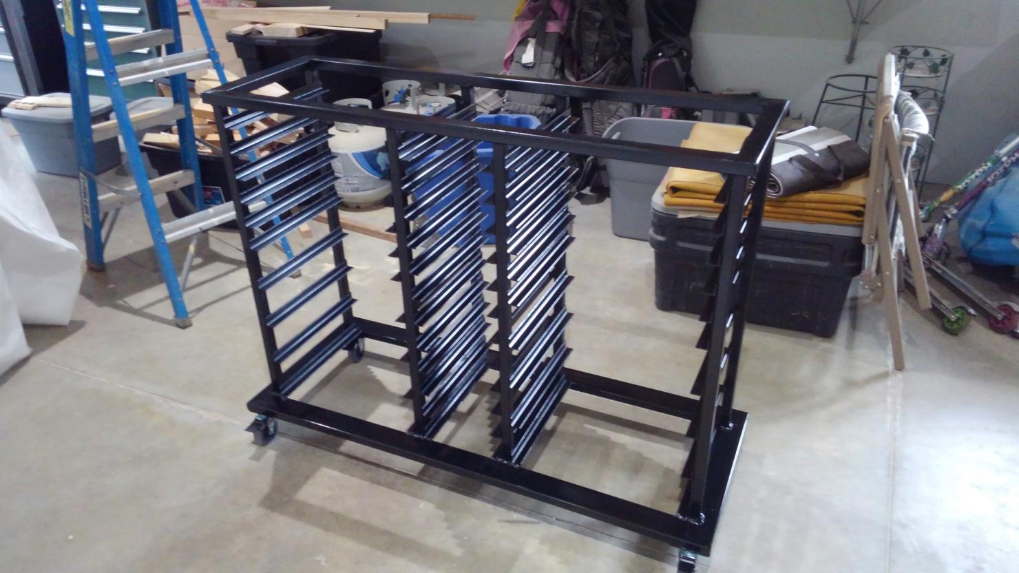

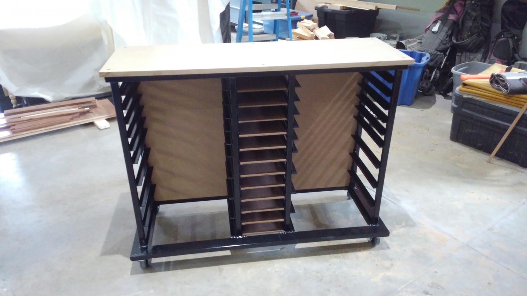

    I've got some of those containers. Now I need a rack to mount on the wall like this. I need another table like I need another welder right now. I need more space period.
    Should be simple enough to exclude the top and bottom and put a bar across the to hang on a track, or anchor to the studs. It does get heavy. everything is 1/8 wall. each "shelf" is 1x1 angle, uprights are 1x1 square. top is 1x1-1/2 rect and bottom is 1x2-1/2 rect. if you're interested in the sketchup drawing, it's all yours. I can't attach the file to this thread, but I can email it to anyone who wants it.
