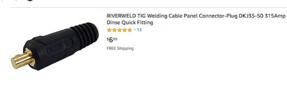

    I got my Power i-TIG 200T going.
    The negative dinse connector in the machine seems to have, "normal" fit and everything snugs up in it at around a quarter turn and locks in.
    The positive dinse connector has a much looser fit.
    Nothing starts to tighten up until past a half a turn and seems to stay, but doesn't seem very secure or locked in.
    is this normal?
    Is there that much variation in connectors or is the positive one looser than it should be?
    Gee,
    I wouldn't sweat it, as a Dinse connector of any manufacturer isn't a super-precision proposition.
    But, if you really want to cinch it up a little more snugly or earlier in the rotation, you could probably take a center punch and peen a point or two on the notched tab, to pucker the soft brass metal up a bit, which will undoubtedly make the fit tighter as it rotates and comes to its end point.
    Or, just buy some extra Dinse connectors, as they're low-cost. I usually have a couple of spares on hand for making longer Grounds (+), DCEN.
    And, the torch lead is the more critical or costly one, with the gas and hose integrated into it. But you seem to be all-good there.

    It seems to be working alright.
    I had heard that they were quarter turn fittings, but I see now after watching some videos closely, that it looks like quite a few turn farther.
    I guess I could replace the whole fitting if I needed to, but it seems to work alright.
    The negative fitting is tight, right at a quarter turn.
    that is what I was expecting.
    I get about three quarters of a turn with the positive fitting.
    I don't know if that is normal.

    The Dinse on the torch may just run up on the bumper sooner, no biggie. I mean, you could also put an O-ring on the Ground Dinse to make it cinch-up at around a quarter turn. But I wouldn't bother, as you'd undoubtedly be splitting proverbial hairs. Just start using that baby!
