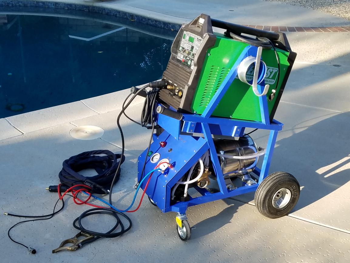

  1. Default My welding cart/water-cooler for my PowerTIG 255ext
    It's got a Procon carbonation pump (I changed the spring so it's a 50psi pump), a buzzer that warns me if the pressure drops below 40psi, and a pc-style dual fan heat exchanger.
    Man I love this welder!
    If anyone wants to know where I got parts, just ask.
    -Nic
