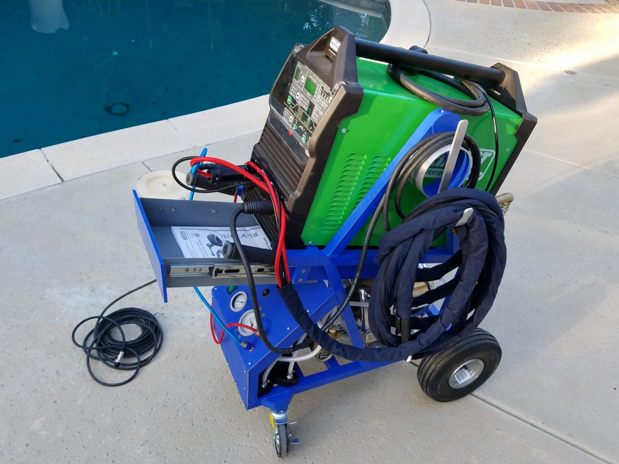

  1. Default My welding cart/water-cooler for my PowerTIG 255ext

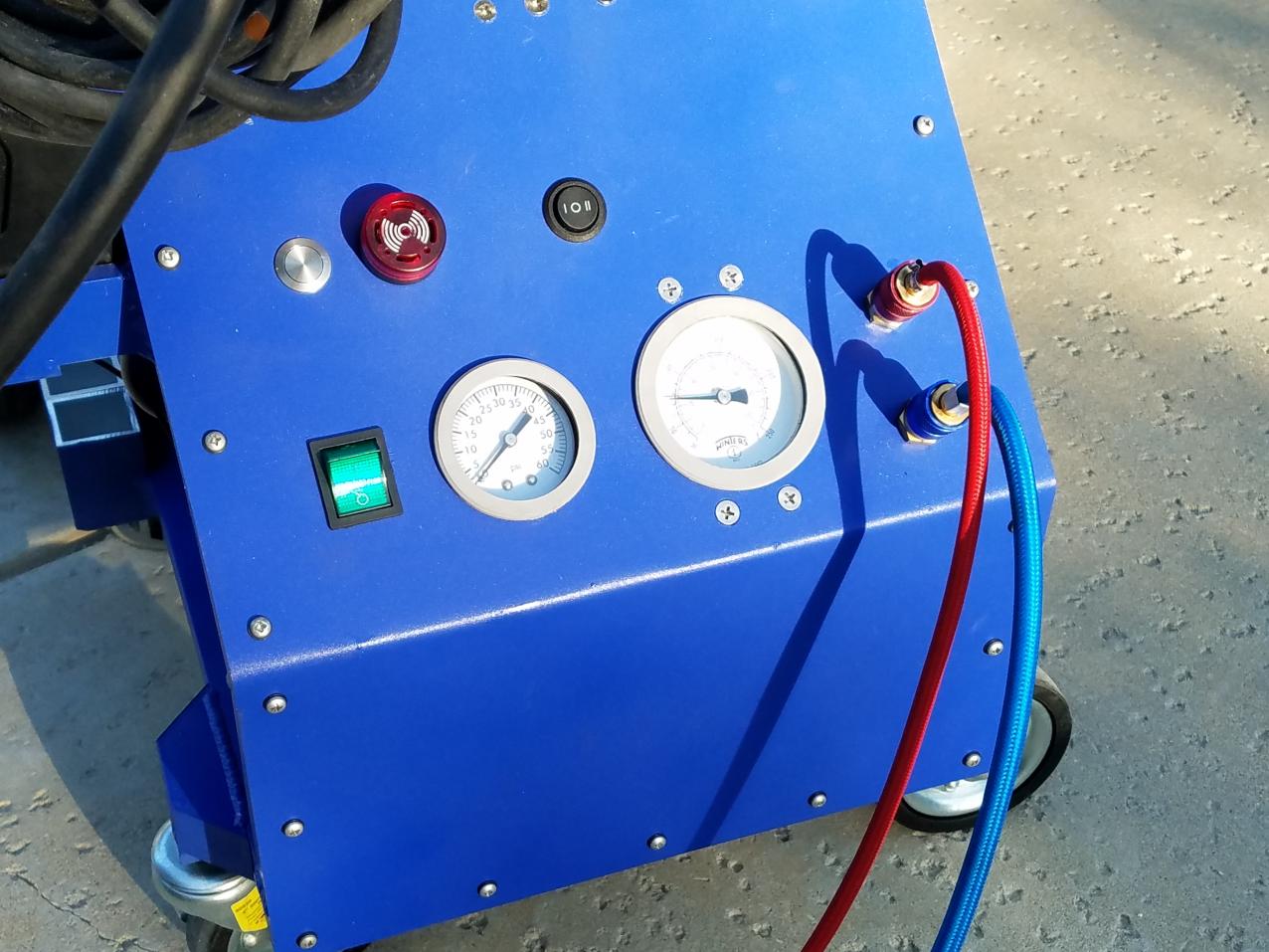

    It's got a Procon carbonation pump (I changed the spring so it's a 50psi pump), a buzzer that warns me if the pressure drops below 40psi, and a pc-style dual fan heat exchanger.
    Man I love this welder!
    If anyone wants to know where I got parts, just ask.
    -Nic

    How funny! I've been browsing around the forum and the first two welding carts I've seen are painted the exact color I chose. I guess I made the right choice!
    Nice,
    The custom-water cooler is integrated into the custom-cart.
    Very cool!
    Everlast 210 EXT (2015)
    Hey,
    If it works and does the job, nothing wrong with it. A five gallon bucket and a bag of ice and some water with a fish aquarium pump has been known to be used too. lol.
