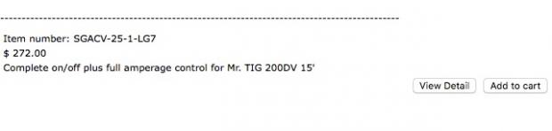

    But, I almost exclusively use a CK Worldwide SteadyGrip on my 17 torch now, even though, like most things CK Worldwide, it was pretty costly, at $272, via TIGDepot.
    And that's the only place I know of where you can get it off-the-shelf set up for an Everlast 7-pin Panasonic connector (although usawelddotcom may offer a universal set that you have to provide your connector for the proper pinout, which isn't difficult).
    Anyway, the SteadyGrip is brilliant!
    It make arc starts and finishes smooth and steady. The pistol grip often act as a perfect propping device, as the grip can be rotated to cause the torch to come to different heights. And with your hand holding the pistol grip you never have a hot torch in your hand.
    Otherwise, at TigDepot, I think you have to "add to cart" for it to show as a purchasable item, listed as a 200DV. So, contact TIGDepot directly to ensure that they are actually still available for an Everlast unit.

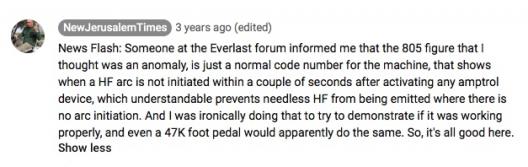

    Here's a little note from the YouTube site/thread, too:
