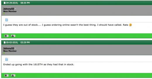

    I guess they are out of stock.... I guess ordering online wasn't the best thing. I should have called. Rats
    Ended up going with the 161STH as they had that in stock.
