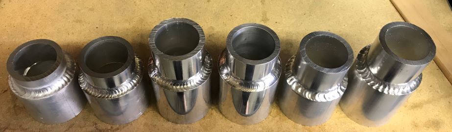

    Figured I'd start a thread showing my results with settings to get & give input as I have noticed that exact settings with experimentation and results with photos are somewhat lacking. I recently upgraded from my Lincoln Tig200 to a long awaited 255EXT as the Lincoln was limited in it's ability to adjust parameters especially pertaining to the pulse parameters.
    All of the welds have been done on a positioner with a stationary torch holder (manual) as I'm trying to dial in settings while minimizing the human element as I'm not that good with holding the torch due to a hand injury. I have notice that even the slightest adjustment in torch position has a dramatic effect on the weld bead. Positioner speed set just slightly below 1/8" per/second, material is 3/16 6061 aluminum tube. A/C balance set to 20 for all welds, 1/8" 2% Lanthenated sharpened to a point.
Name:	Pulse comparison 1.jpg
    From left to Right:
    1. 205AMPS/34% time on/15%BG (Background) amps .8PPS/250 Hertz
    2. 205AMPS/36% time on/20%BG amps/1PPS/250 Hertz
    3. 205APS/36% time on/20%BG amps/.5PPS/200 Hertz
    4. 155AMPS/40% time on/10%BG amps/1.5PPS/200Hertz (This one was slow very slow to start and was difficult to keep the puddle out ahead)
    5. 175APMS/50% time on/10&BG amps/.5PPS/200 Hertz
    6. 175AMPS/50% time on/BG amp all the way down/.3PPS/200 Hertz
    My goal was to find the best setting without wicking over the edge and to evaluate the bead appearance.(Oh how we all love a stack of dimes)
    Please comment with your opinions and suggestions and we'll see where this thread goes.

    I like #3 the best. You should have told us that you did this all by hand. Just kidding!

    4 from the left. It's filled and smooth.
    Now, why the high hertz on AC? Not really necessary. If you want to control the wicking, you should work with pulse frequency more.
    Hey Mark, thanks for the reply.
    I had the Hertz set high trying to focus the arc on the joint and keep a narrow bead. If your thinking its not needed I will dial it back and try something else. I agree with you that #4 looks the best #3 is really good too. Unfortunately, I've got something going on and cant seem to get repeated results, it's almost like I'm not getting enough amperage on any of the same settings I used to produce the welds in the pictures?
    So, if I dial back the Hertz as you suggest, do you have any other recommended adjustments to my settings? Please let me know and I will give it a shot and post up the results.

    Ultra high hertz on AC or on Pulse is just unpleasant, and the weld turns really sluggish. I like rapid wet in. When you turn up the pulse and the AC frequency, you begin to get a less progressive puddle. Now on thin material, that is good. But I like a pulse set around 90 to 100hz personally. For Pulse, no more than 150Hz is really good. 30-50% setting on balance (pulse time on) and 50 to 75% on pulse amps. That makes the most sense to me for good travel speed.

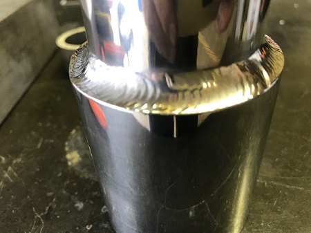

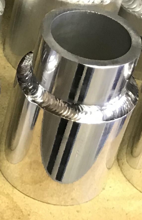

    Yes I did and got everything figured out and running like a champ! (It was more operator error than anything) I was not aware that on advanced A/C Pulse that the amps were ratio'd out as I thought the welding amps were determined by the main amperage and only the background amps were controlled by the pulse settings. So basically speaking I had too much of a spread between the settings to achieve the desired results. Took your suggestions and dialed in from there and now getting consistent results every time.
    I settled in on:
    155 AMPS, 60% pulse time on, 30% Pulse amps (background),.8 PPS at 140 Hertz and just a little slower than 1/8" P/S travel speed.Click image for larger version.
Name:	Pulse comparison 3.jpg
ID:	13803Click image for larger version.
Name:	Pulse comparison 4.jpg
    One wouldn't think that 155 amps would be enough for 3/16 aluminum but based upon travel speed that works for me to keep up with it works very well. One thing that I forget to mention in my set up is I do run 75%argon/25%helium pre-mix from my supplier and it just makes EVERYTHING with aluminum go better IMO, cost a little bit more but I think its worth it. You were spot on about the HZ, by dialing it back a bit really helped keep the puddle out ahead!
