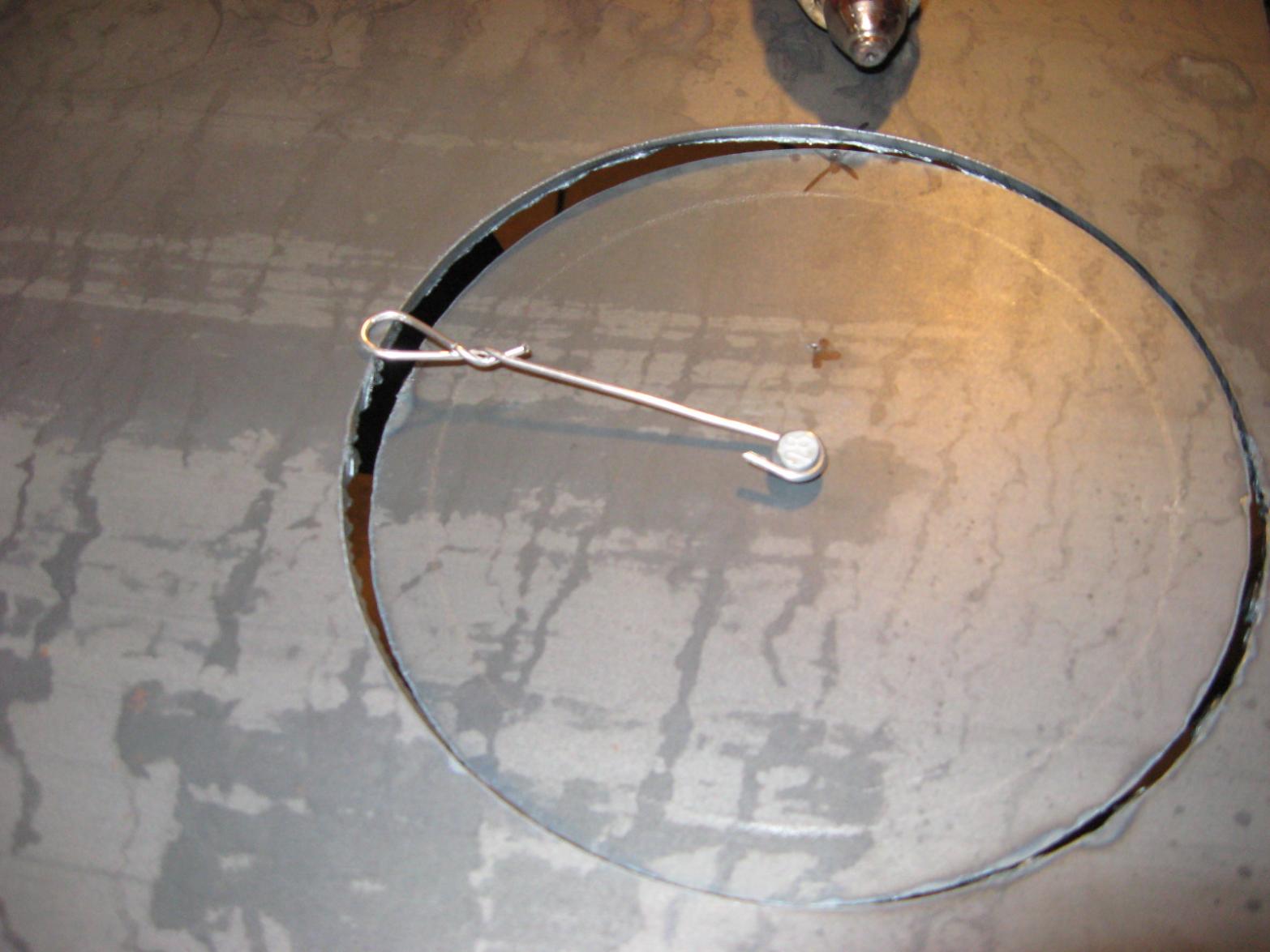

    1/16 aluminum filler works well. I make a new one every time. I have the old PT-80 torch though.
    NICE! That's the way I think.
