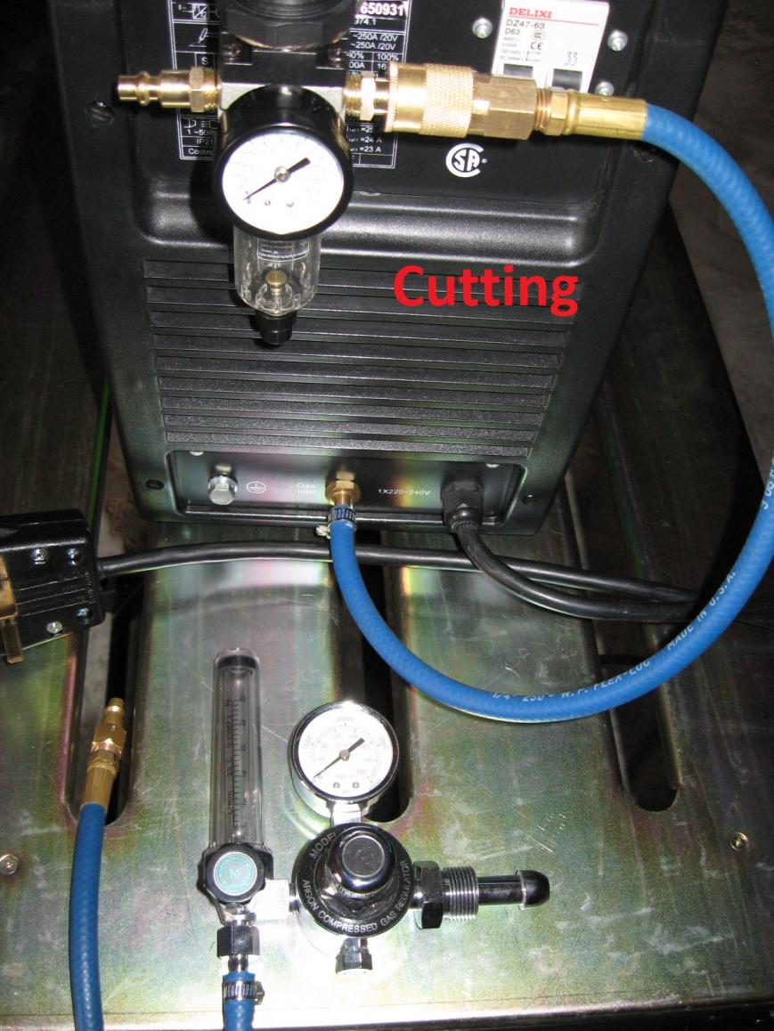

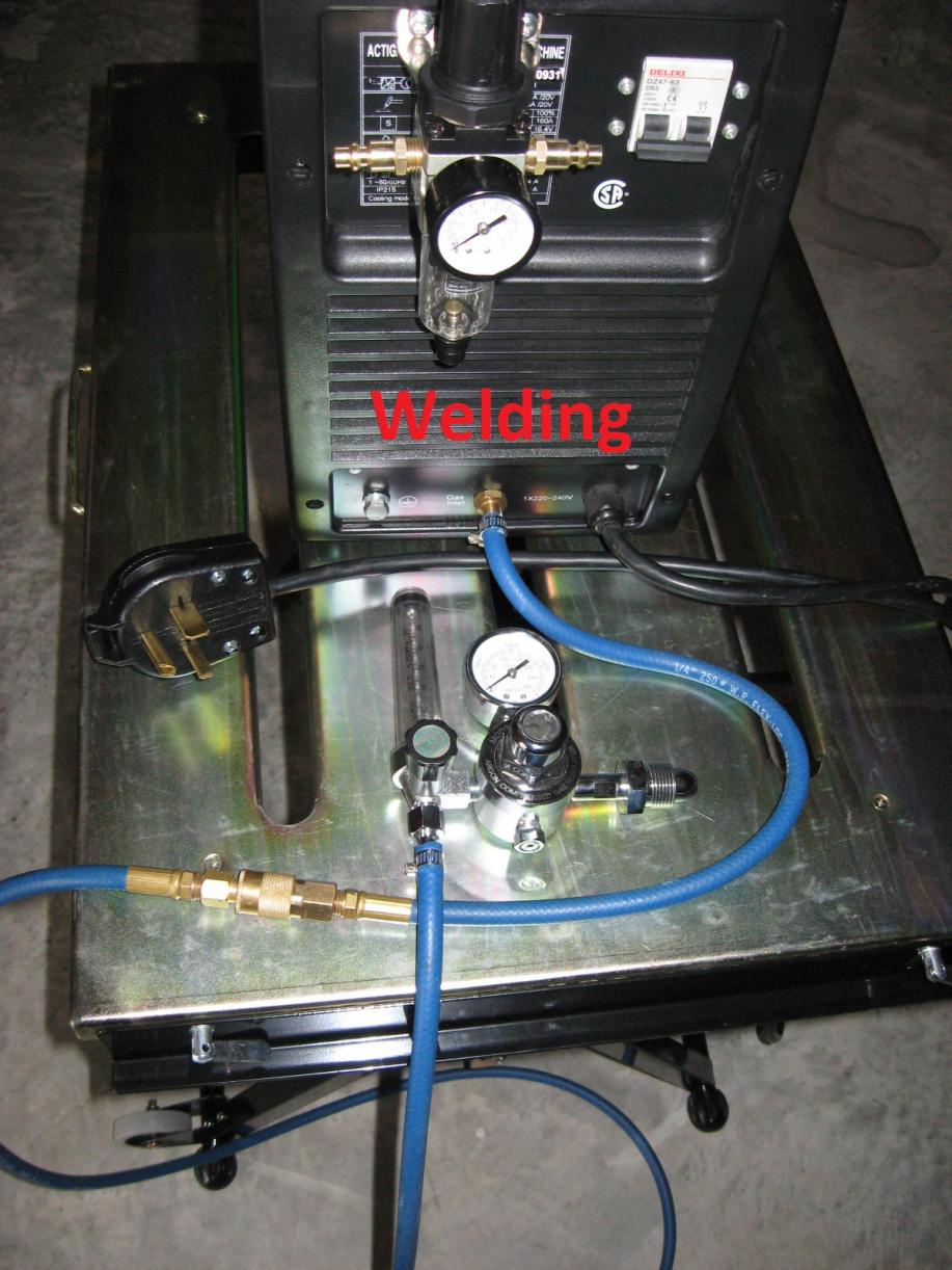

    Hello, I just received my POWERMTS 221 STI in the mail and have a few questions. What are you all using to split or T into the two different gases? Also where can I find a digital copy of the manual?
    I don't see a manual so maybe it's in the works. I use common 1/4" air line quick connects for gas. Put the male end on the machine side with about 1 foot of line and put the female ends on the lines from your bottles. I've been doing this for 7 years with no problems whatsoever. You'll also need 1/4" npt to hose barb connectors to attach them... or you can buy a cheap air line or two and cut them up like in these pics from an old tig/plasma cutter combo I had in 2011. I put the male connector on the machine side now.
