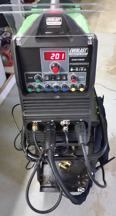

    Had to turn my cart handle upside down because it blocked the connection ports. And this machine is bigger then my mig machine was.

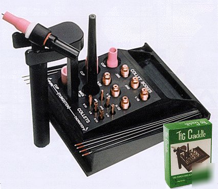

    Do you guys have a cool way to organize all your different tips and stuff?
    Big organizer or separate kits
    A few different ways. Larger quantities in a drawer, some stuff in those plastic divided boxes, and a TIG Caddie stuck on the top of one machine. Lots of different ways to do that.
