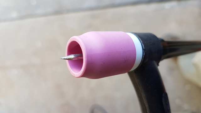

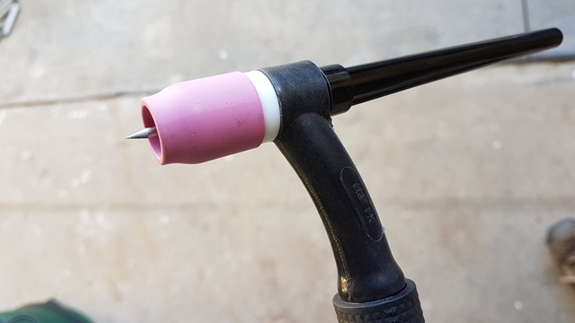

    hi everyone, i'm happy to say that the latest test was successful.
    here is the sample weld bead..
    here is #17 torch before welding showing the stick-out
    #17 torch after welding. looks clean, no balling up
    #9 torch before welding
    #9 torch after welding
    looks like the galvanized aspect is the issue after the pure argon issue.
    thanks everyone for your inputs.
    onwards to weekend, i will try the AC on aluminum and stainless steel. because i have projects as well involving these two metals. in fact, i will be needing one distinct feature of the 255ext which is the spot weld. how good can it be in stainless steel? i have to spot weld solid stainless steel rods to each other at certain bends. i will post that project once i've finished it. it won't be soon though.
    anyway, i'll update this thread again for the weekend testing on aluminum and stainless steel....
    thanks again.

    Nice,
    That bead-on-plate looks great now!
    The proverbial planets are in alignment...
