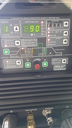

    Otherwise, take some photos of your front panel and post them here. Maybe we can spot something obvious setting misshap, like it being set to 4T, or something.

    i'll post some photos of the panel later so you can see the settings. but i can tell you that i've checked everything. did i not mention that i also used the DC EASY SETUP? the likelyhood that you can go wrong with it is slim, in terms of settings, right?

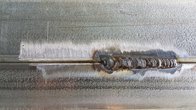

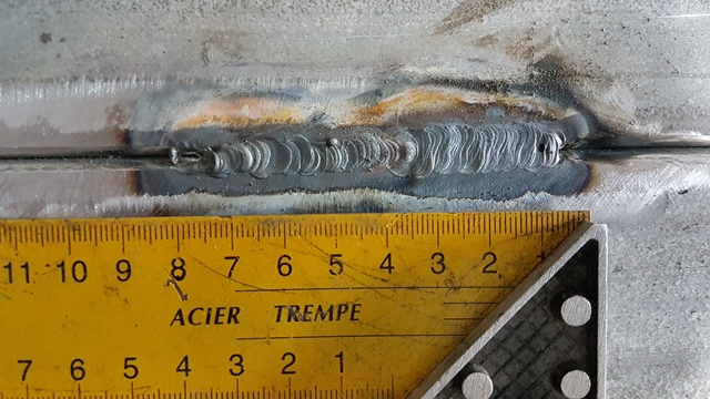

    How about a picture of the weld? Does it sound right when welding or is there noise like on AC? Is this the same bottle of argon you have used with your other welder? The tungsten looks like it's getting contamination from somewhere.

    hi rambozo, not sure about the sound. i don't konw about an AC sound because i haven't welded in AC. i haven't used 255ext in AC. yes, it's the same bottle of argon 5/2 i've used with my cigweld. but i haven't used pure argon with my cigweld because it doesn't in AC. and right now, i'm just welding mild steel with argon 5/2. it has no problem with cigweld 175i+. the other thing is my weld with 255ext is not as good with my cigweld. because my tungsten with 255ext is flaring up at least a bit which i don't get with my cigweld.
    ok, before we go further with many variables, may i ask, what could really be the usual reason for the tungsten to ball up? from what i've read, and what i've watched in youtube with the best welders around, usually when you are in AC with the wrong direction of flow or when you wrongly connected your torch and work clamp. anything else obvious which can directly contribute to balling up of the tungsten?
    i've attached here my welding photo from 255ext and from cigweld. i can not brag about my welding skills but based on my cigweld weld sample, you can really see here that i'm struggling with the way my 255ext is behaving.

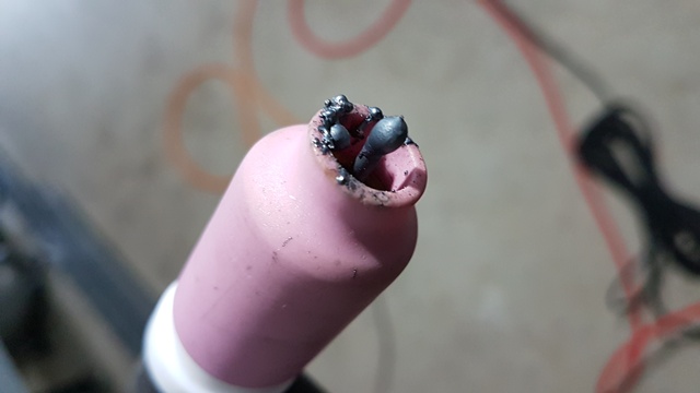

    mark,
    i've rushed home. bought pure argon. the guy in the store even double checked with me if i want pure argon and asked me if i'm going to weld aluminum or stainless steel. confirmed. i went home and put the 255ext on DC EASY SETUP. same thing happened. the only difference this time is that the weld looks cleaner (not great, that's on me). as you can see in the photo, on the 7th cm, i had a bad flare up and the tungsten balled up again. photo posted here as well. somehow i'm i'm struggling to make beads. but that's another story and it's me. thought i can tell you, i can weld better using the cigweld. i'm struggling with the 255ext. again, that's not the main issue here. btw, during that 7cm of welding or so, i was experiencing flare up, little ones, until it culminated to a big one and the tungsten balled up.
    so now i've used pure argon in DC EASY SETUP and the tungsten balled up just the same. what's could be my next step/move? i'm beginning to think if i really have a lemon.
    i really appreciate input from anyone.

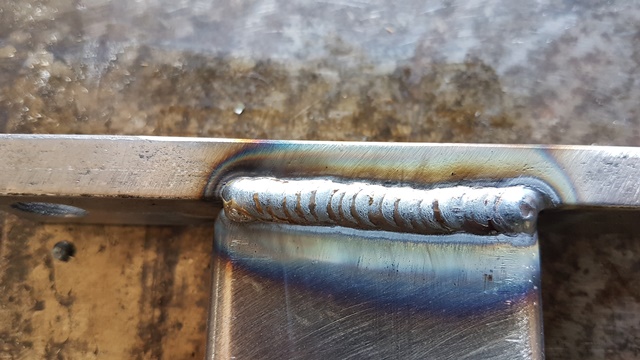

  20. Default
    Gee,
    That's not the tungsten balling up.
    It looks like you've dipped your tungsten in the puddle. That's the molten metal jumping onto the tungsten. When you do that, it's time to regrind all of that off, every time that happens. Get a nice taper with a longitudinal grind on it. Keep a close arc, but without touching the puddle.
    If you don't keep the tungsten free from dipping metal, it can/will often spit back particles into the puddle and make more mess.
    Additionally, it looks like you're welding on galvanized. And even though it looks like you've ground off the strand to be welded, nearby galvanized/zinc coating has a tendency of contamination jumping up on the tungsten and making a mess. I mean, you can join galvanized stuff, but it can be more messy, and the fumes are toxic too.
    What's your Argon flow rate? 15 CFH or 7 Liters for about 100 amps is a place to start.
    That cup size looks a little small, or is that just a larger style gas lens?
    Try some nice cold-rolled steel or hot-rolled steel with the mill scale ground off of it, so that what you're TIG welding is bright, clean metal alone.
