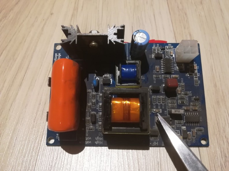

    I bouht my tig 2012 or 2013 if i remember right. So my 210 ext model have two knops, so it is the pre version and it have hidden menu.. i have try to change the settings and nothing works. My tig do not have any point/tips what i can clean or adjust (like old cars have on ignition systems)��. I took a picture from that litle board, and i pointed the component where the litle green light turns on.

    Or if this machine have point what i can fix or adjust, i can not find it. :-)

    First thing I would try is to clean that board with circuit cleaner. Because there is high voltage present, if any of that dust on there is carbon, there could be voltage tracking going on and leaking your HF to ground through the dust.

    It's obviously gapless. And I see it does have a tiny LED.
    Otherwise, below is a thread link that talks about how that model has a lot of adjustability in the HF arc starts, regarding duration, frequency, and amps.
    I don't know what the procedure for involking those codes and hidden menu is, but I'm sure it's something simple, like holding down two knobs at the same time for 5 seconds, or something like that. It doesn't mention the procedure. Maybe you have the manual which does say how to do it, though. Or, someone on the forum may know.
    https://www.everlastgenerators.com/f...verlast+210EXT
    So, that's what I'd do first; maybe increase the HF time a bit, try changing the HF Hz a bit, and maybe maybe increase the start amps a little (on my 2015 model that is a setting on the panel itself).
    Please let us all know how it goes and if there's any improvement. Otherwise, maybe Mark, with Everlast, knows if those daughterboards are still available and what it might take to get one moving in your direction.

    I found loose solders from the litle board, I soldered them again and I removed all the dust and metal out and sprayed the new lacquer on the surface . It didnt work. I know where is the hidden menu and i have try to adjust from there and it wont do anything.
    I also noticed today when i was testin on ac that it wont get arc if i scrach a workpiece(i will get small arc and it will die after 1-3 sec), i have to do that three or four times and then i will get arc. On dc this wont hapend.
