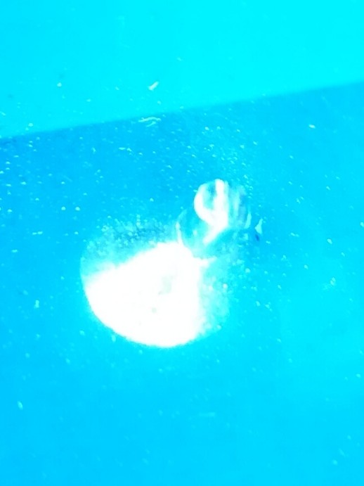

    Do you see a light (LED) or an arc inside? The buzzing means there is an arc inside. It shouldn't be green, unless contaminated.
    Your tungsten could be bad, or contaminated. That will stop an arc. If you touch the tungsten to the metal before you try to start the arc then try to start the arc, you might need some cleaning on the points, or the gap may not be just right, and sometimes they just do that, with any brand. But if you have to lift or scratch start it to get the arc going, that is not normal. May need a point gap adjustment, or may have a board issue on the points.

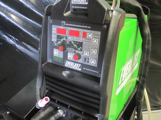

    Here's a pic of the pre-2015 (two knob) model:

    I bouht my tig 2012 or 2013 if i remember right. So my 210 ext model have two knops, so it is the pre version and it have hidden menu.. i have try to change the settings and nothing works. My tig do not have any point/tips what i can clean or adjust (like old cars have on ignition systems)��. I took a picture from that litle board, and i pointed the component where the litle green light turns on.

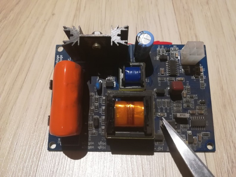

    First thing I would try is to clean that board with circuit cleaner. Because there is high voltage present, if any of that dust on there is carbon, there could be voltage tracking going on and leaking your HF to ground through the dust.

    It's obviously gapless. And I see it does have a tiny LED.
    Otherwise, below is a thread link that talks about how that model has a lot of adjustability in the HF arc starts, regarding duration, frequency, and amps.
    I don't know what the procedure for involking those codes and hidden menu is, but I'm sure it's something simple, like holding down two knobs at the same time for 5 seconds, or something like that. It doesn't mention the procedure. Maybe you have the manual which does say how to do it, though. Or, someone on the forum may know.

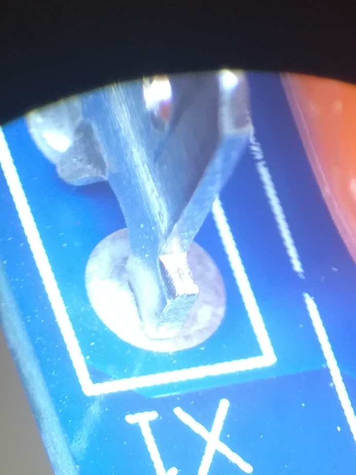

    I examined little bit more..
    I found loose solders from the litle board, I soldered them again and I removed all the dust and metal out and sprayed the new lacquer on the surface . It didnt work. I know where is the hidden menu and i have try to adjust from there and it wont do anything.
    I also noticed today when i was testin on ac that it wont get arc if i scrach a workpiece(i will get small arc and it will die after 1-3 sec), i have to do that three or four times and then i will get arc. On dc this wont hapend.
    I also changed the ground cable.

    If you are having issues with that unit, there's not much to do except replace the whole board.

    Nothing short of a new board will fix it. We've been there done that with that model...main reason we switched production.
    Did you Mark mean only the small board? Or also the main board. I asked today from finish everlast suplier do they have the board to me. Now i am waiting their answer.

    I received a used board. Now the machine works. Jes
