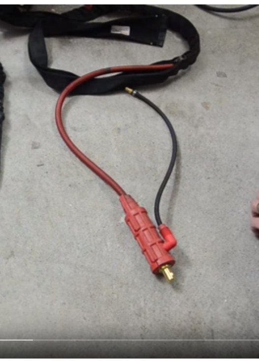

    hello everyone,
    i just joined in the forum and i just bought PowerTIG 255 EXT last dec. i haven't used it yet actually. i want to buy a couple of tig torches which are light and very flexible. the torches that came with the unit are bulky and rigid and heavy for me. though they have flex head, i still want similar to this
    http://weldfabulous.com/ck-ck1512hsf...ece-superflex/
    or this
    https://www.arc-zone.com/flexible-to...g-ck1512hsf-fx
    now, i have a few questions. i understand i need to buy male dinse connector that would fit the female DINSE 35-70mm² of my 255ext. and that dinse connector should have a gas outlet connector where i can connect the gas tube that will connect to gas outlet 9mm quick connect of the 255ext?
    i've attached some photos i screen captured from youtube (pithy bike's channel) to clearly show what i mean.
    1. what exactly are the correct flexible torches i can buy? for now i'm not going to weld anything more than 150amps i guess.
    2. where can i buy the dinse connector where i can connect the flexible torch and which has the gas outlet i can connect to 9mm quick connect of the 255ext.
    i have a lot of other questions but this is all for now.
    thanks in advanced for any help and guidance you can give to newbie like me.
    joe

    If you want to piece-it-out with CK Worldwide stuff, the individual Safe Loc Dinse connector with the Quick Connect for most Everlast TIG units is CK SL2-35QD, priced at around $57, which would work great with a 17 torch and hose/power cable.
    https://www.amazon.com/CK-SL2-35QD-S...35qd+safe+lock
    But, more recently, Everlast now has their own Ultra Flex hose and torch assemblies with the Dinse connector built-in, so there's no added cost for it, but then it is never really detachable, which seems OK.
    I mean, while you're in the TIG torch assembly market, I'd consider the Everlast Rota-Flex TIG torch head/assembly too, which is similar to CK Worldwide's Flex-Loc but is more costly to obtain than the Everlast.
    So, it's a one-stop affair with Everlast for the Rota-Flex with their Ultra Flexie cable with the Dinse and the right quick connect gas fitting, without the gas connector being adapted from a compression fitting as CK Worldwide does it. And it's $149, out-the-door for the 12.5'.
    https://www.everlastgenerators.com/p...-35-type-dinse

    Basic torch numbering is/was standardized across different brands, but there are some exceptions.
    The big differences are the different hardware that each torch uses. There are two major versions of hardware and a few specialty versions. They use different size threads so they do not interchange.
    The small hardware is shared on the 9 series gas cooled torch and the 20 series water cooled torch.
    The large hardware is used on the 17 and 26 gas cooled, and the 18 water cooled.
    There is also a special stubby version that basically uses the small hardware size on the large series torches.
    The cables use standard connectors, but will be different sizes rated for different current. Same with the torches and hardware, they will all have a current limit and you should not exceed the maximum rating of any of the parts. For example the stubby hardware will lower the rating of your torch somewhat. So while you could put a 26 torch on in place of a 17, the cable that came with the 17 will not handle the current that the 26 torch can use. So while you can mix and match, you have to be aware of what the weak link is and not exceed the lowest rating of your combination. In practice the brand make more difference in torch sizes. CK has 17 and 26 torches that are practically the same size. But the cables are different to accommodate the different current limits of each torch. So if you wanted to use only one cable, make it a 26 and you could swap a 9 or 17 torch with no worries about overloading the cable. It would just not be as flexible as it could be for a small 9 torch. It all depends on what your priorities are. My advise is to use what comes with the machine for a while. See what type of work you do and you will have a better idea of what you need in terms of size, current, and cable length.
    Yeah,
    The one CK Worldwide Safe Loc Dinse clamshell will not fit both 17 and 26 hose/cables, or their water-cooled equivalents. So CK has got you for over a $100 just for two connectors on a 17 and a 26 torch, if you have both, as I do. Everlast torch assemblies don't have that separation or added cost, even though the separation can have some advantages.
    The SL8 will work for a 26 TIG torch and hose. The SL2 will work for a 9/17 TIG torch and hose. The 35 suffix designates the 1/2" Dinse (a 25 denotes 3/8"), which is what Everlast has on the 255EXT, and the QD designates the 9mm quick-disconnect which the Everlast also uses.
    I don't notice a CK SL8 Safe Loc model that denotes the "QD", so I'd buy a barbed 9mm quick-disconnect fitting and some Oetiker clamps, which are a more elegant solution than how CK uses a compression fitting with a QD 9mm adapter on their SL2-35QD for the 9/17 torches. Everlast sells the 9mm fittings. I mean, that's what I did, even on a SL2-35QD I have, since I wanted to shorten the small gas line to the Safe Loc anyway.

    thanks a lot for that rambozo. very clear and helpful specially for a newbie like me.
    also, i found this in the CK website. one just needs to look around. but also it's better to ask as well when you really can't find what you're looking for.
    http://www.ckworldwide.com/dinse-gas-cooled.html
    this tells which torch goes with which dinse. i want to order a couple and i don't want to make a mistake because shipping from US to australia takes time and costly as well.
