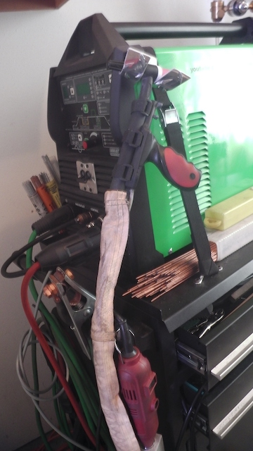

    I use a pigskin cover on my main torch, as it is easy for the hose alone to touch some hot metal and have a problem real quick. I mean, the ultra flex hose material is silicone, so it may be almost impervious to heat, but I wouldn't bet on it.

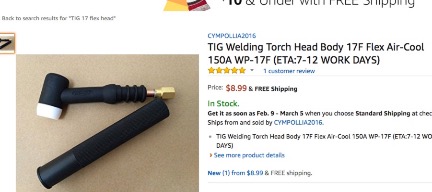

    No, the more cost-effective way, and pretty fast way too, to switch from a 9 to a 17 torch is just to get a cheap torch head (non-CK, without the added hose assembly), and swap it onto the one hose assembly and Dinse. Also, Everlast-Australia undoubtedly sells a torch/hose/assembly with the Dinse and gas quick-connect built-into the hose assembly.
    Here's a 17 flex head torch for $8.99, delivered, tax-free, to the North American continent. I find flex head torches like these to be just as good as the CK stuff, which cost a lot more, needlessly.

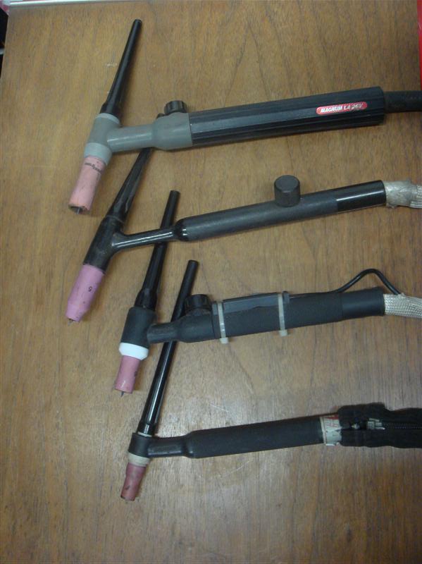

    If you use the stubby hardware on the 17, there is very little difference between that and a 9. So you can probably just skip the 9 all together. You can see the difference in sizes here. From top to bottom:
    A 26
    A 17 with large hardware.
    A 17 with stubby hardware.
    A 9 (actually a 20 but those two are the same size)
    As you can tell the different brands of torch have an impact on size, too.
    Lincoln, ???, Everlast, Weldcraft.
    A 26
    hi rambozo, based on the photo you put in here, i can see that 9 is definitely smaller than 17. yeah, i'm sure i can survive with 17 alone and from whatever i've read and watched in youtube, a lot of people, even the best of the best in tig are attesting to the fact that they too have the the 17 as their go-to torch. still, i'd want to have a 9 just in case i will need it. besides, i have a feeling i might be using it more than the 17 with the kind of projects that i'll be having. i'm a small person with small hands (yeah...unfortunate as it maybe..hahaha), so i'm sure i'll benefit with the smallest of torch which can do what i want within the amperage that i need.
    also, i'd rather order it together with 17 because i'm paying the same shipping anyway. i don't want to regret and order it later and pay another shipping cost. i'm only a hobbyist, yes. but this is my only hobby (and vice) so i want to pamper myself by having want i want. have you had that feeling when you want something and even though you know you can survive without it but you still want to have it? that's my feeling with the 9..and the 17 with flex cables.
    but thanks for pointing out to me what you have pointed out.
