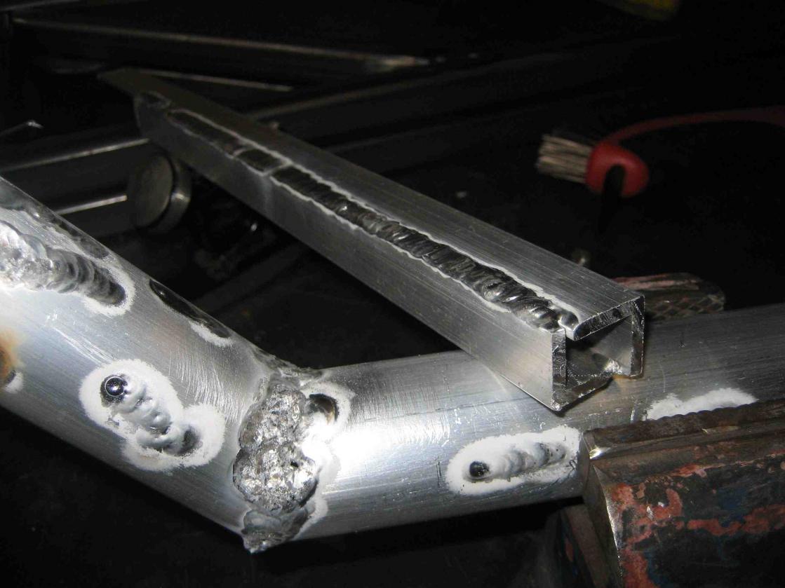

    Making some progress with my new unit on Aluminum. The two angle pieces welded together seem to be much easier to weld than two pieces of flat stock or tubing butted up to each other. The problem I am having with the butt welds is as soon as the aluminum starts to melt it does not pour over and melt into the aluminum edge next to it but both pieces melt and seperate before I can get in there with the rod to join them up. I am making some progress but could use some advise please. I realize that the welds shown in the tubing picture show contamination issues etc but thought I would show the two pieces I was working on this evening to show what is working and what is not. Any tips on these butt welds....my butt welds look like fido's butt!

    Thanks in advance....wayne

    Wayne,
    You must push your tungsten closer to the metal, about as close as you can get without touching, about the thickness of a credit card. Then you need to work the torch back and forth across the seam, not just directly in the center, pulling the weld toward each other. If you need more agitation, increase the AC freq. As the parent metal melts, add a drop of filler into the puddle.
    That is thick tubing you have, you'll need to put more amps into it or bevel your tubing into a V at the joint.
    You need to turn down your cleaning action. The cleaning area is too wide, and it is reducing your effective penetration.
