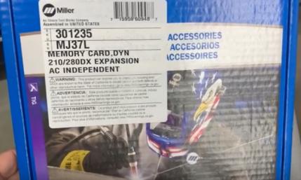

    Anyway, the Red and Blue crowd (which includes moderators too), seemed bothered by my pointing out that the AC Amplitude Control feature on a Miller Dynasty 210/280 DX models only comes as an optional upgrade via an SD card, and costs about $500. And they didn’t like that I’d also point out that you could get three (3) comparably equipped and featured Everlast EXT units as you could with a Dynasty DX model. So, I was ultimately scapegoated, even though my sensible assertions and observations were tolerated for a while.
    Look how big the box is, for something that is the size of a Quarter. Ha, ha, ha...
Name:	Miller AC OFFSET Cha-Ching.jpg
    But I really hate how Miller Electric cripples those two Dynasty models just so they can create a State-patentable line of computer code on a 50 cent piece of plastic, in order to charge an extra $500 for a “proprietary” and “patentable” function. I mean, as a pro-Market, Anarcho-capitalist, I hate to see companies exploiting customers that way, by running to the State for a patent and quasi-monopoly that way. Patents are a State-invention that stifles innovation and bilks consumers. Patents came from so-called Monarchs and the Mercantilists of Old England, and they rely on the coercion of involuntary taxpayers to enforce them, which is another telltale sign that they’re bad for most people. Of course, use of patented stuff can also elicit “royalties” from other producers who came up with the same ideas at the same time, or sooner, but just failed to get to a State patent office first. Patents are State-granted and enforced ownership of an idea, for a term of years.
