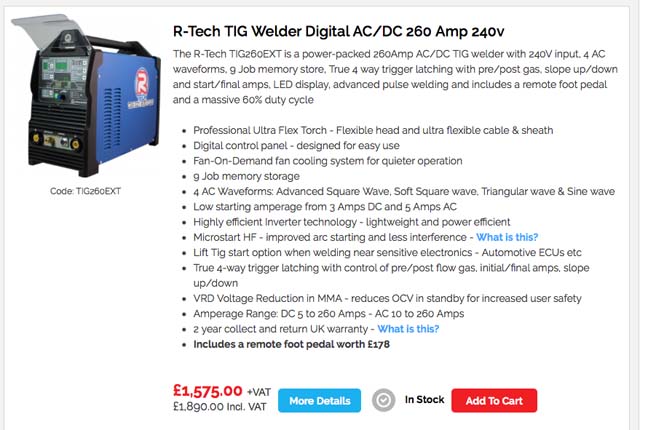

    Yeah,
    There's the R-Tech brand that approximates Everlast units, although they don't seem to support 3-phase. But this one unit would do 260 amps on Single-phase.
    Since R-Tech is marketed in the UK, maybe it would be easy to purchase and get support for with just a ferry ride, at least while the UK is still somewhat part of the EU.
    http://www.r-techwelding.co.uk/weldi...nt/tig-welder/

    Finland is the distributor for Europe. The r tech units have significant internal differences.
    Ok. R-tech looks intresting. But i am not sure if it is a good machine. And if the support is ok.
    Are the Everlast 255ext or 325ext running on the 3 phase network here?
