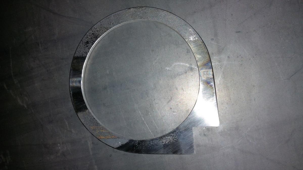

    Here's my advise. Start a puddle, as soon as you see it go liquid dab the rod into the puddle, move forward half the diameter of the puddle and repeat. The puddle melts the filler, never the arc. It may help you to practice with no filler first. Just concentrate on keeping your puddles the same width and travel speed and arc length consistent. Here's a picture of an autogenous weld (no filler) on 2 pieces of 3"x3/16" steel. It's welded from both sides to keep it flat then plasma cut.This video may help you as well

    I've been watching Jody's videos a lot. Getting the smooth movement seems to be my biggest issue, as it is with O/A welding. I know it will get better with practice. Constant arc length is another one of my problems, again, practice will help that. Adding the foot pedal to my old O/A techniques is like patting your head and rubbing your belly.
    All in all, I'm actually pretty satisfied with my progress for just two afternoons worth of work. If I remember correctly, back in the 60's when I was going to school working on my A&P license, it took the better part of a semester with O/A to get where I am now with the TIG.

    Clean up your plate. That will make loads of difference. Grind it. Also you might want to lighten up your lens more so you can see if you are going crooked.
    Going crooked is because I'm rotating at my wrist instead of moving along the plate. I know the problem, just need to make the fix!. I did lighten the shade on the helmet and that helps a lot. I also got a cheater lens for the helmet, but haven't had a chance to try that out yet. Thanks for all the feedback!
    Sometimes often overlooked, is where you place your Elbow...
    Your forearm swings in a arc from your elbow and moving it closer/farther away from your body changes where that arc swings in the weld. Your thumb/index finger can correct at the beginning/end of the "swing" to keep straight if that arc is Centered in the weld path.
    ANYTHING you can do to support your hand helps, sliding on a Tig Finger it Great even if you have to clamp a temporary support on the piece you're welding to mimic a tables "rest". Having Two points, the elbow and the side of your hand, will steady the torch So Much!
