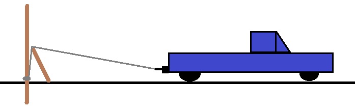

    There's an easier way my friend... posts will come up with ease.

    There are a myriad of ways to slay this dragon. The truck method may work on a ranch with plenty of level real estate, but on the sloped front lawn of a typical suburb?
    Just illustrating one of may ways to accomplish the task. Employ the one best suited to your particular situation.
