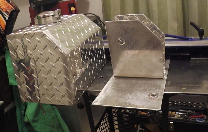

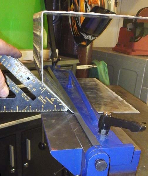

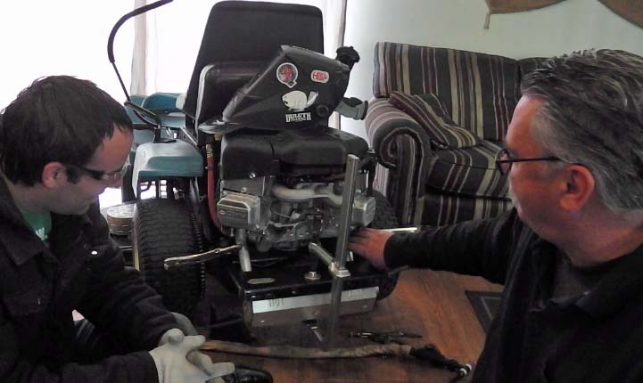

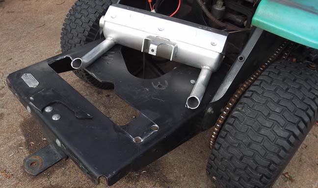

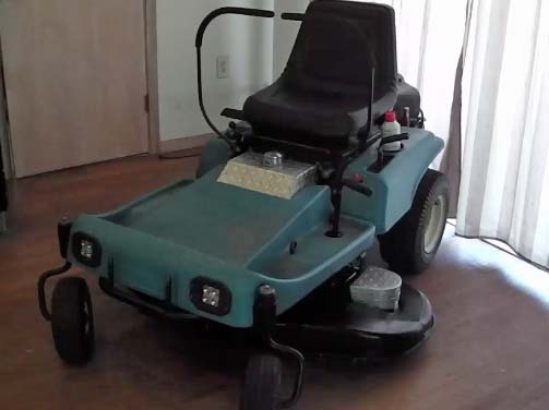

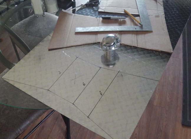

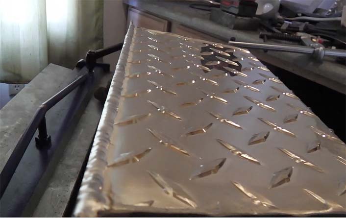

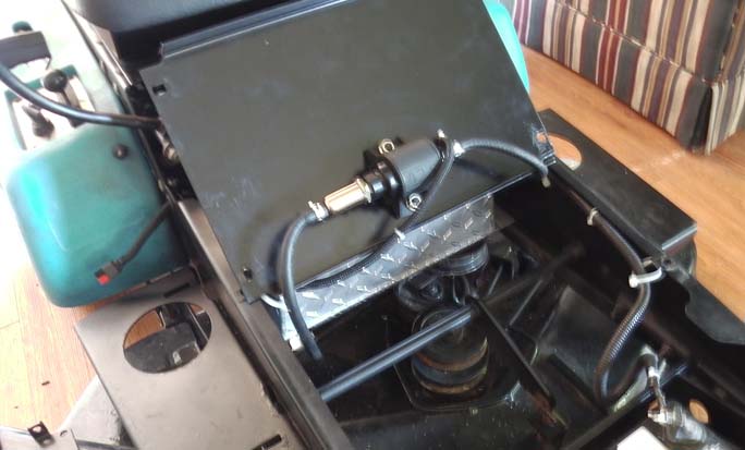

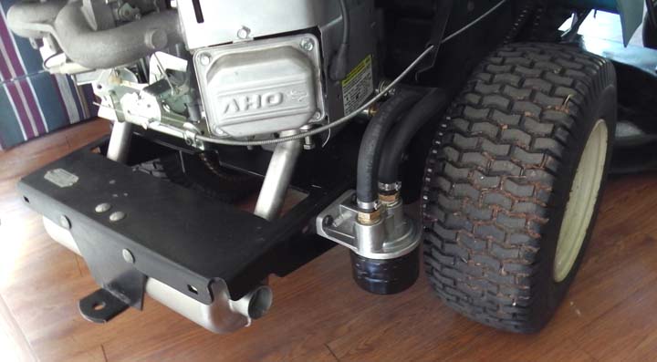

    Here’s a recently completed and fun project that may hold some interest for a few Everlast Forum members, as welding, fabrication, transition solutions, and engine-driven stuff often go together. And my Everlast 210EXT is shown in use on a few segments.
    But, the video covers a lot, so I’ll include photo clippings from it below too, along with the text description from the YouTube site itself.
    "Christian Livingstone shares his zero-turn mower re-powering project, involving an upgrade from a 12 HP Single cylinder flathead motor to a 20 HP Twin cylinder overhead valve motor, to compensate for a larger mowing deck installation on his 1995 Dixon, model 3304. The video is somewhat lengthy, at about 78 minutes, so there may only be genuine appeal for the true riding mower enthusiasts. But, there is quite a bit of welding and fabrication demonstrated, including a custom, aluminum, diamond plate gas tank, along with a conversion from a vacuum actuated fuel pump to an electric fuel pump. An exhaust modification is made. Best practices for the bending of aluminum sheet to minimize cracking is shown. Some novice wiring and troubleshooting is done. A pulley ratio is changed, along with increasing the engine's top no-load speed to a seemingly modest 3100 RPMs, giving the mower a faster travel speed without outrunning the ability of the blade speed to give a finished cut. The application and use of pre-emergent herbicide is touched upon, along with some brief mention of incidental topics and views, too. A recap is given with rationales for most of the actions taken. On a couple video segments Christian is assisted by a neighbor/friend, who may be the first person in human history to TIG weld for the first time while having someone else doing the filler metal deposition. Otherwise, Christian humorously frames the project as a “Poor Man’s Jay Leno’s Garage: Dixon Mower Re-Power & Mods”.

    Here’s an addendum video to the “Poor Man’s Jay Leno’s Garage” one. And while the parent video had some welding and fabrication with my Everlast 210EXT involved, this one just gives some mower motor solutions. But, as the Spring season is now arriving and some fellow Everlast Forum members are undoubtedly getting their riding mowers with these type of motors ready for use, someone here may find some of the information helpful.
