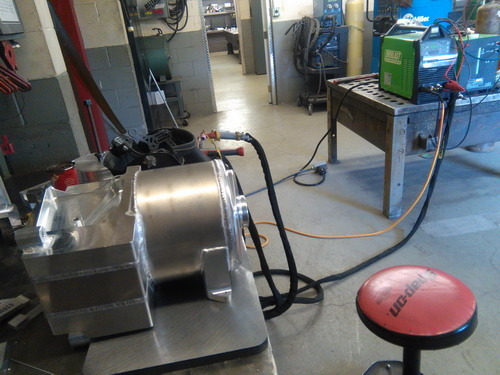

    I was welding with my 325EXT in triangular wave and the most I could get it to weld was 176 Amps I tried single phase the same as three phase 176 Amps. So I tried all the rest and the same see list below this what the reading was on the machine. So single phase 240V or 3 phase 240V makes no difference plus or minus 1 or 2 amps is nothing, I thought in 3 phase it would be the higher. Still waiting from Everlast Canada. Now I am using the new E3 tungsten and it works very well and triangular wave work very well upside down on aluminum.

    I can only weld 3/16 aluminum plate just with the pedal all the way to the floor. 1/4 inch plate I can not weld with the 325 EXT in Triangular wave. on Advance square at 320 Amps I can weld 1/2 inch aluminum easily.
    That is because it is only at the peak for a tiny, tiny amount of time. Triangular is for thin metals because of this. Turn down the Hertz to 50 or so if you want to see more heat.
    Also go to 20% or less on balance.
    Send me an email on your exact amps you get at max and your experience and I'll discuss it further with the factory. But I think the main issue is that is the nature of the Triangular wave. It cools rapidly.
    Well I set the AC Balance to 20 and the AC Hz to 40 and i just was able to weld 1/4 aluminum plate. The reason I want to use the Triangular wave is to weld parts onto a boat upside down and it works well on the thinner parts so far. Using the E3 tungsten helps also better then 2% lanthanated it keeps a stable arc and not ball up as much on the end and has a nice clean round ball on the end of the point.

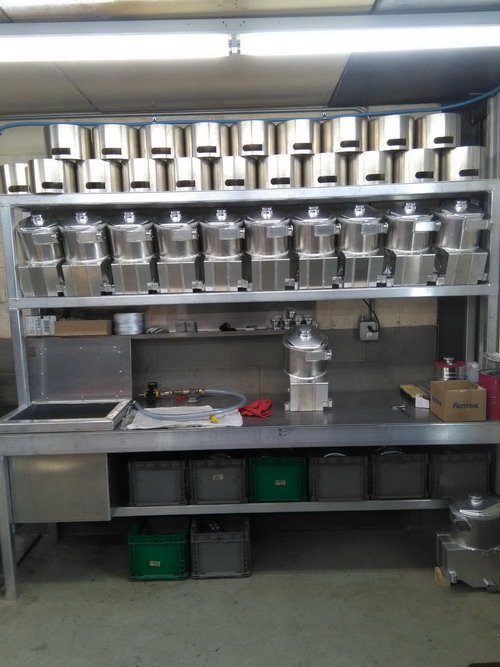

    Well it has been over 2 months since I posted the problem on 01/08/2017 about the triangular wave and now it is 03/13/2017 and still have not heard anything from Everlast U.S.A. or Everlast Canada on what to do.
    It would be nice if another 325EXT user could replicate this to see if it's an issue with your machine or something in the design.

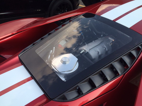

    Well I am going to Lincoln next week to see their Aspect 375 Welder the Miller is out to lunch with theirs at almost $16,000.00 with taxes if I have too I will have the 325EXT as a backup, the Lincoln has a 5 year warranty and that will last the duration of the job I have now to do for Ford making 2017 GT oil tanks.

    Beautiful work making the oil tanks Kempy.
    used a 375 aspect this winter at a trade show....liked it alot ..could have bought it for 5600.00......friend of mine made the fuel cell for a gt-40 was really sharp....i make reservoir tanks for intercoolers.
