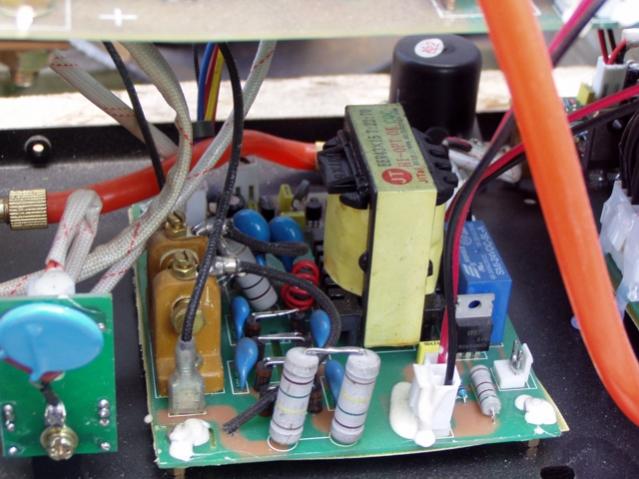

    This is for a CT520D 3 in 1, not a Everlast product. We're getting a pilot spark, but the plasma will not kick in. Can you guys give me a list of what to check out to find out what the problem is?

    Hi can you let us know what make it is . It is possible you have to adjust your gap as even though you have some spark it may need to be gapped to get optimum spark. Depending on the make this could be a screw adjustment or simply bending the leg.

    It's a Simardre tech.
    A warped mind is a wonderful thing to abuse
    Hi CSR
    That is a bit Tricky. the problem is that if Simadre and some others are still getting there units from the Supplier i visited a couple of years ago there is no way of telling what configuration the HF board is.
    The problem is they do not produce the PCB boards themselves and in fact from what i saw there where at least 2 different layouts being used.
    They would not admit this to me of course but having visited there ( i hesitate to call it a Factory ) Old Colonial Mansion from the days of Imperial European Involvement in China there was no facility for making boards and in fact absolutely no indication of this being done there. In a way this may be a good thing given the poor state of the building for this type of intricate work
    The Board in question is a small 3"x 3" board on the bottom base front of the machine and if you contact Simarde they should be able to supply this to you.As i remember it is not very difficult to replace as it is only 3-4 plugs to switch over to the new Board.
    I have a feeling the boards are put together as a cottage industry and i can just imagine a family sitting in a small room surounded by chips patiently soldering each tiny component.

    Would it help if I took a picture of the board, now that I know what to look for to see if it can be adjusted?
    Cliff
    Yes it definately would help . The HF points themselves could be one of three different types . I think the most common that i seem to recall seeing was a brown plastic ( U -shape holder) but i have no way of knowing your configuration without seeing it .

    I've got a picture of the board. Or I'll say I hope it's the right board. It's in the place you said and there's a small brown horseshoe thing you mentioned. If I need to take another shot just let me know, of what and from what angle.

    Check the gap between the 2 points that are mounted in the horseshoe . I seem to recall a credit card is a good spacer and it is non metalic. And i would also suggest you check all connections to make sure they are firmly seated. If this does not solve your dilema i Would suggest contacting Simardre and requesting either a new board or depending on Warranty purchasing the Board.
    either way keep us posted and hopefully it is a simple case of resetiing the gap .

    Well I just did my 1st attempt at adjusting the gap. The space was tighter then a credit card. So I backed it out a bit and gapped to the card. Everything looks tight, no blown resistors or anything. No go, same thing. I'm going to try it a little closure after the caps cool down. Waiting to hear from Simadre.

    Sorry for the extra long delay, but life got in the way. I've tried to adjust the gap a few different times now. No luck, the same with any response for Simadre's so called tech support. I got 1 back from him then no responce to the next 6 emails. So how do I figure out what board I have and who is the best company to get a replacement from?
