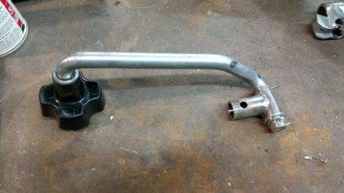

    Someone came in tonight holding a broken jack handle.

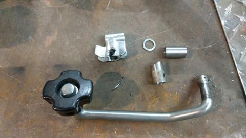

    Had some stainless tube close to the right size. Touched up the bore, drilled and fishmouthed it.

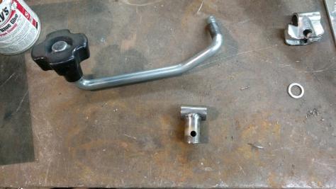

    Quick TIG with 308 filler.

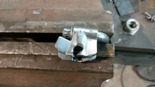

    Done deal, ready to go.
