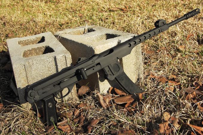

    Here's a photo of one of my recently completed TIG projects. Love this welder!
    It's a Polish PPs-43 Sub machine gun.
    Now, before anyone asks, it's now semi auto only and I'm a licensed firearms manufacturer. Class 07FFL.
Name:	PPs rifle1.jpg
