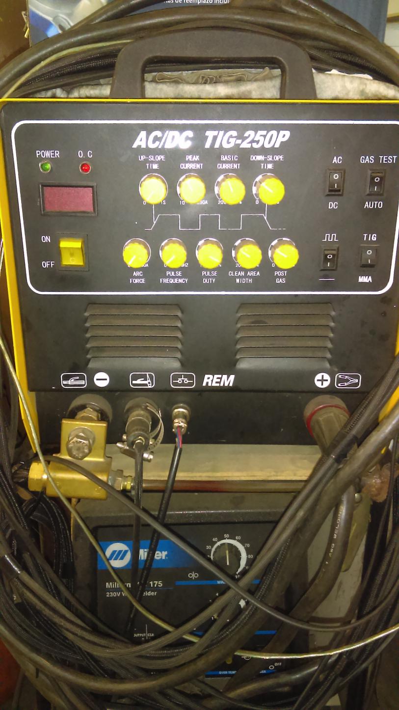

    Hello all at everlast I am having an issue with my Welder it is a tig 250p an older model that has worked flawless except for the foot pedal issues.
    Now on to the problem the Welder stays on without the foot pedal or the thumb switch plugged in and I don't mean the power is on to the welder there is current to the tig torch without a signal telling it to.
    Does anybody have insight as what the problem could be it also seems as there is no high frequency for the start but I can weld aluminum just have to scratch start it but once it starts it seems to be fine it just won't shut off the current ramps up and down just won't quit an arc and the gas continues to flow constantly.
    I've attached a picture of the Welder so everyone can see the model style.
    Thanks for your time, Jake

    Sounds like perhaps it might be at least partly in stick mode. (MMA) Try flipping that switch back and forth a bunch to help clean the contacts. And or give it a shot of contact cleaner, or remove and test it.
    Checked the mma/tig switch and that made the gas solenoid turn on and off. Took the cover off cleaned and adjusted high frequency contacts and still no luck with high frequency starts as its stuck already on.
    Investigating a little further I found where one of the thumb switch wire was melted through the casing and I'm sure this happened while I was welding this job could it be something got fried in the control when this happened ?
    I don't see anything burnt on the boards but doesn't mean any of the mosfet and diodes which appears to be many aren't hurt. Just at a loss right now so if it can't be repaired easy I guess I'll be looking at upgrading my welder.

    That is normal operation for the MMA mode. That's why I was thinking that switch might be faulty. Especially if is something like a DPDT where maybe only one pole has gone bad. But if you say the gas is on all the time as well, that points to the standard TIG starting system being fried. And it would go with your melting through a wire. It is probably repairable as several people on this forum have fixed those machines without a lot of trouble. But that would not be a fun as getting a nice new machine, just because.
    Called in to tech and they think the main control panel is likely the culprit but no service parts are available for this old of a machine . Their option was to send in for repair but I don't think it is worth the time on a 8 year old welder and I'm in maryland. The welder did a great job for that time with no repairs except some modifications to the foot pedal.

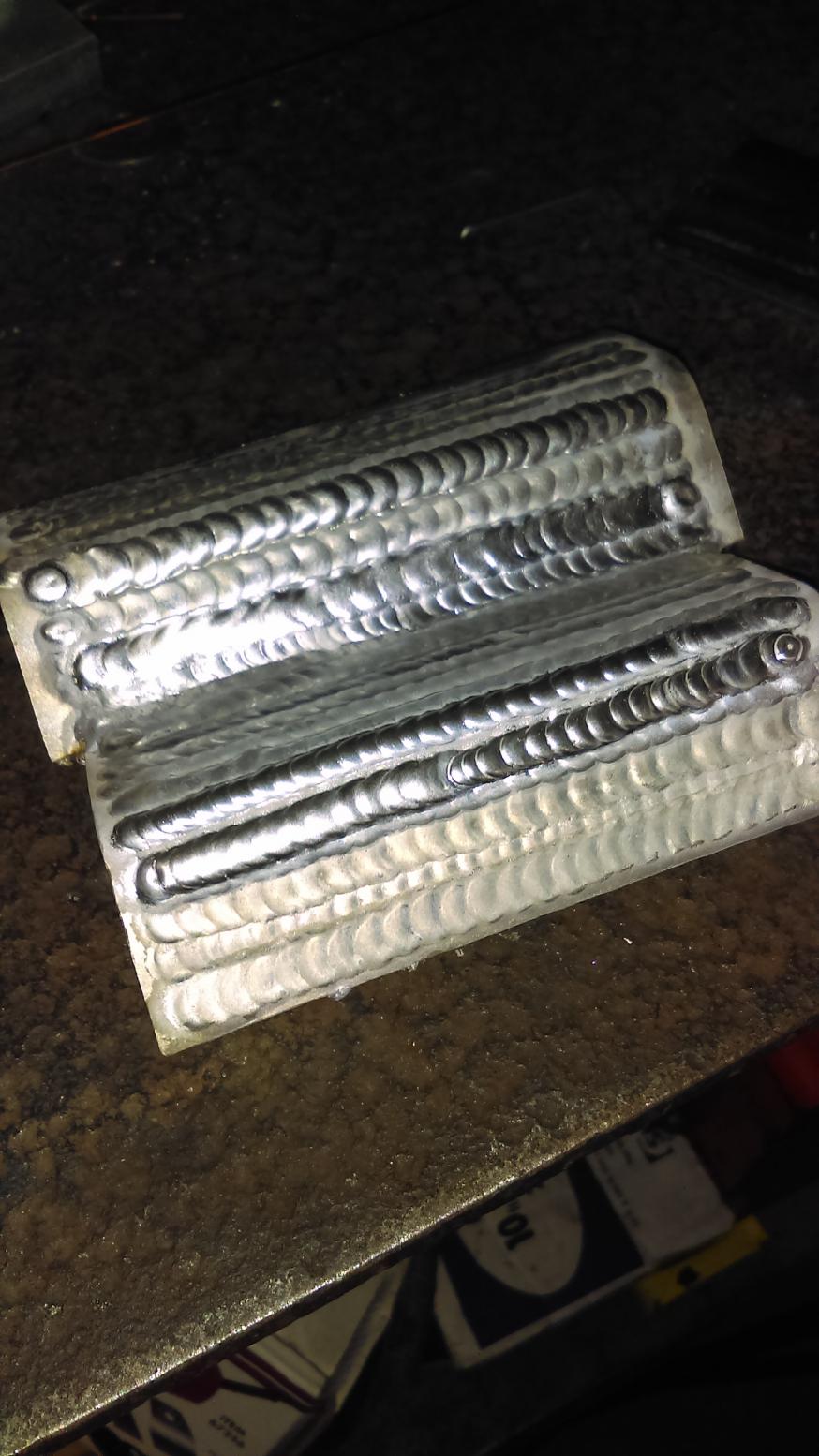

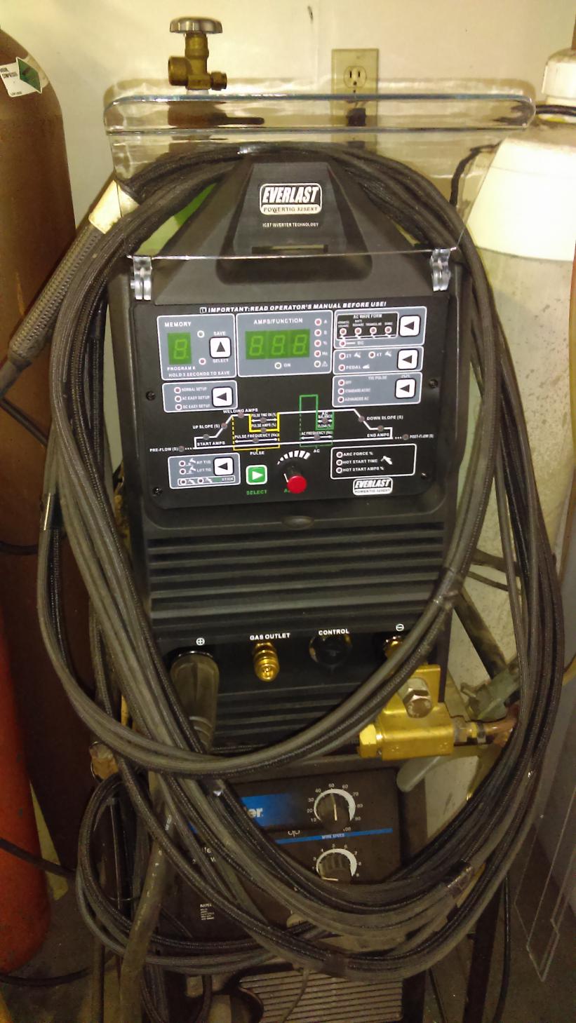

    Well got the new welder I made the choice of a powertig 325 ext just received it today ordered on the 12th.
    Came home and wired the plug on, made a new extension cord hooked up my torch and gas lines and started melting metal.
    I primarily weld aluminum and man this machine is world's different than my old machine.
    The only thing that seems out of place with this machine is the foot pedal the reaction is just to slow I like to pulse with my foot and it will hit the microswitch and shut off the arc before the gearing reacts on the potentiometer so I will be getting an ssc pedal to try out and see if it works better.
    Here are couple pics one of the face with my torch leads hooked up and one of some beads I ran adjusting the machine to my liking (man there are a lot adjustments that actually make adjustments visible).Click image for larger version.
