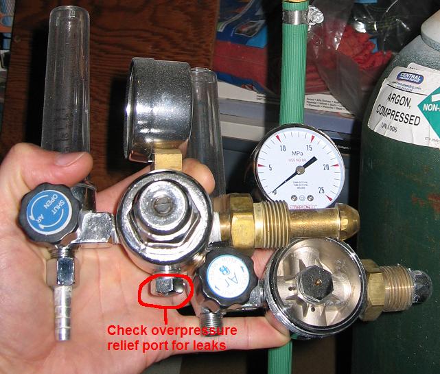

    I am using a quick connect to connect and disconnect the argon from the air line on my multi function machine and I am using the ball type flow gauge it came with; my mig has the twin head flow gauge and when I stop welding and shut the tank off the mig gauge stays at 15 cfh where I have it set, and the first gauge off the tank show the high pressure but on the tigs argon gauge/ball flow gauge when I stop welding, and shut the tank off the gauge pressure bleeds right down to nothing at the tank, the high pressure gauge which to me would indicate a leak somewhere in the machine, all my fittings are teflon taped into place and clamped with two clamps, and I took soapy water to check for leaks.
    It stands to reason that the ball gauge would not move when the flow is stopped, but the gauge off the tank should remain at the pressure reading when the tank is shut off and machine is not in use as my mig does with the other type flow gauge.
    Anyone else have experiences or can verify how ball type flow gauge should work?

    The flow meter has an over pressure relief vent, which you should check with some soapy water or leak testing fluid to see if there is any argon escaping out of it when the argon bottle is open. It's usually below the main regulator body of the flowmeter. I have circled it in the picture below of the Everlast unit.
    A properly functioning flowmeter / regulator should not have any leaks out of its over pressure relief port. I have experienced issues with my everlast flowmeters leaking out gas here. To Everlast's credit, they have sent me a replacement flowmeter free of charge, however unfortunately it too had the same problem as my first one, so it may be a common problem.
    After some disassembly and troubleshooting, I believe the root cause is not a faulty over pressure relief valve (which seems to be functioning as intended, and not allowing the regulator to explode...), but rather a faulty main pressure regulating needle valve seat, which when closed, does not completely seal and shut off the high pressure argon from inside the tank. It seems a tiny amount of gas can get past it...
    I was only able to resolve the issue by going to a different brand of flowmeter.

    I had a fairly fast leak develop in my multi-function machine. When the tank valve was shut the tank pressure gauge would bleed from 2000 to zero in about 10 seconds. It turned out that the problem was at the hose connection on the solenoid for the machine pressure gauge line.
    The 70 psi air pressure used when plasma cutting had pushed the hose about 3/4 of the way off the barb fitting. After pushing the line back on and pinching the clamp fully shut, this joint was gas tight.
    I still had a slow leak somewhere as evidenced by the pressure gauge bleeding down to zero in about 2 minutes. This leak was in the quick coupler. After spinning the quick coupler to a new positon while coupled onto the machine, the leak stopped. It now takes hours to bleed down when shut off, which I think is pretty typical of any system.
