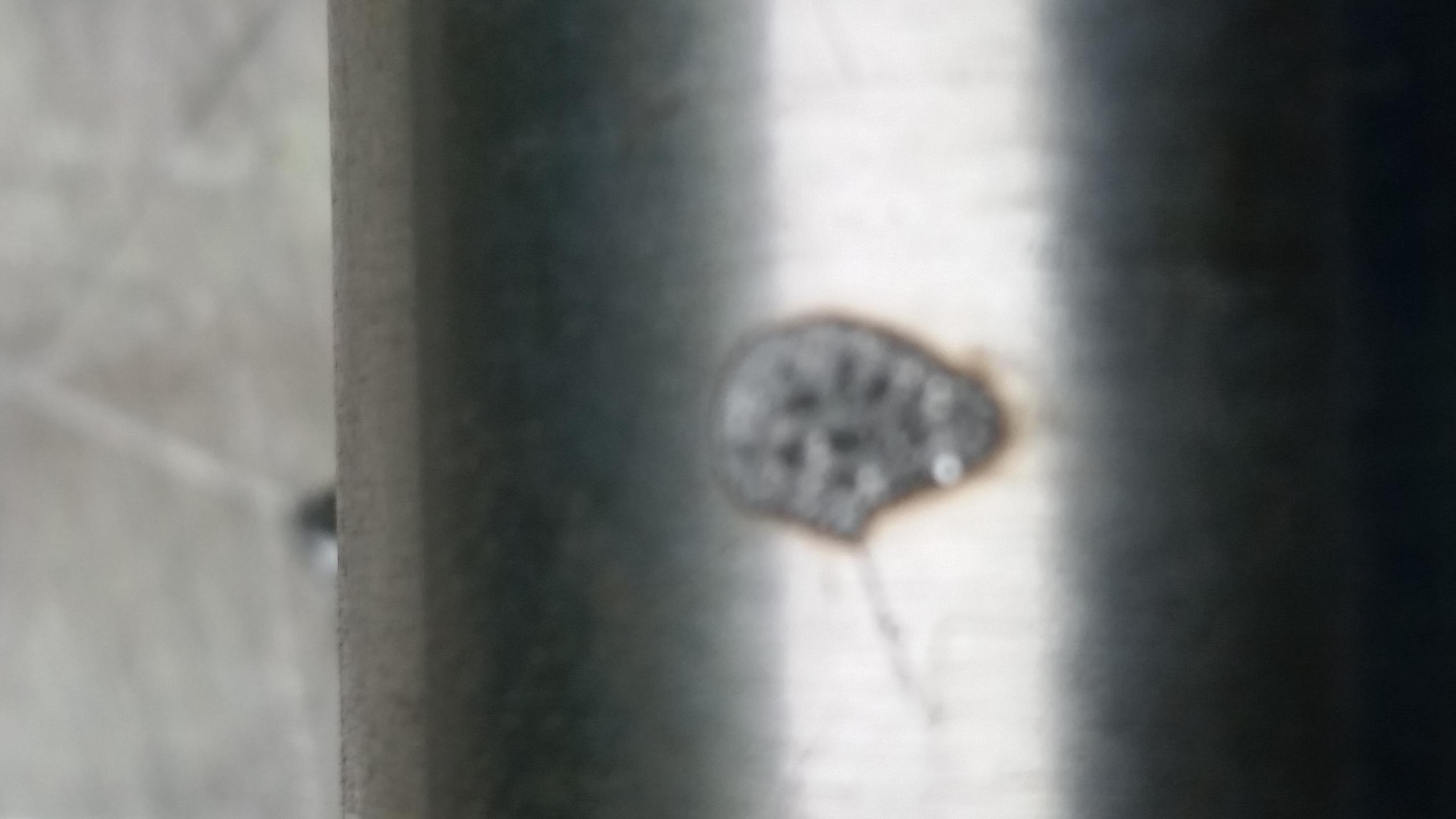

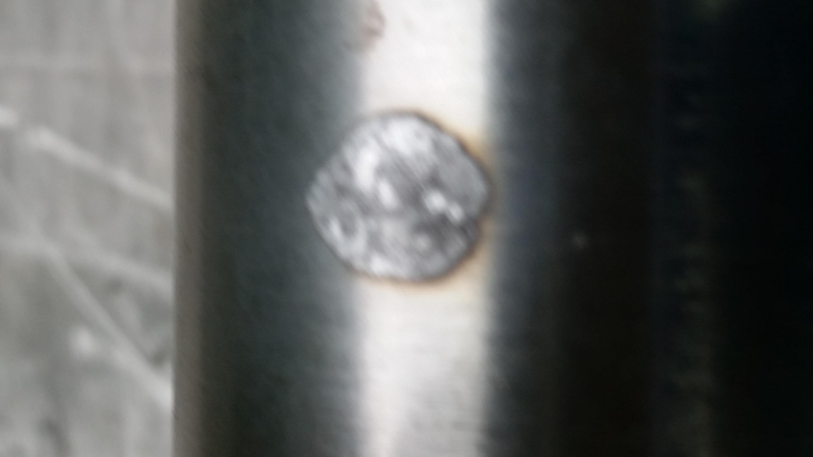

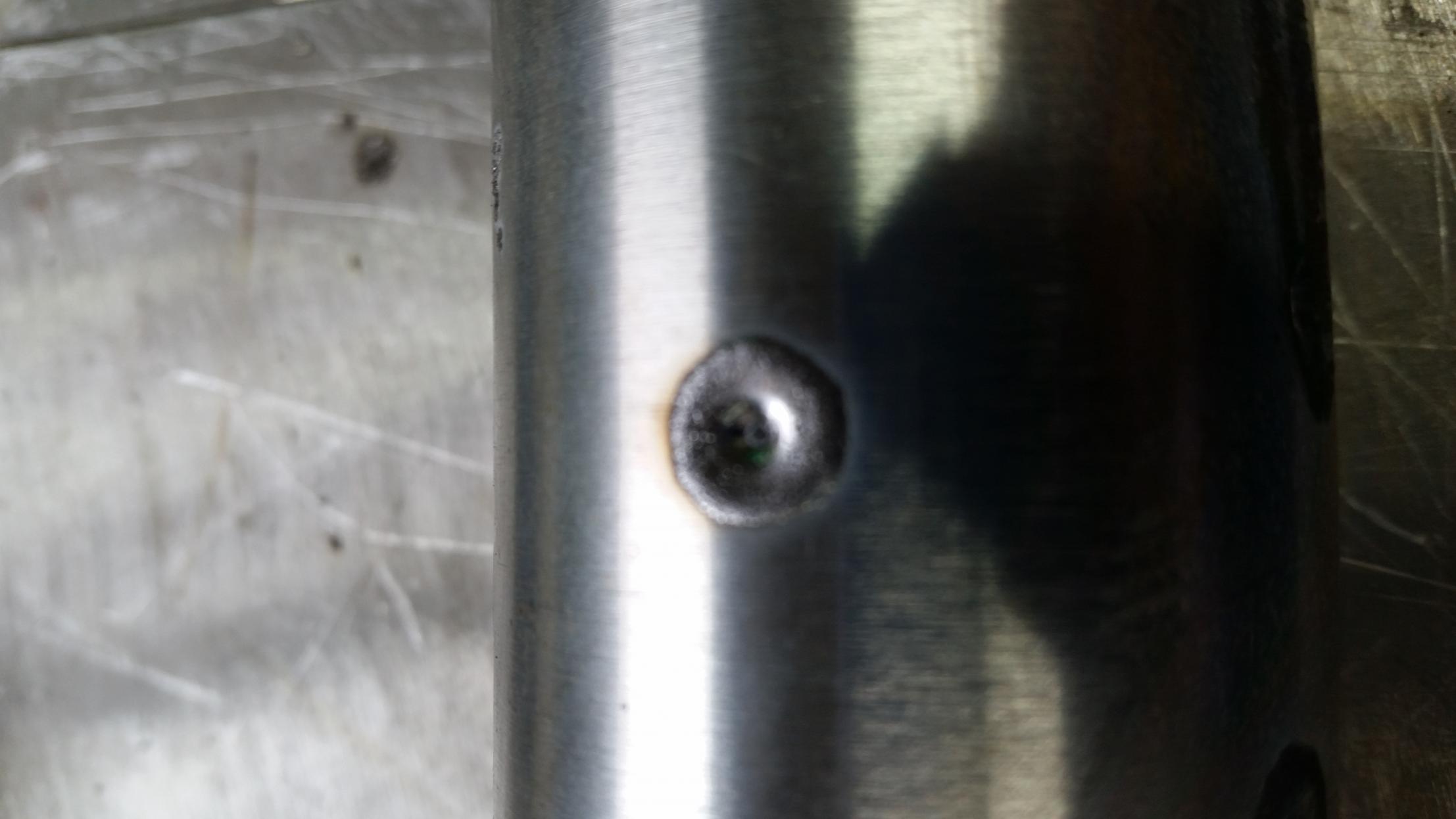

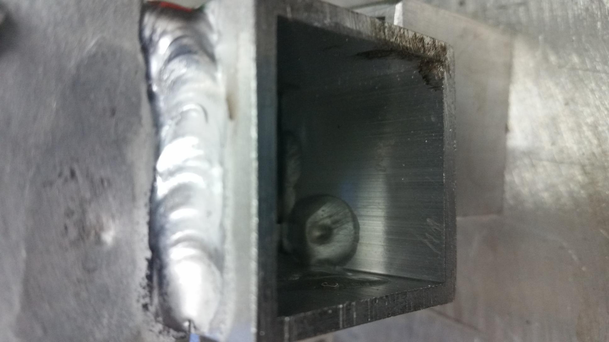

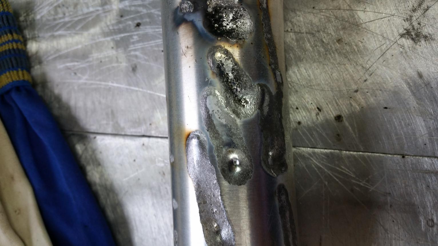

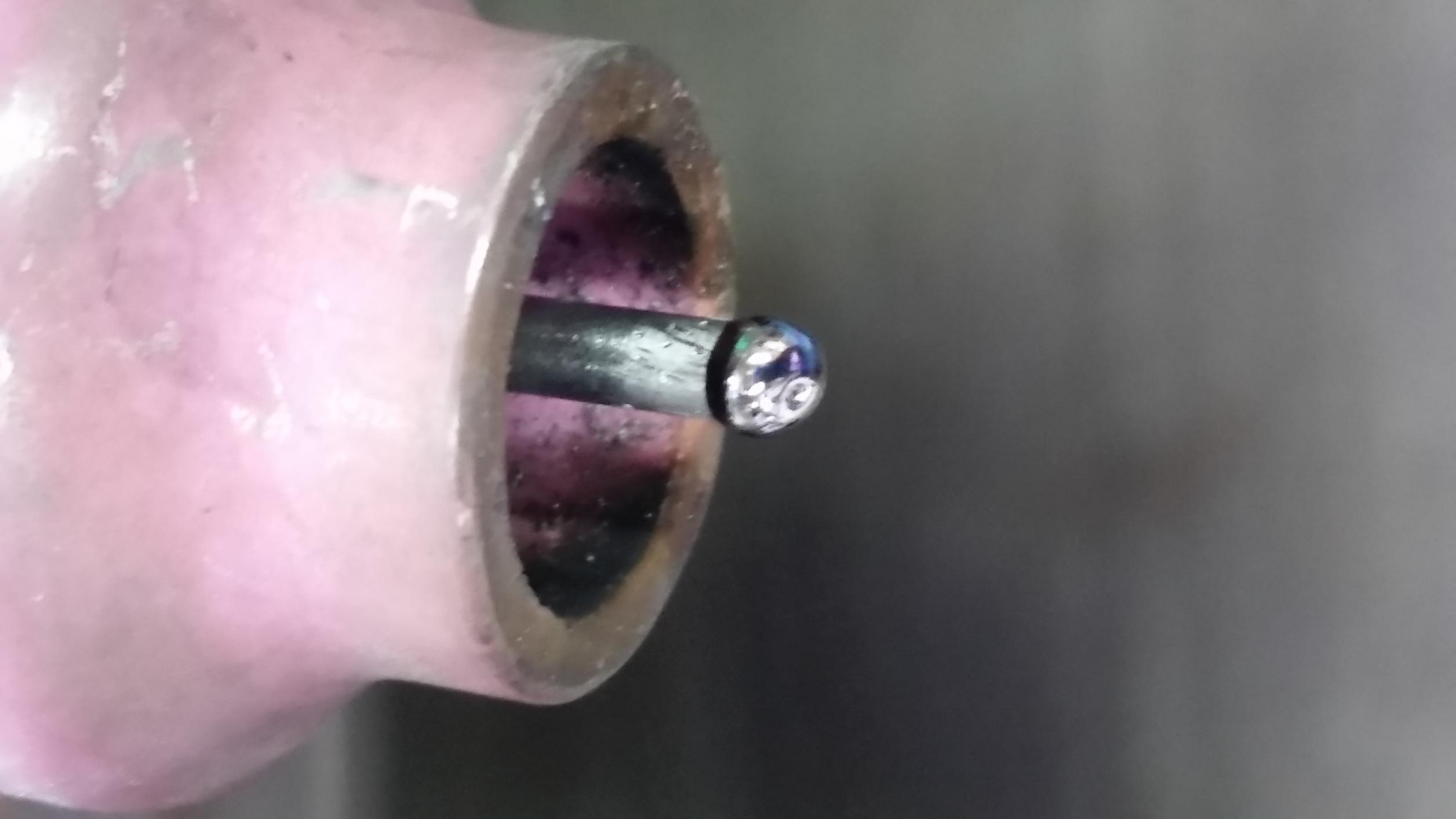

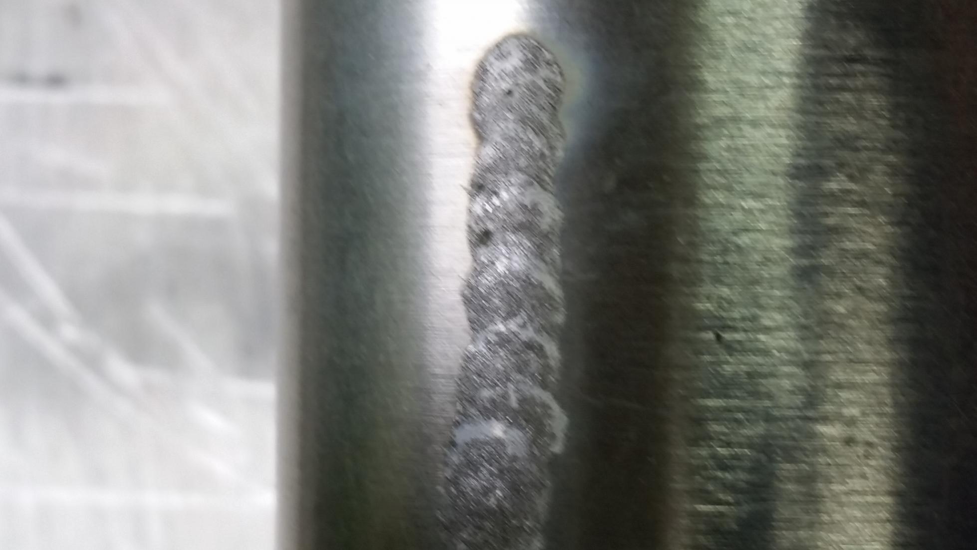

  11. Default Testing ac capability
    1/8 wall aluminum tube
    First picture- 100 amps 35% balance
    Second pic- 30 amps 35% balance
    Third pic- 200 amps 35%
    Fifth pic- 100 amps 35% and moving
    Forth pic- tungsten after changing ac from 35 to 60/70% balance. Started as a pointed tungsten
    Sixth pic- 100 amps 40% balance bottom and increased balance as you move up.
    Tried 30 amps and then pulling tungsten away from metal as suggested. No crackle, Arc just lengthened. I did notice as I tried to move the Arc it stuck behind, kinda wouldn't move with torch and kinda sparkled instead of nice Arc like when welding dc. Started wondering if the hf start wasn't shutting off after the Arc initiated or it was staying on because the Arc won't initiate. Thank you all for your assistance. Still fustrated this is my second welder to go this year. My I mig 250 broke earlier this year.

    Don't see any cleaning action (cathodic etching ) at all. Looks a lot like poor gas coverage, except the tungsten is bright and shiny. Since the tungsten balled, you have to be getting the DCEP part of the wave. Sounds like the balance control is working as well. Once again it sure seems to point to a gas contamination, or air leak or something. That's what I would check as a first step. Swap to a known good bottle of pure argon, and make sure there are no leaks in the hoses or fittings. I would also advise a slightly large cup size for aluminum. It might just be the closeup, but that looks like a #4. I would go with a minimum of a #6 for better cleaning action.

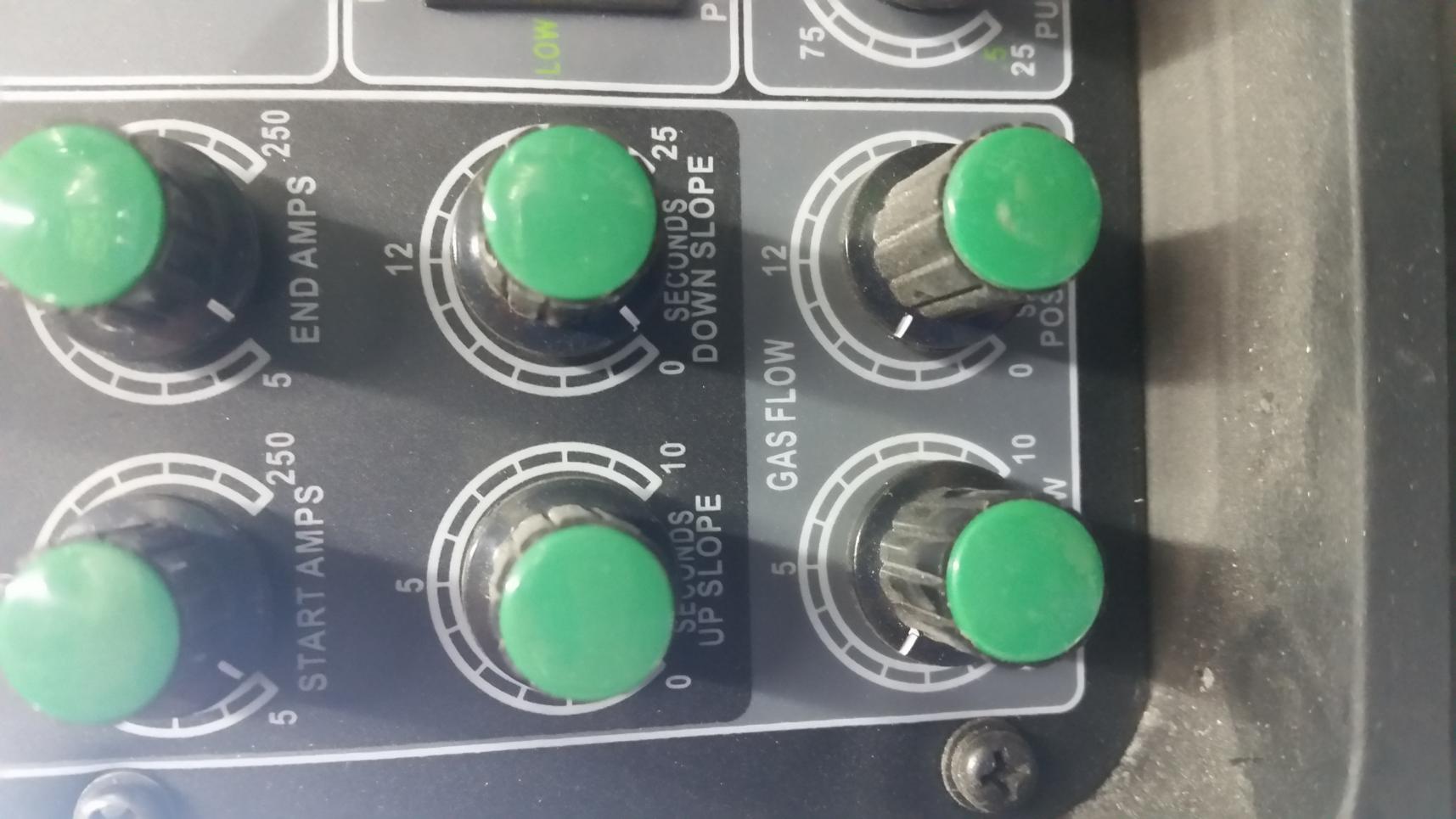

    Hey, Blaze,
    Please post a photo of the face of your machine that shows all the knob settings and the cables plugged into it.
    And then, how about a bead on plate, mild steel, as well, too, please.
    And, is your gas 100% Argon, or is it C25?

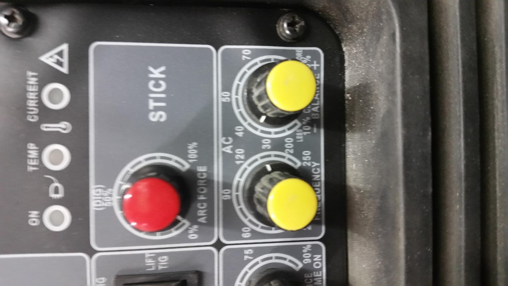

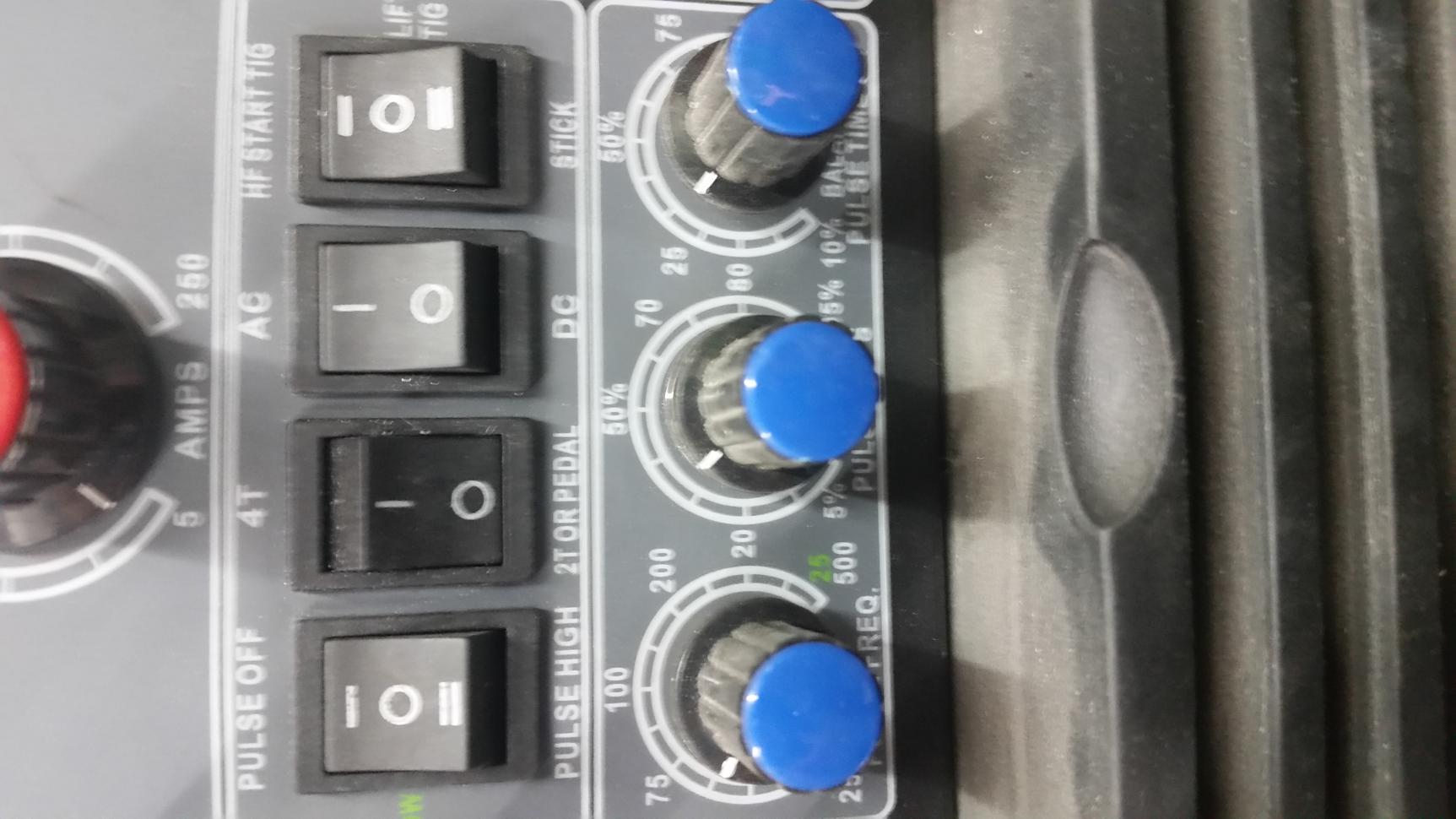

  18. Default
    Here are pics of the front of my 250EX. No pulse is being used. Hf start. Various frq settings. Tried 60 to 200.

  19. Default
    I decided to try lift start tig. Couldn't get it to work but after multiple tries it finally started working. Changed back to hf start and the machine started welding good again. The hf still stutters sometimes but is now changing over to a steady Arc. I don't know what makes the machine change from hf start to a welding Arc but it finally is switching. Anyone know how that works? Also what role does stick out length perform during ac welding or any welding. Really would like to know how the hf to welding Arc switching works. So happy but it still stutters once in awhile. Do I need to clean something inside or you think a part is going bad? Thanks Rambozo and everyone!
