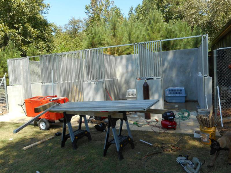

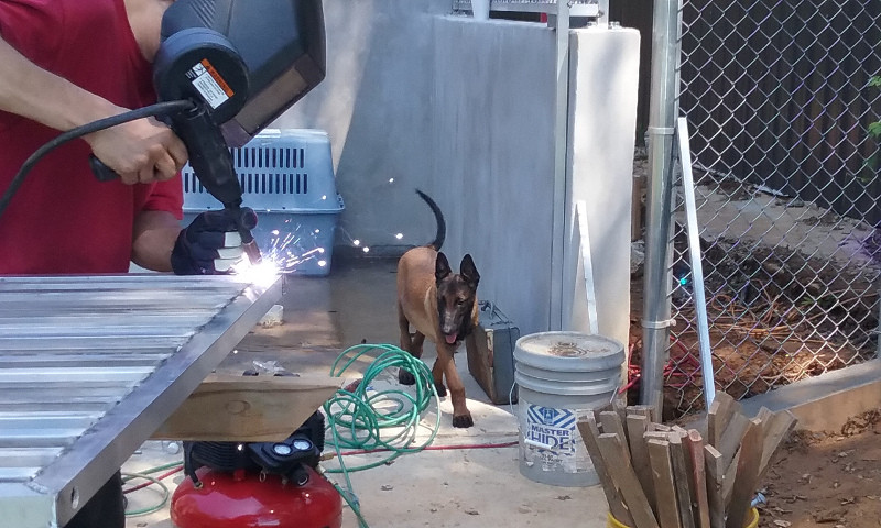

    Thx! I have to make 2 more panels for another phase of the project but after that, the jig is pretty much useless, yes. That's why I just heavily tacked it together for easy deconstruction.
    Otherwise, aluminum for fencing seems kind of rare, and the picket spacing seems kind of tight, i.e., labor and material intensive.
    1.5" spacing. I tried to explain this to the customer, but anyone with zero fabrication experience will just think 'thats ridiculous!'
    Was this for around a pool?
    4 stall dog kennel and there is another single stall that will come a little later. Concrete is already poured.
