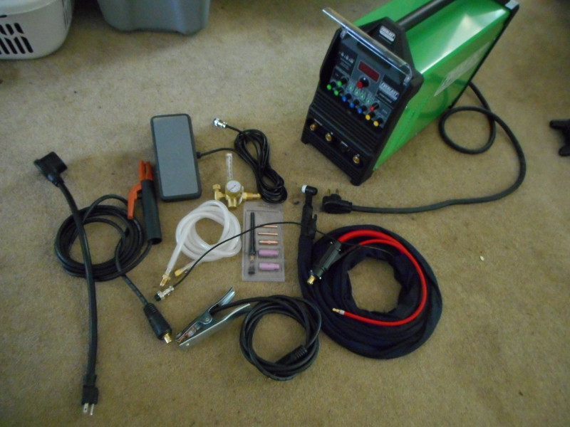

    So seeing that this sub-forum appears to be more active than 'Introduce Yourself' or 'Pre-purchase(etc)' I'll post here.
    I just purchased a 200DV yesterday and await its arrival. I have used exclusively Blue and Red(and even a Yellow!) machines for a good while and have been hearing positive things about Everlast from some people who any welder would have to take seriously.
    I have a fairly big project at hand requiring over 200' of welding of .125" aluminum tubing. This thing is going to be put through the ringer as soon as its kicked off the UPS truck.
    I am also on a life long crusade against the 'big, dumb' tig torches, so I cannot proceed without a 20. I believe there are air-cooled torches good for 150amps, which I'm hoping will almost cover me on this project.
    It'd be great if someone with .125" aluminum experience on an Everlast machine would share their knowledge on the finer points of 'at what point should you give in and buy a cooler'.

    I'm goin in....

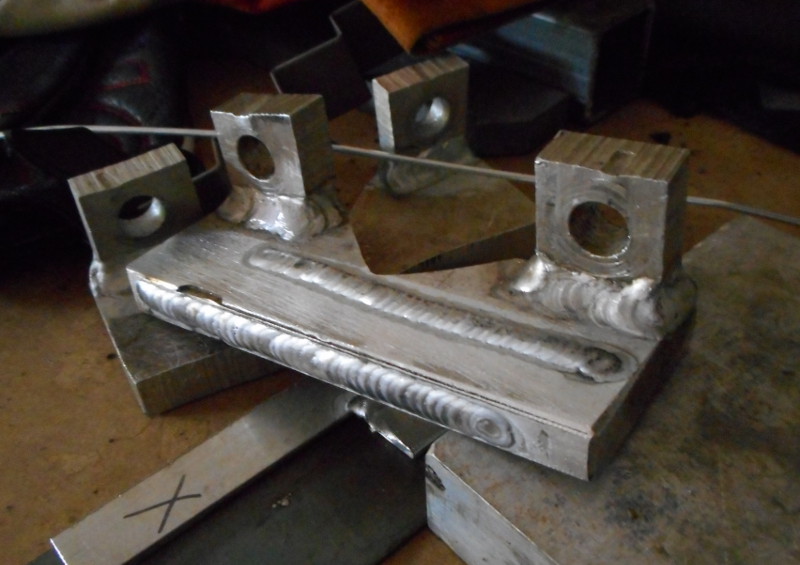

    Initial impressions are pretty good aside from the usual crap quality control coming out of China regarding machined threads etc.
    These inverters are quite impressive. I just laid down these long beads on this .500" thick scrap. These were used to hold Subaru cases in a cylinder hone so they've been saturated with honing oil much of their lives. I set the machine to 160 amps and held the pedal down for most of the time. Totally expected the breaker to lay down but it didn't budge. All on a 30 amp circuit!
    Still not a fan of the bulky 17 torch but it was OK on a trial run.
