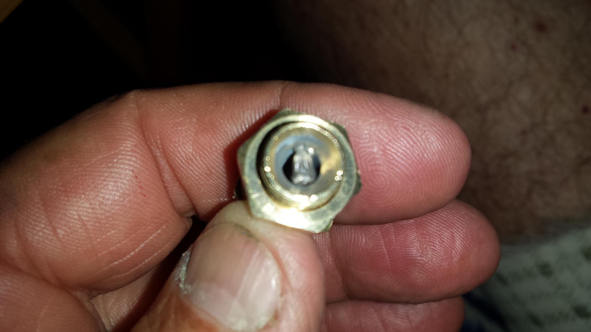

    After playing with the (flawless)steel mig & stick functions..the 200n arrived...set up..acetone THEN new ss wire brush in one direction...21.5 v..355 ipm..25cfh argon....Nothing but turds.....up & down the v wfs thing....same...checked argon fittings with soapy water...all good..took the feed tube out looking for crude in the port...nothing...diffuser clean...check flo but really weak....finally..back to 21.5 v..355 ipm..(my settings at work)..cranked argon up to 60 cfh.....WAY better....crank it wide open...NOW its spraying....great cleaning lines...no soot.......Which leads me to believe..Theres a restriction OR leak starting from the barb on the machine up to the gun......Any 200 dual/200N owners exp this....????...Mark...Ram..Zoama..

ID:	13421Found my problem Zoama....I hooked my steel whip up and pulled the trigger...almost blew my wig off....TONS a argon flo...Hooked the spool gun back up an heard the wind coming from euro connector....The barbed connector from the gas line had burnt(as in melted..lol) from the main stub on the euro...gta bare wire in there too........From the Get go it wasnt shielding...once i went WFO on the argon..it welded sweet for 4 beads...My nozzle is the same...I pulled the ring forward..and the diffuser body blocked the rest of the suction issue as I saw it.....This bites...My machine is rock solid....My gun ???All I needs the barb fitting and forward to fix my deal.....Mark...Got some spare spool gun parts???lol

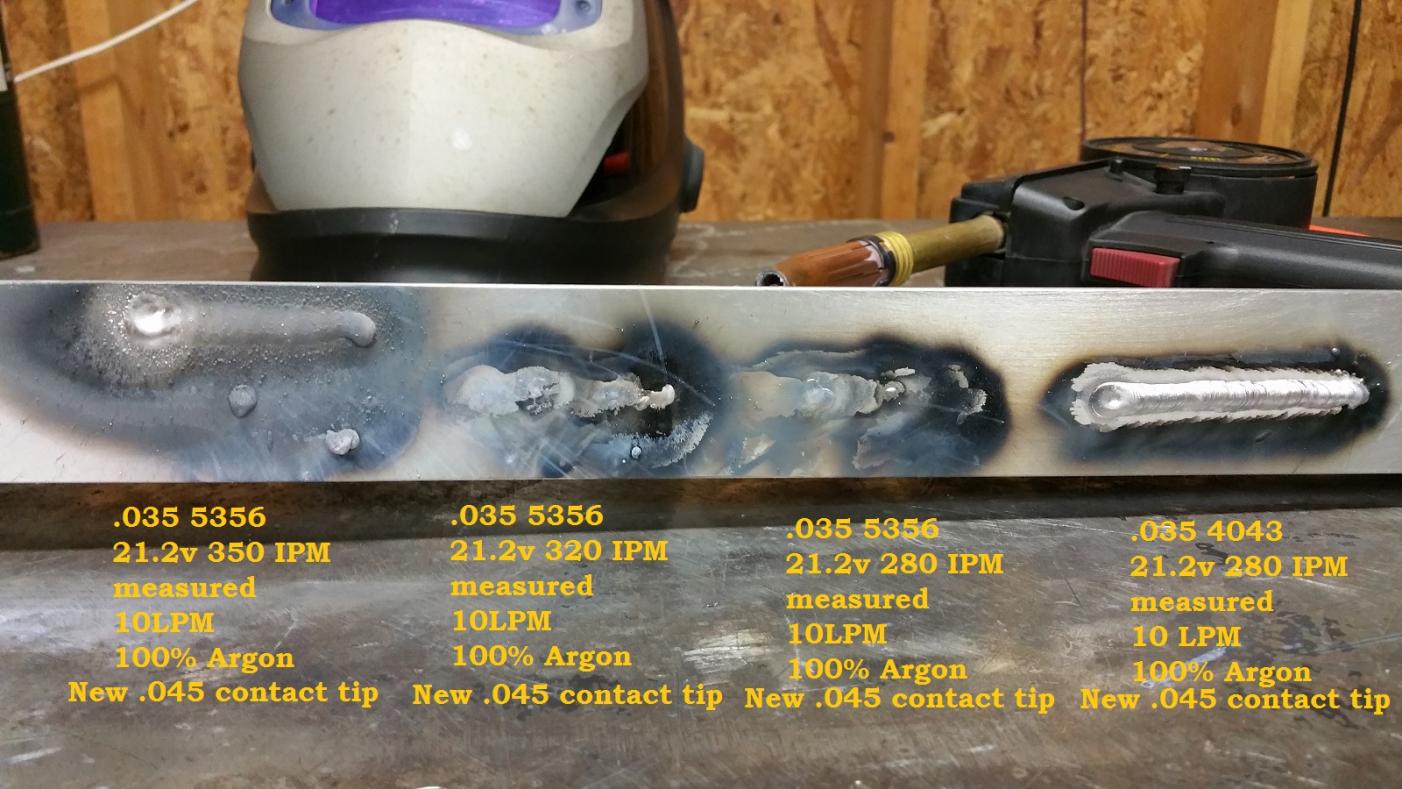

    Could you please post a pic or two of your aluminum welds with the 200n so I'll have something to compare mine to?
    I got a few usable welds with 4043 but I can't run 5356 at any setting.

    Quote Originally Posted by stretch View Post
    I puta teflon liner in my 10' benzel that came with the machine....it feeds/welds 5356 fine....heres 4043 out of the SG...plate was hot hot ..lol....21.5v..355 ipm ....argon wide open....thats when I knew something was wrong...
    So the soot is normal?
    Is the wire speed measured or just set on the panel?
    Anything on the inductance/arc force setting?
    Would the same settings run 5356?

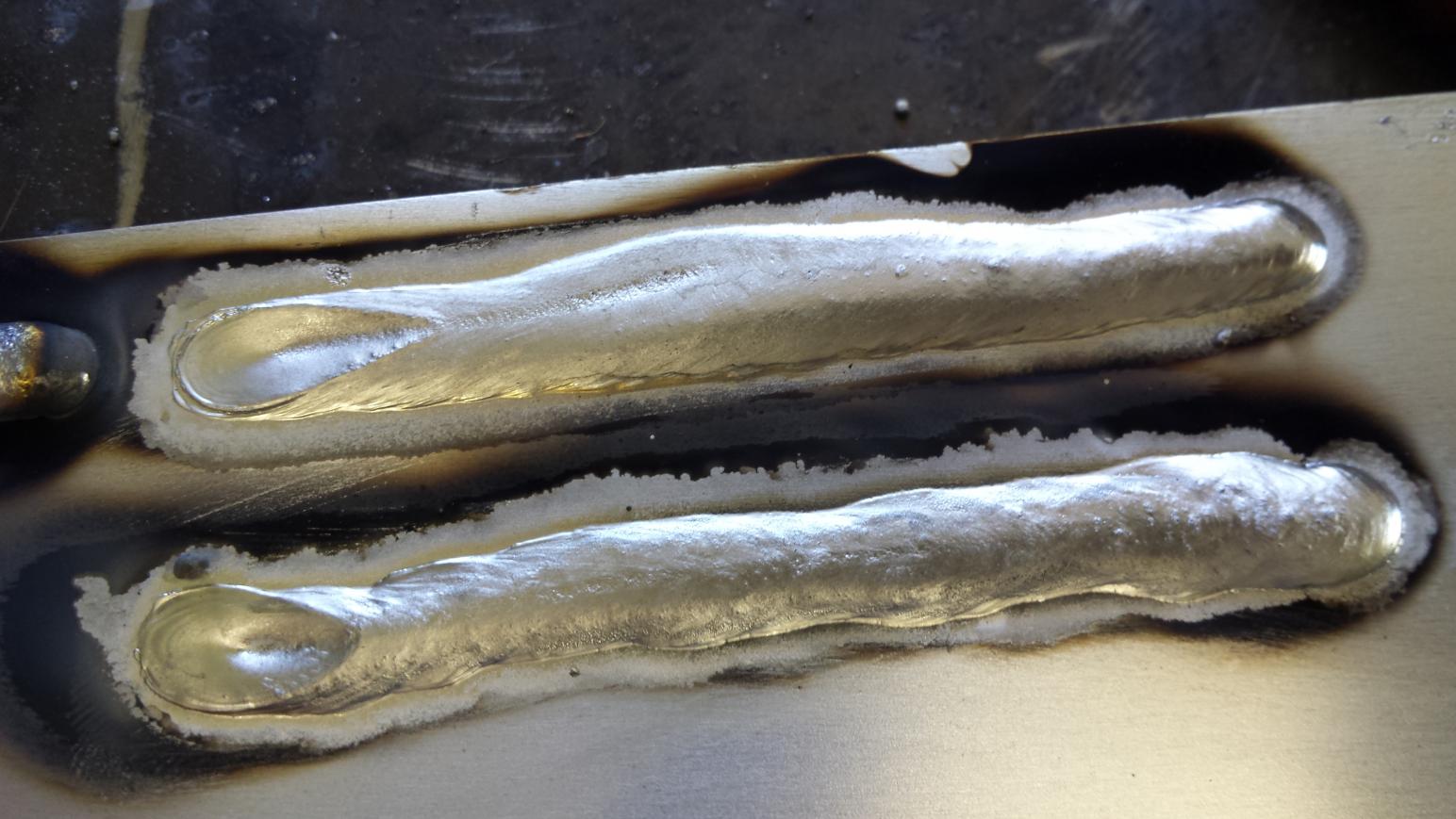

ID:	13423Click image for larger version.
ID:	13424"some" soot is normal...Usally means ur NOT quit there yet..
    "Some" soot is ok..& unavoidable...What you see I caused.....Notice the soot bands on top side of welds...Because of faulty argon flo..AND i wasn't holding the gun 90 degrees..You have sooting on the top side of both..hardly any at the bottom....5356 shuld spray at those numbers...your always gona have to "tweak" it a little...Wire feed is on the panel with the 200....remote function is only with MTS units..An I think the 250 & up..class machines...Didn't get to the point of inductance..gun smoked just as I was dialing in....Im not worried about the gun...In my exp..Everlast has takin care of ALL(all 2)..my equip issues..Yea..Only 2 in 4 years I think...Big deal....LOL...Here's lincoln 5P+++ & tractor supply 1/8 7018..An .023 hard wire..Click image for larger version.

    I found a picture of some of my testing.Click image for larger version.

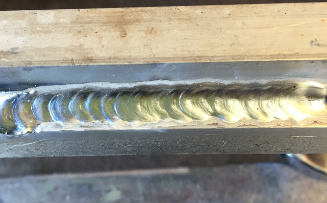

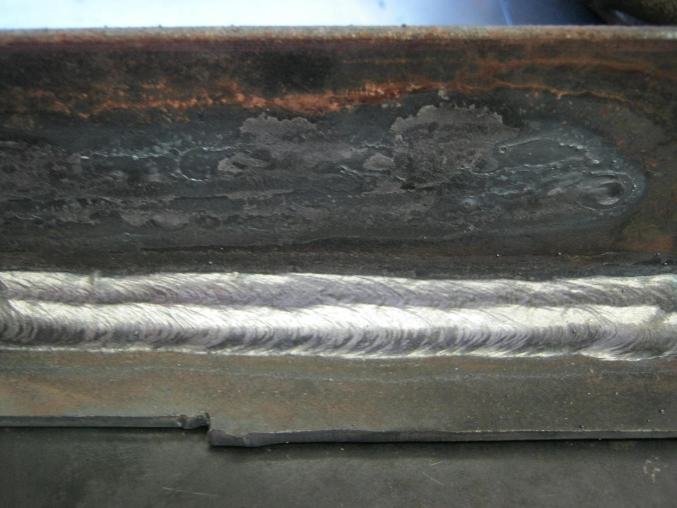

    As in your pics. 5356 sucks compared to 4043. I had no luck running 5356 with my little 140e. However, the 4043 was a dream. Also, if you have the right setting you should get no soot. I believe "Jody" (tips and tricks) mention soot is a "burn mixture" problem. I agree. Here is an unretouched pic of 4043 .035 @30cfh.
    Doc...Nice weld...my plate 3/16 ..was SSSmokin hot..Unbeknonst to me...Im tryn to spray with a connector burnt clean thru....I'll call Andrew in the morning.....He's the Go to guy....Has been the man in the know for me at least....

    That's the problem, it never gets better. I've been through ever setting in small steps several times until I gave up. 5356 never got better.

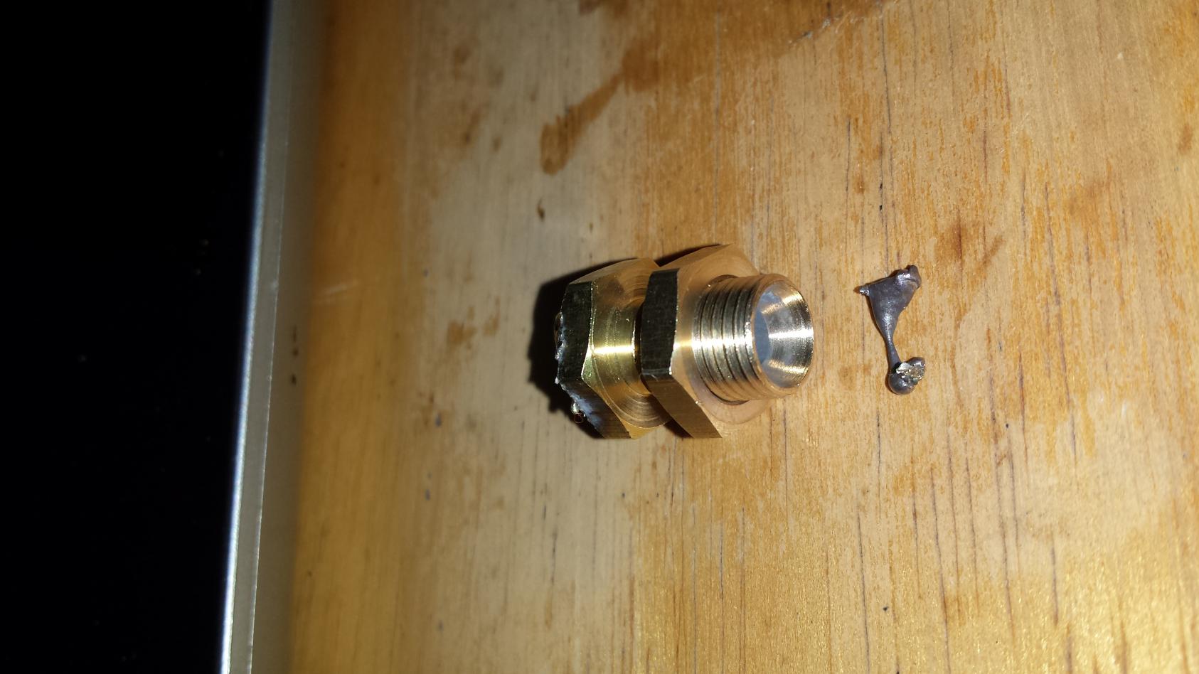

    Just found out what happened to my SG...Pulled the threaded nipple that hooks to the power stub & gas line.....Here's what I foundClick image for larger version.
ID:	13428Click image for larger version.
ID:	13429..Im betting ..this blocked gas flo..Kept it from cooling properly....

    What Im saying is..The third weld...(farthest left}..Theres a bead..small but way more than the other two which looks like the wire vaporized before it got there....With the bigger wire..your WFS is close to your machines max WFS...If your 350.....The bigger dia wire might get you where you need to be WFS wise.....Am I explaining this right??
    What Im saying is..The third weld...(farthest left}..There's a bead..small but way more than the other two which looks like the wire vaporized before it got there....With the bigger wire..your WFS is close to your machines max WFS...If your 350.....The bigger dia wire might get you where you need to be WFS wise.....Am I explaining this right??
    I know what you're saying but I have a good bit more wire speed and I get the same result with larger wire. I have .035 and .045 in both alloys and two brands. 5356 never got better than the far left weld, no matter the wire size, speed, volts or argon flow and I went through it meticulously. I was filling my shop with aluminum smoke over and over. I quit the spool gun before I damaged myself and tig welded my boat stringers with 5356 filler.
