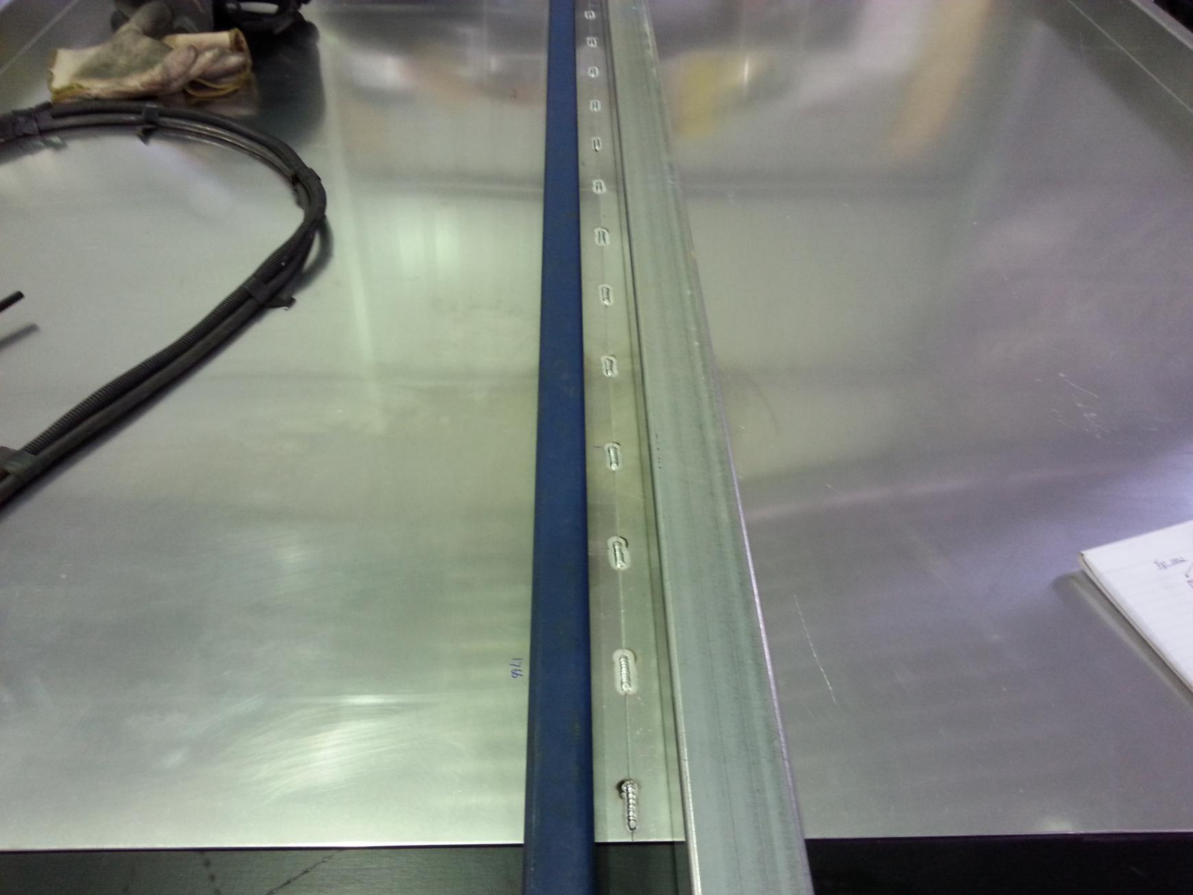

    My 200dx sounds like it is clicking relays on and off all the time when it is not being used. I have it on AC settings and it randomly has clicking noises coming from inside.

    Unplug it and see what happens. As the main power switch is a circuit breaker that cuts all power, unless one leg isn't being cut, I can't see how the machine could get any power. Is the gas shut off?
    I think he means the relay clicks on and off while power on. I had to re-read it and that was what I got. But like Mark said, best to call support. Does it weld OK?

    Yes machine is still turned on with led display on.
    I actually have holes appearing when welding, did an example weld only using just the tungsten and no filler. Whether or not this a gas related issue or contimanation as opposed to a electrical issue I not know. I did this weld on a bit of 1/2" thick flatbar to show the issue. I never weld 1/2", was just using the thicker aluminium to see if it too would give the bubbles.
    It does this on 3mm 1/8" thick aluminium too. Is that just what happens to aluminium if you heat it up and do not use filler. I would love to see someone else do a similar test.
ID:	13420I just did this weld on the 1/2 flat bar to show better the hole I get. It does the same thing on 3mm ally too.
    Here is a photo of some 3mm sheet butt welded together.

    Welding (melting) without filler rod should produce nice shiny puddles. Given the porosity issues in the photo it looks like your light on gas. When you hear the clicking does the flow gauge ball move off 0 at all? When you welding is the gauge showing normal and steady flow? And of course did you acetone then brush the aluminum?

    That sheet photo doesn't show problem that I can see. Maybe a close-up would help.
    If there is a pervasive problem with porosity, it is most likely gas related. And like one guy on Welding Web suggested to you, that a bad collet and O-ring at the torch can introduce air into the gas stream and cause problems.
    I'd get a spray bottle with soapy water in it and check for leaks all up and downtime line.

    That doesn't sound much like a Relay to me, I'd be thinking that's High Voltage arcing out. It's more of that kind of Snap....
    Look around it in the Dark while it's doing that, you might catch sight of a flash
  18. Default
    well, that sounds interesting because there seems to be a 'flat spot' on the pedal when using the machine too. Where is just has no power and is a very bard arc. I did start another thread for that.
