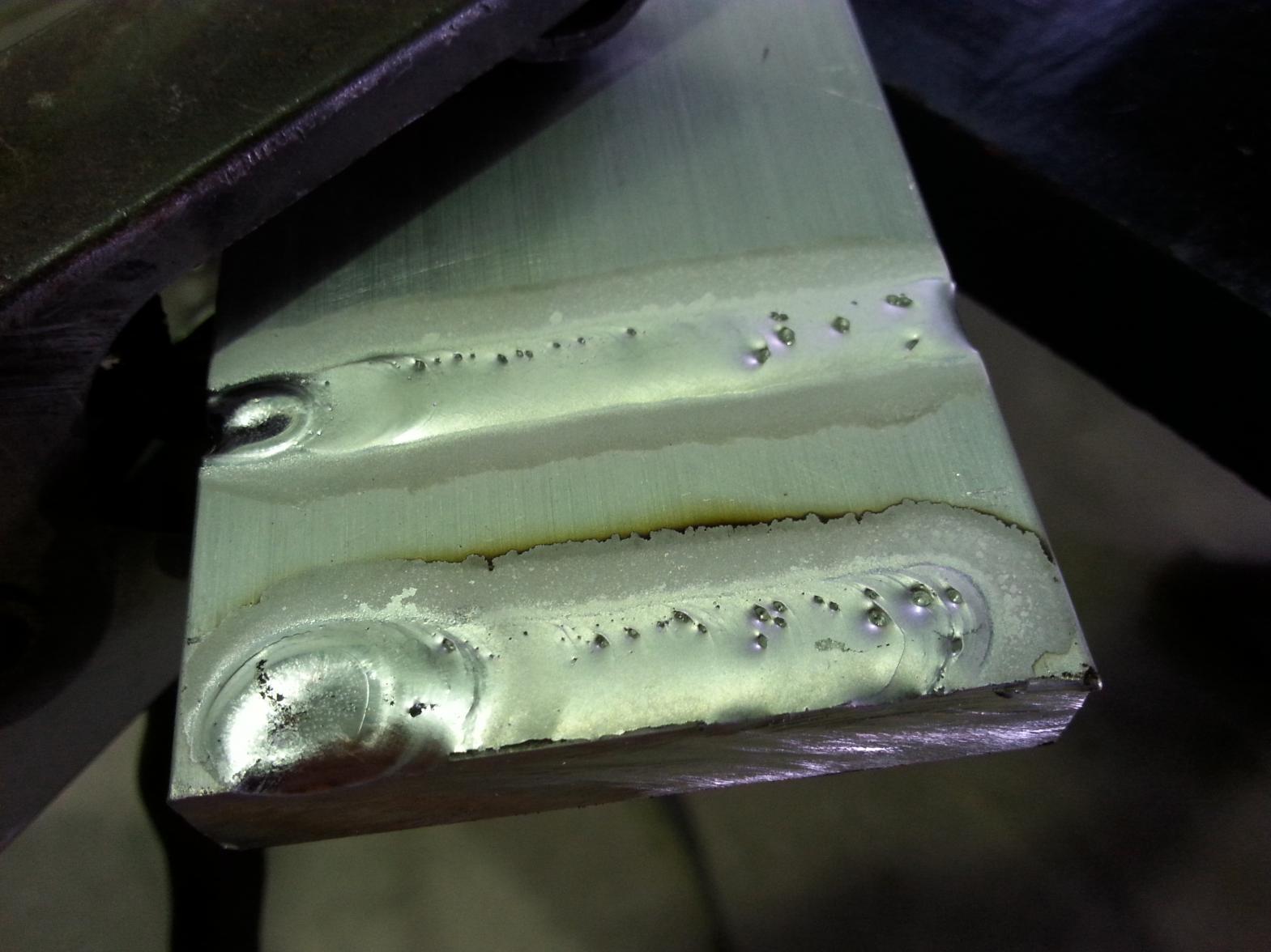

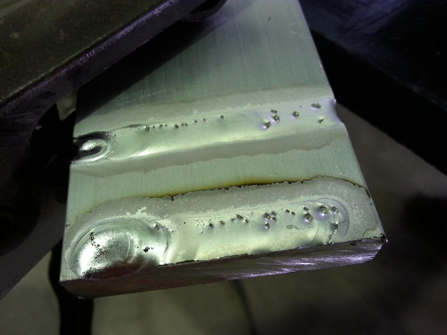

    I actually have holes appearing when welding, did an example weld only using just the tungsten and no filler. Whether or not this a gas related issue or contimanation as opposed to a electrical issue I not know. I did this weld on a bit of 1/2" thick flatbar to show the issue. I never weld 1/2", was just using the thicker aluminium to see if it too would give the bubbles.
    It does this on 3mm 1/8" thick aluminium too. Is that just what happens to aluminium if you heat it up and do not use filler. I would love to see someone else do a similar test.
    Also, tungsten so. I have always used 2% lanthanated. Boss went to the store to get supplies, I said we needed more tungsten so, gave him the old pack and off he went. Came back and the store did not know what they were and do not sell lanthanated. So he ended up with the white tip Ceriated.
    What I did notice was the weld beads were considerably shinier and cleaner with ceriated.

    You've posted this "bubbles" photo on Welding Web already and have received feedback too.
    Are you now shopping for a new answers or do you just like to show the picture?
    Again, shove some rod into the puddle and move the torch.
    Quit blowing bubbles and being mystified by it. Ha, ha, ha...

    So I guess then that this is normal. This is simply what happens to aluminium when it is autogenously welded then?
    Well,
    Apparently so, aluminum welds don't do well without filler, unlike the ferrous metals.
    I mean, I'm new to AC TIG on aluminum myself, and have not seen that tendency yet. But I use filler rod when joining aluminum pieces or laying down beads, and I haven't dwelled on 1/2" aluminum plate in an autogenous fashion.

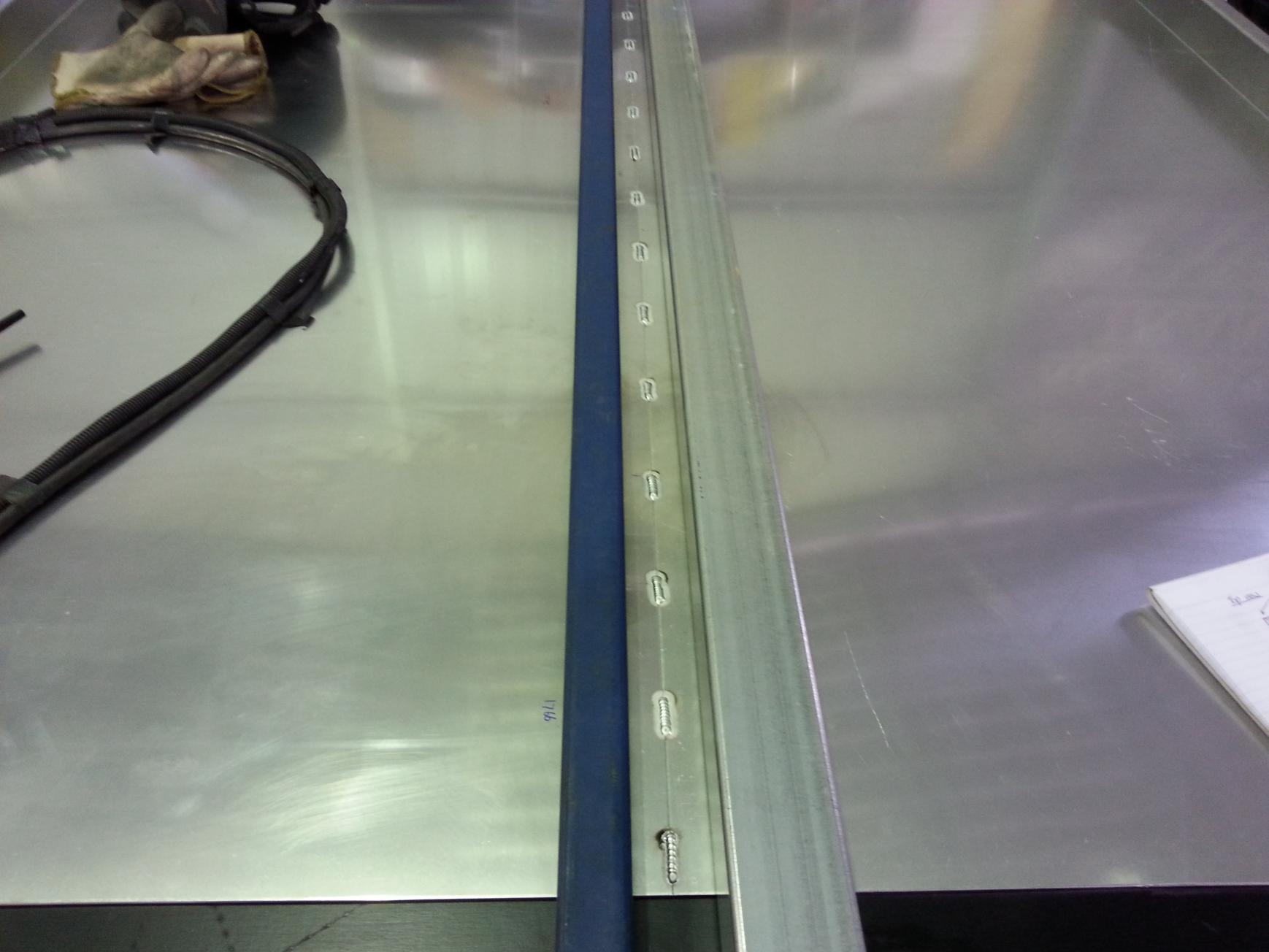

ID:	13420I just did this weld on the 1/2 flat bar to show better the hole I get. It does the same thing on 3mm ally too.
    Here is a photo of some 3mm sheet butt welded together.

    Welding (melting) without filler rod should produce nice shiny puddles. Given the porosity issues in the photo it looks like your light on gas. When you hear the clicking does the flow gauge ball move off 0 at all? When you welding is the gauge showing normal and steady flow? And of course did you acetone then brush the aluminum?

    That sheet photo doesn't show problem that I can see. Maybe a close-up would help.
    If there is a pervasive problem with porosity, it is most likely gas related. And like one guy on Welding Web suggested to you, that a bad collet and O-ring at the torch can introduce air into the gas stream and cause problems.
    I'd get a spray bottle with soapy water in it and check for leaks all up and downtime line.
    I'd also get a fresh bottle of Argon.
    Did you call the Everlast support number?
