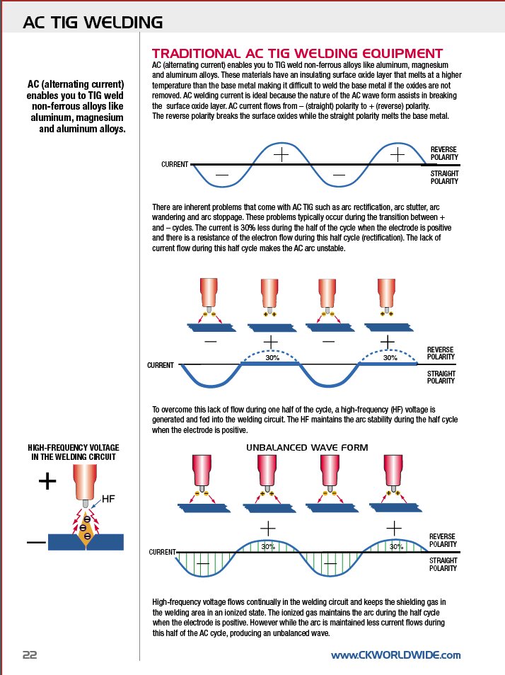

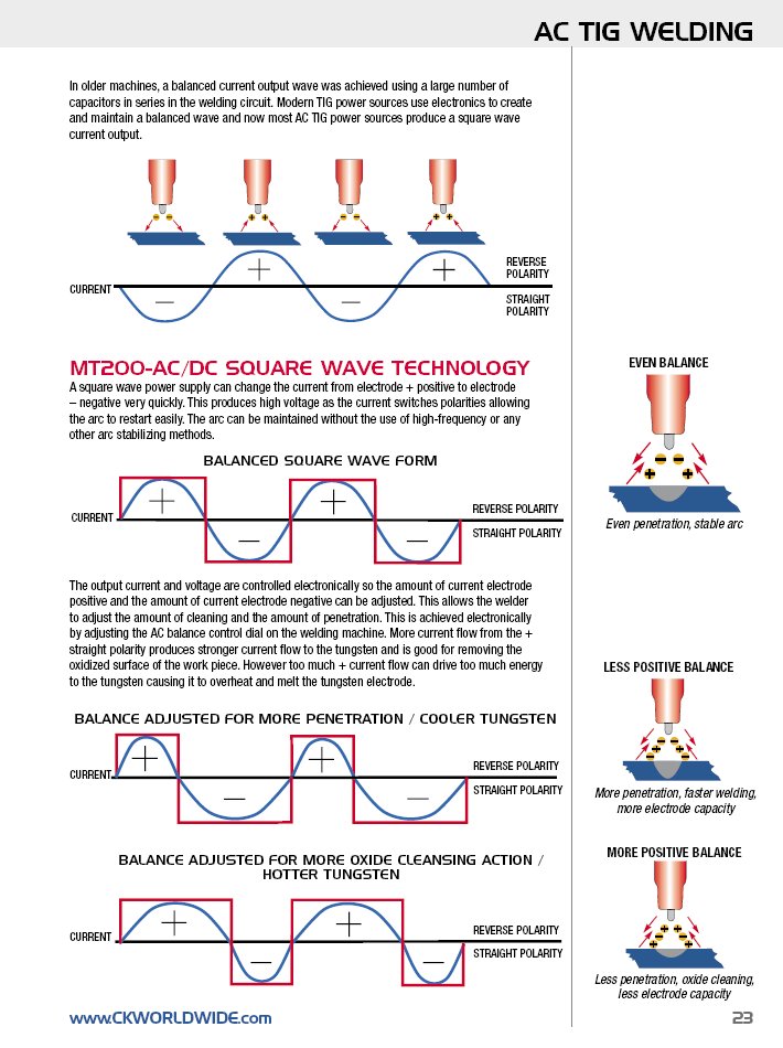

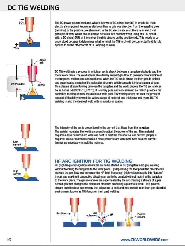

    OK - while on the CK website I found some data about this TIG polarity - seems it does make a difference even with IGBT machines - maybe.....:

    Could it be that the 'balance' on AC may be confusing with the torch on negative.... Looks like the HV arc start may be affected too. Is this data correct for our Everlast machines?
    You can see why the balance control would be reversed if you swap the connections. But in reality you are always using more negative than positive for the electrode on AC squarewave. 50% is like full cleaning mode, and you go down from there. Some machines like Everlast are calibrated in percent, some have just a low to high or a 1 - 10 scale. Early squarewave machines that used that had #3 marked as the balanced setting. With your 255EXT you will find that 30% is a good starting point. go down from there on really clean metal for extra penetration, and up on not so clean, for more cleaning action.
