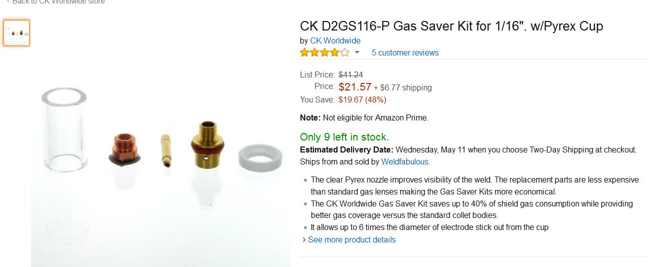

    Does anyone have experience with these? And - will they fit the 9 and 20 series Everlast torches?
    Thanks, Meant to type "9 and 20 series"
    Bill C
Name:	CK D2GS116-P.jpg
    If I had gone to the CK web site to start with the question would have been answered! Yes - this works with the CK 9 and 20 series torches.

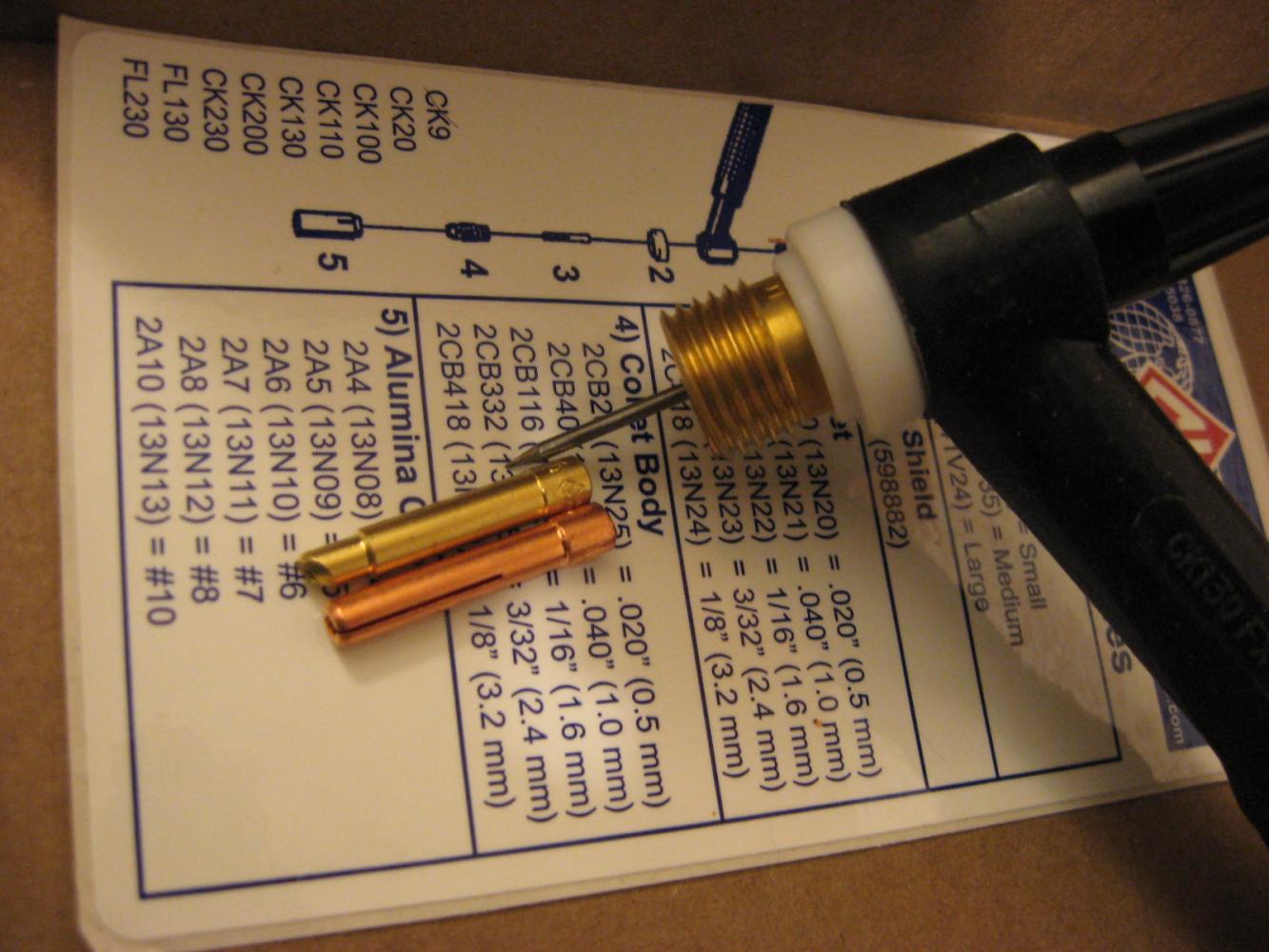

    I like the CK wedge collets much better than standard ones and they work well with the generic gas lenses above.

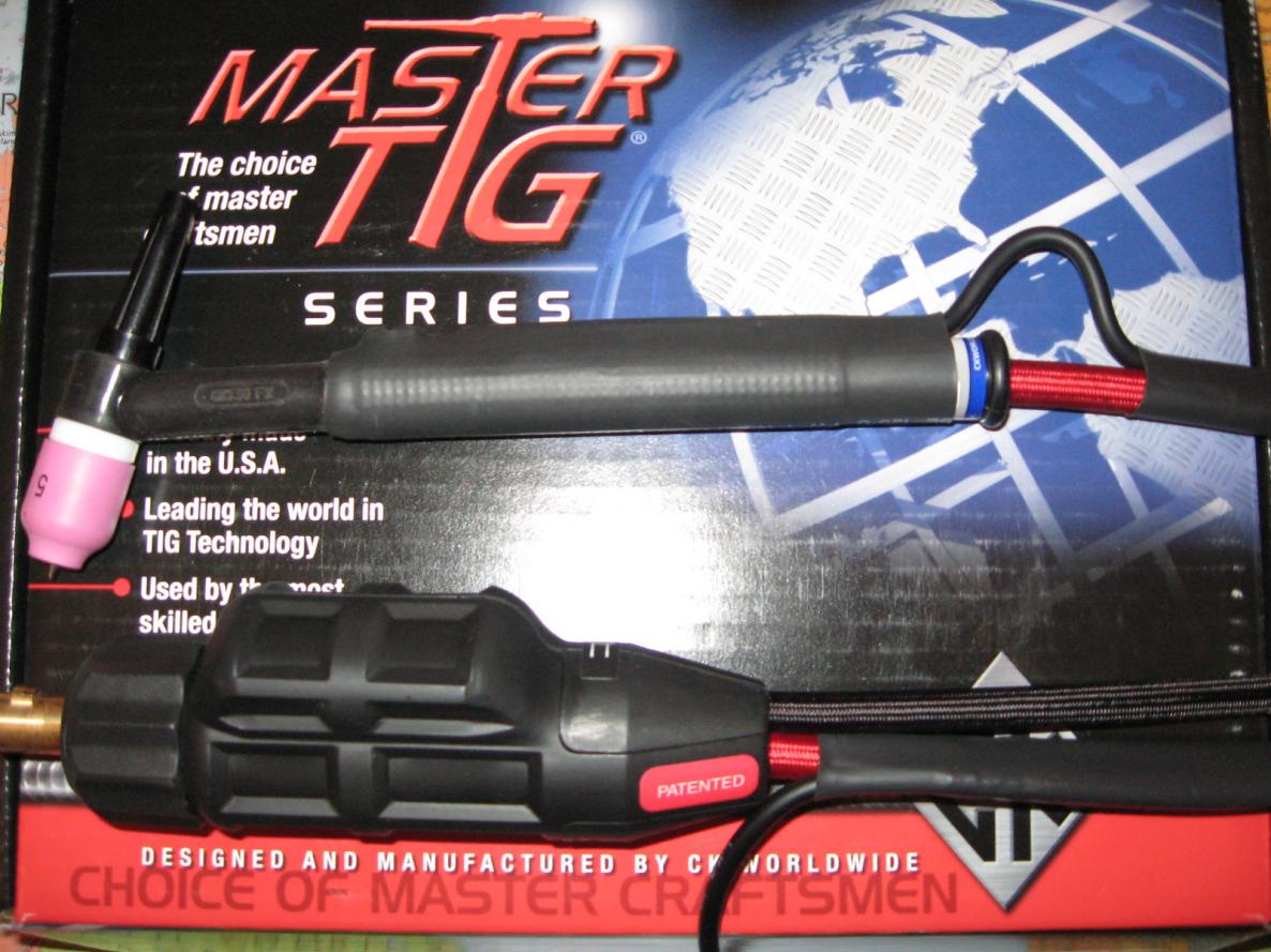

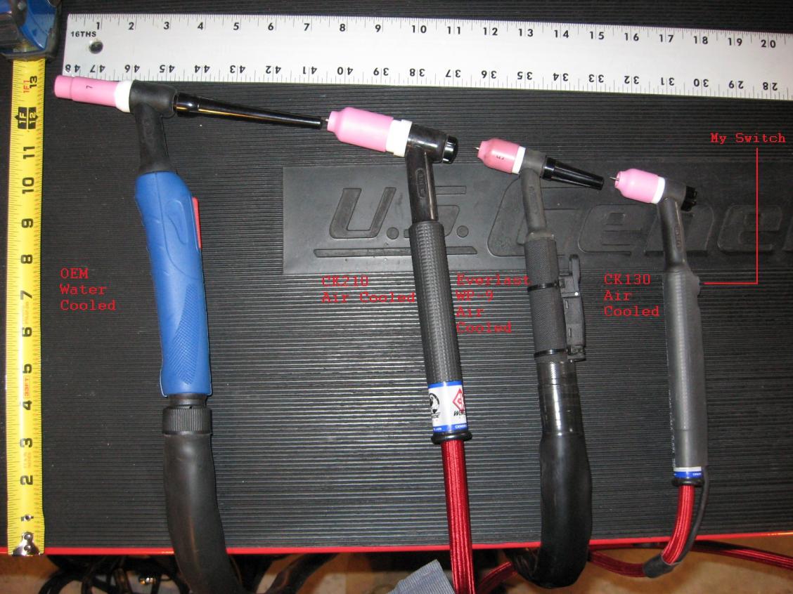

    Here are a few pics of my torches. The first shows the difference in CK wedge and standard generic collets. The second is my CK 130F with a generic gas lens assembly from weldingcity and a switch that I added to the handle. The third pic is the torch that came with my 250EX (never used it), a CK 210 with generic gas lens assembly, a generic #9 with gas lens and the CK 130F from the second pic.
