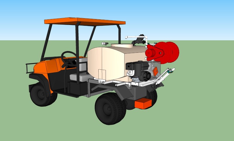

Yet another Kubotoa RTV conversion. This one is a little different. Larger tank than last time and everything mounted up higher for more destructive areas. Found some real aggressive tires to give it some more bite, too.
The original plan...

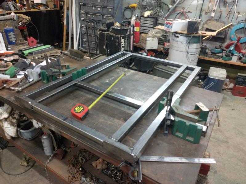

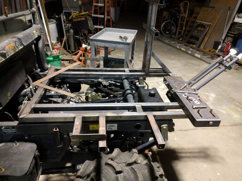

Here is the basic framing. You can see I had to do a little heat straightening on a few pieces after the welding. Next time I need to plan out the order of welding a little better.

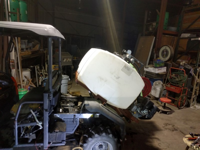

And the finished product. Stayed pretty close to the plan. This time I added a hydraulic lift to make service a lot easier.
