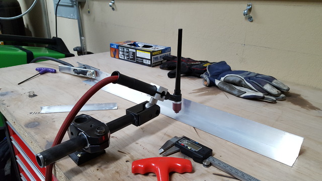

    I took the cover off the machine last night to check the hf gap and ensure all the electrical connections were firmly seated. The HF gap was set at .028". I did not attempt to adjust or change anything in regards to the gap. All the electrical connections looked fine.
    Today i proceeded with testing the welder using a fixture to hold the torch at a set distance and to ensure the stickout length was correct.
    Problem still exists.
    Settings:
    Amperage: 5amps
    Frequency: 120Hz
    Balance: 20-25%
    Argon flow: 8cfh
    3/32" 2% Lanthinated Tungsten
    Gas lens with a #4 cup
    CK 9 series rigid torch
    Material Dimensions: 1.5" x 1.5" x 1/16"
    Stickout Length: 3/16" (2x diameter of tungsten)
    Tip of Tungsten to Workpiece Distance: 3/32" (2.4mm)
    I'll try to post a link to the video later this evening. It's doing the same exact thing as in the original videos.

    The torch is mounted in a fixture i threw together. Suggestions? Comments? Where should i go from here? Really need to get this issue cleared up so i can proceed with my projects. I'm available to talk over the phone tomorrow morning (eatern time) with tech support.

    I would call tech support. We have exhausted all the forum has to offer. You say then you turn the amps down in AC it will not go to 5 +/- amps?
  15. #35
    Lots of issues here with setup. You are at 5 amps. This is the absolute lowest you can start an arc when all conditions are perfect with a small tungsten such as .040 or possibly a 1/16, not a 3/32". I'd try thoriated in this situation. We always say to allow for up to 3 amps variation. But additionally, the arc gap is too large, as I was saying to sustain an arc at that amperage. You have to be right on it. You need to be at half that distance or less for low amp starts and definitely more taper. And the metal should be clean. I am not seeing clean either.
    The arc gap is not the problem. I can redo the setup at whatever settings you tell me. The machine does not run right at 5 amps or at 50 amps. It sputters regardless. I can set it up with a .1mm arc and gap and 50 amps if you'd like. It will still sputter and pop and not weld right.
    The aluminium was cleaned with a stainless brush and acetone. How do you suggest i clean it further? I am setting things up just as i would at work with a Miller. No problems there whatsoever. I tried a smaller tungsten in previous attemps, as suggested by tech support and was told i was using too small of tungsten. Now it's too large? I have tried everything from .040" all the way up to 1/8" as previously stated.

    Look, what else can I say? I'm a bit frustrated. I am trying to help, not punish you. I am doing SOP here.
    I've given you what I saw. You wanted help and tech support, but you keep showing me things( and the others as well) that support unstable operation. Then you say when I respond," well it does it at any setting". I'm telling you what I see. You cannot use any condition you want and expect it to weld right at low amperage. I am not saying the unit does not have an issue, but in the cases I've seen you post, you don't have things right. We know things about the unit that you may not understand. When we tell you it may be this or that, you just categorically state it isn't. You stated you tested the foot pedal last night...but don't even say how or under what circumstances you did it. You show in the picture 5 amps...not 70.
    This type of thing should be tested with the torch switch first, under controlled conditions to rule out error.
    Set the machine up with some thoriated .040" tungsten if you want to weld at 5 amps. Use the torch switch to start the arc (4T if you don't want to keep your finger on it). Keep the gap to a minimum.
    You can't use the foot pedal adequately and set the unit to 5 amps and expect it to weld. You have a huge throw and it has to be maxed out before the arc will start and stabilize if you do. The greater the amperage, the better the unit will start with the foot pedal.
    Any discrepancy in the foot pedal is then magnified...and what you are telling me leads us back to the foot pedal as a real possibility. Again, it may not be, but what I've seen has not ruled it out.
