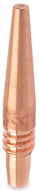

    The trick is to always use a tapered tip. The less frontal area on the tip the less heat it absorbs. I haven't needed to oversize the contact tip since switching to tapered, spraying steel or aluminum.
    Its been awhile since I've used the spool gun Zoama but I don't believe I've heard of a tapered tip I'll have to look them up. I did find out when you burn a tip on a spool gun while welding aluminum you usually trash the tip.

    Quote Originally Posted by oleblu72 View Post
    Mark
    They look like this... Click image for larger version.

    Wow,
    I'd never noticed tapered ones before, although I haven't done any MIG welding for about 20 years now.
    But if I do MIG anytime soon, I'll undoubtedly shop for those tapered ones.
    I suppose you could just add a taper to existing ones with a flap disc on an angle grinder, too.
