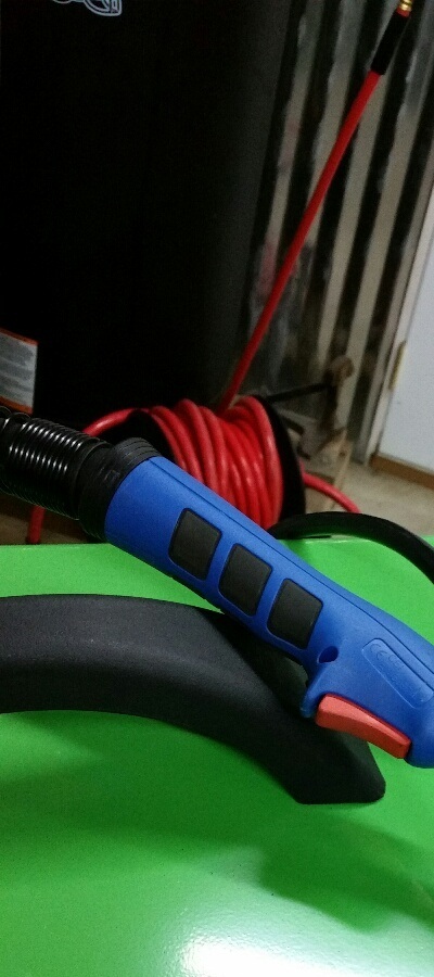

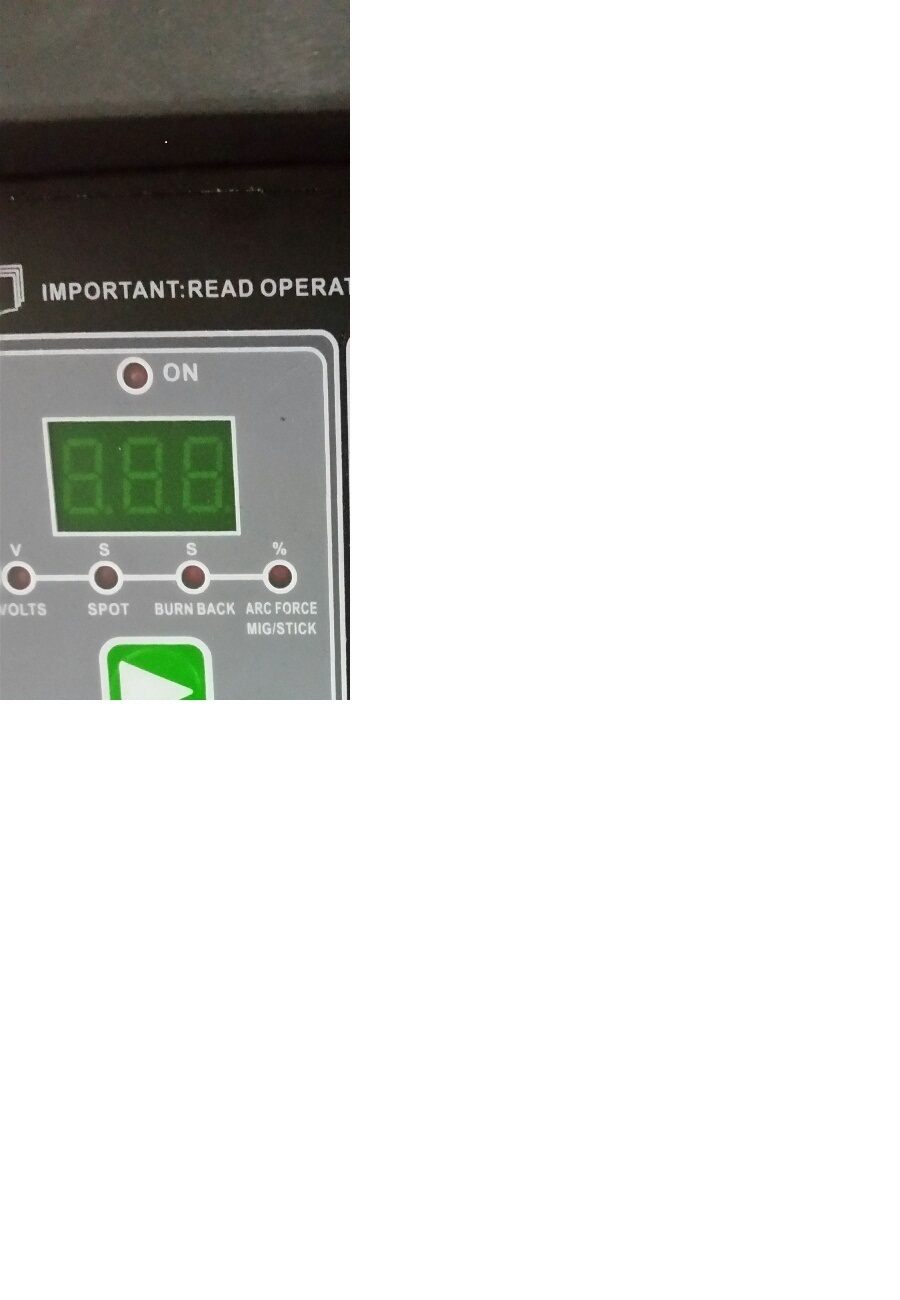

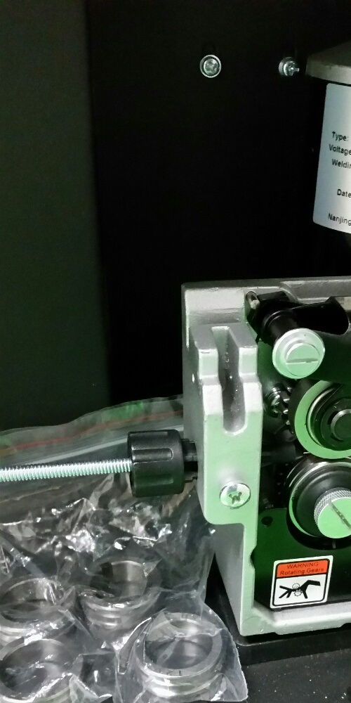

    Power Mig 275S,
    Overall look, fit and large handle very nice. Came with rollers for 0.6, 0.8, 0.9, 1.2 and 1.6 wire. There is one more size. 2 sizes per roller. The roller system is made very well and solid. The control panel is straight forward and easy to use. The 275s has a Synergic Mig mode which automatically sets the volts for you depending on what you set the wire speed to. The Synergic Mode works very well. The settings leave a flat weld that penetrates. Now when I used the Syn Mode you have to be ready to move, the 275 lays down the wire and burns it in without hesitation, so you need to have your material ready and your proper positioning ready to roll if you want to make the whole weld without stopping. If you have a tough position to weld in or need to move slower for whatever reason I would place it on manual mode and turn down the volts some. I have not tried aluminum yet so I can't comment on the 275S's aluminum performance. Nor have I tried the stick operations. As you can see the welder does have a E6010 mode. The 275s laid down some very nice beads whether I welded 1/8 wall material or was spot welding sheetmetal. The welder has two cooling fans but is Very quiet which is nice compared to other welders and plasma cutters I have. If you like using spool guns you will have to order the 200 MTS gun. The 200N gun has a female connector as does the 275S. Overall I'm happy with my first impressions of the machine. Pictures coming.

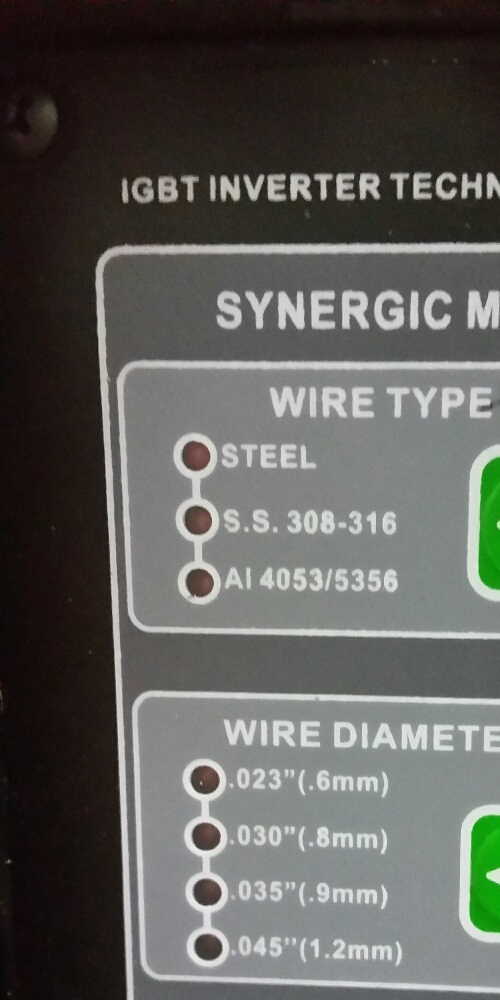

    did i read that right for types of wire?5356 and 4053 for aluminum on the front of panel?
    250 ex
    205 mig
    milwaukee grinder
    140e mig
    I expect that should read 4043/5356. Lost in translation I imagine.
    New labels have been requested to correct.

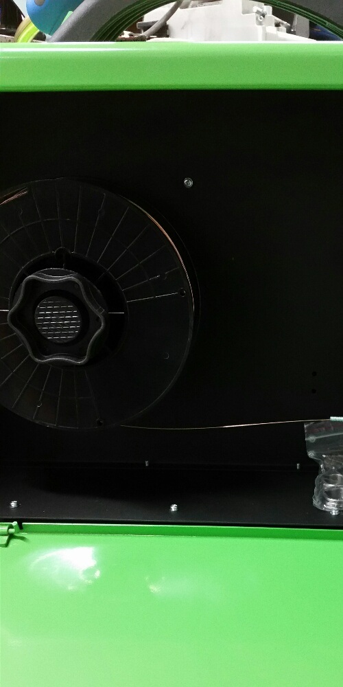

    When I installed a 44lb spool of Lincoln wire the rear latch cannot close on the door because of the thickness of the latch and the old fiber type spool of wire
    I can remove the latch with no problem and the front one will hold it fine its just something they didn't consider in there design

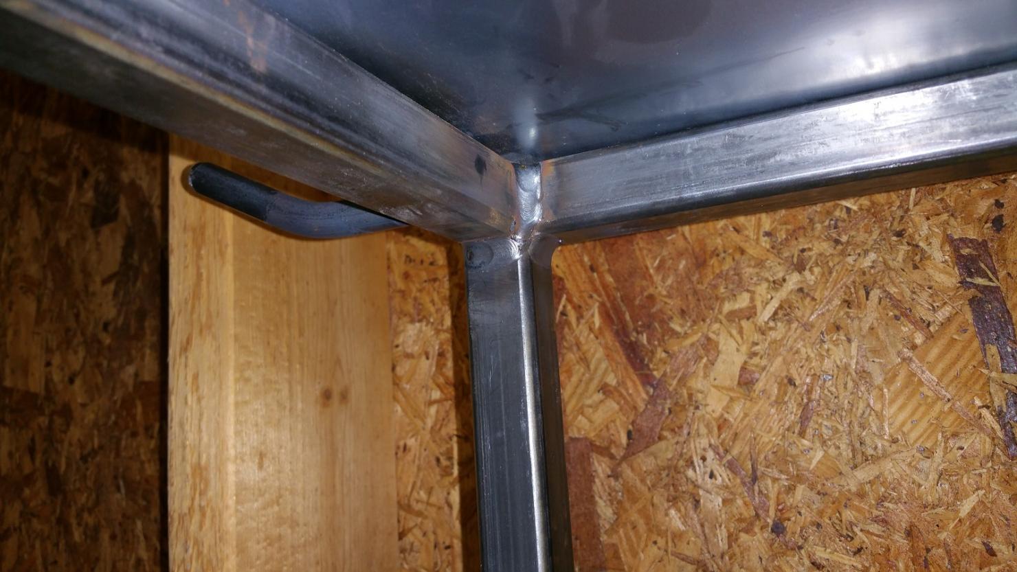

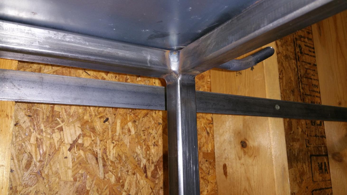

    You will find the sweet spot by adjusting the arc force/inductance setting after you complete other adjustments. Start with it at about 70-75%.
    Well thought i'd update again since my last one in May
    Ive been welding up some 3/8" brackets with some tight places
    I've purchased a smaller K24 mig gun and it works very good much easier
    to use and have had 0 problems with duty cycle timeseven running continuously
    I'm still having one big problem with splatter and not the kind that's easy to remove
    I've adjusted the arc force down and its gotten better and using splatter spray
    helped too but still has not gone away
    I have some 90/10 gas mix so might try spray transfer
    anyone have suggestions please reply
    thanks
    James

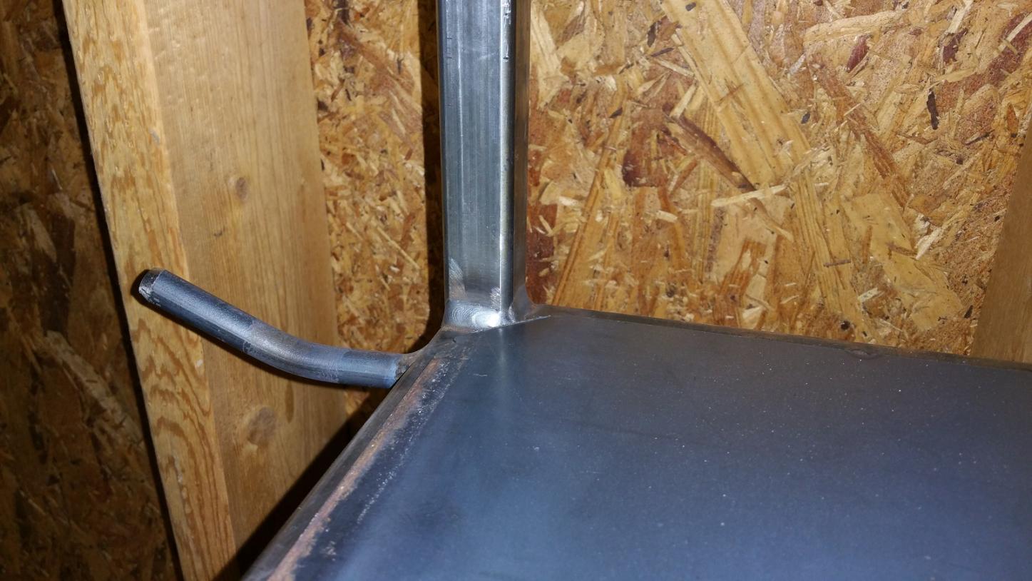

    I spray everything I can using 75/25 gas. Someone keeps telling me I shouldn't do that but as long as it makes solid spatter free welds I'll continue. I mix my 75/25 with pure argon to spray thinner material like this 1/8" tubing.
    I'm just a hobby welder with no formal training.
ID:	13650   Click image for larger version.
ID:	13651   Click image for larger version.
