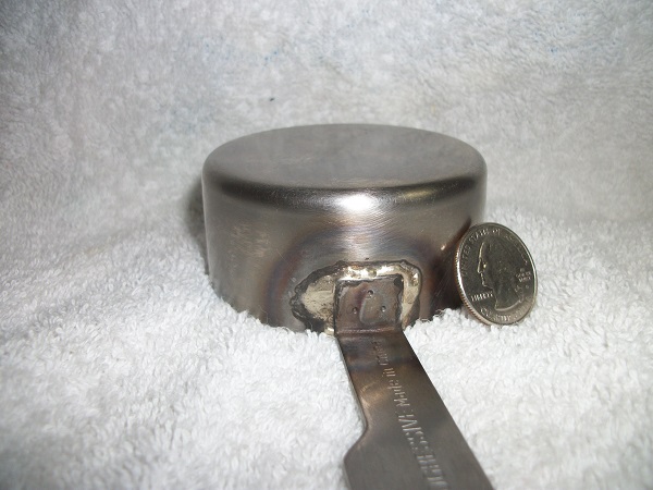

    What can I say? I liked the measuring cup and didn't want to see it repurposed outside the kitchen.
    Photo number one is after brazing with oxy acetylene and a Harbor Freight version of the Smith mini torch. I *should* have tinned each part then held the two together with a spring clamp heating until the brazing compound liquefied again. It would have made for a cleaner joint with less goopy edge. Oh well, next time.

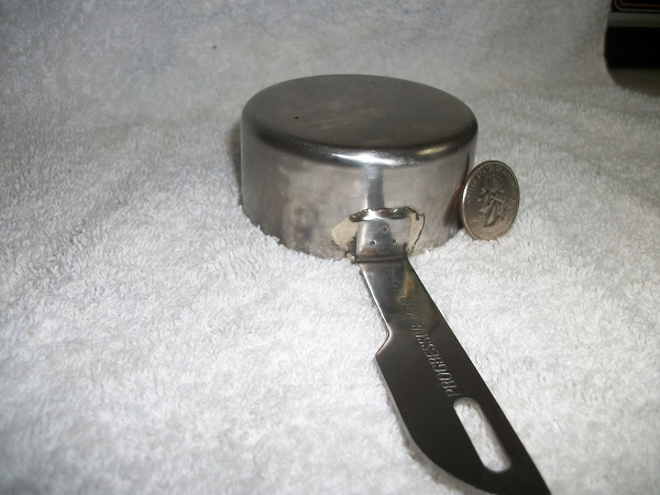

    The second photo is after cleaning with a Scotch-Brite pad on a die grinder following up with the Dremel and buffing compound.

    Looks good to me. Hey if you like someone thing and have the tools to do it. A project and some fun. What size if the cup. Looks small.

    The size is 1/2 cup.
