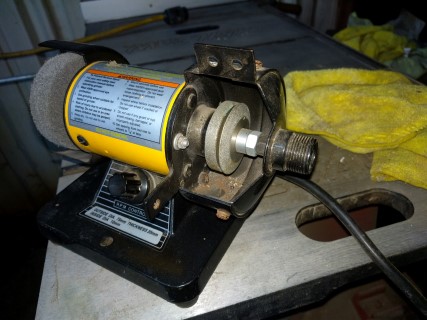

    You can grind tungsten with different things. Tungsten is really hard so it grooves up most grinding wheels pretty fast. Diamond wheels are the way to go, and while the big ones are pricey, I just use a little cheapy from Harbor freight on a tiny 3" 10K rpm bench grinder as a low cost solution that has been working great. Having said that, for steel I will often touch up a tungsten on an angle grinder right where I am working. Not ideal and not good for stainless or aluminum, but for general steel fab it's fine.
    http://www.harborfreight.com/large-d...-pc-69658.html
Name:	IMG_20160220_222541 (Mobile).jpg

    I use one of these diamond lap disks http://www.ebay.com/sch/i.html?_from...p2045573.m1684 on a cheap 6" bench grinder with no guard. 360 or 600 grit will work fine. I've had the same one for 3 years with no noticeable wear. I spin my tungsten in a drill while holding it at an angle where any scratch marks will be in line with the tungsten. The angle is about the same as a pencil sharpener produces.. a little more angle for high amps keeps the point from melting so easy. 3/32 tungsten will do 95% of your work. I like 2% lanthanated for everything. A box of 10 7" pieces cost $20 here in the US http://www.amazon.com/gp/product/B00...rhf_pe_p_img_4. If you only use one type of tungsten you can take the blue paint off and sharpen both ends. One box should last years in my opinion.

    Your Ebay link didn't work, so I just searched for diamond lap disk and found lots of them. Thanks for the grit recommendation. I'd never heard of that gadget before. I have a 6" HF grinder that I'm afraid of. It vibrates so bad I won't use it. Tried repositioning the stones and nothing helped.

    Get new stones. It should be fine after that.

    HF stones are dangerous. I had one explode on my 8" grinder as soon as I installed it and turned the machine on. I use the guards on that one and got a name brand stone that works fine. When you use your diamond lap it only needs very light pressure. Are you a native English speaker ?
