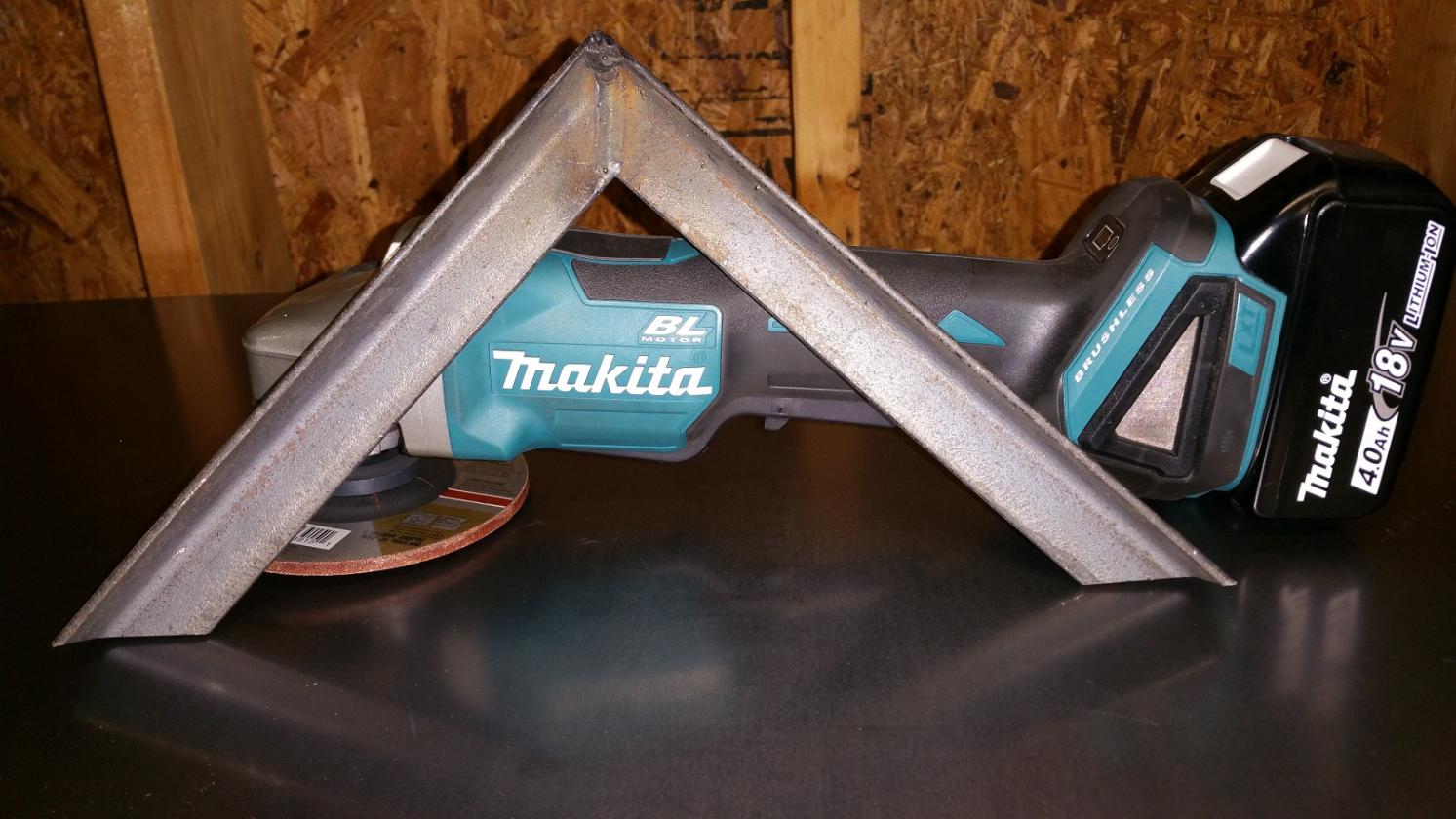

    I also bought a pair of Makita 18v brushless paddle switch angle grinders that work as well as 7amp 110v models but they're in the $100 each range. I use them the most now.
