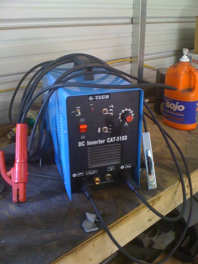

    received the replacement for my ct518 was going through the acc. and seen that thes fitting where the argon lines hook to the front of the unit isnt there justg a hose no screw fitting contacted alex and he sent me another torch assembly and it has no fitting either where can i get one of these fittings also the little gauge and the barb fittings for the air regulator for the plasma torch are missing was wondering where i could find these also. thanks
    Tjb,
    The wording, punctuation, and capitalization makes your post hard to read and understand.
    Can you post a picture of what you are talking about? We can get you straightened out I think, but a picture of exactly what you need would do wonders. Thanks.
    sorry i have a bad habit of typing that way. i will post a pic of it when i get home this evening. what im talking about is on the tig torch (the end where it hooks to the welder unit itself) you have a connector that plugs in for the power,you have a plug that has six or seven pins on it and you have the hose that the argon comes through. on mine there is a plug for the welding lead, a plug for the pinned connector that threads on, but where the argon hose threads on it doesent have the connector that threads on to the machine (torch side of connector is missing ) just a hose sticking out of the torch harness. i will get pics this evening.
    Yeah if you can get pictures, that will help figure this thing out.
    its the black hose in the middle, should have a brass fitting on it to screw onto the spot in the second pic where i am pointing.

    tjb,
    That unit is blue...???
    yes it is, the one that was replaced was yellow, opened the new one and it was blue was kind of expecting green.
    was wondering if any info on this yet? was also wondering about the gauge that screws into the regulator for the air ,for the plasma cutter, went and got one but the threads are differnt. thought it was 1/8 inch pipe but not quite the right threads.
    This is a matter that you'll need to talk directly about. We cannot send it to you without the information we need to ship and knowing "who" you are.
    The hole should have a pressure gauge that fits in it.
    This is a Mosfet type torch with different fittings. Its like our plasma fittings. Need to know what MM it is across the face. A standard US equivalent is fine, we can convert it. There's a 16 mm and a 14 mm.
    When you call talk to sales and point them to you post here. They can see the pics then. Can you post a wider view of the entire unit just for frame of reference?
    sure can . they even have a dated sticker on the back now the old one dident have anything on it at all. the date on it is 3-10-2010

    Why dont he just change the fitting to the fitting like the 250 tig with a quick disconnect chuck.
    The units are wired differently. The whole fitting is designed for a torch connection, if I remember right. We have spoken over the phone, and hopefully we will have it resolved.
