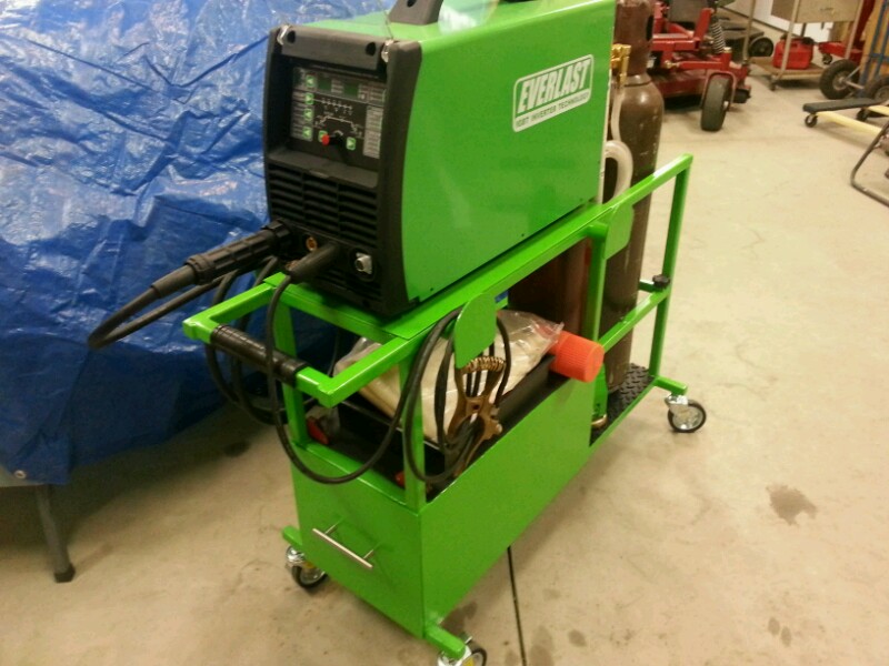

    Here's my nearly completed multi process welding cart for my MTS211Si. Paint was the closest I could find off the shelf. Holds two tanks (for mig and tig), and has a large drawer. Built with 1" square tubing and 1/8" plate... it is solid for sure.

    Very nice, the paint matches perfectly. I'm glad to see someone else using stem casters.

    Very nice indeed. I like the big drawer. Is that for dust free helmet storage?
    Great color match. too. I see you even did your mag gun holder.

    Thanks, and nice catch on the matching holder! Honestly, I haven't decided what's going in the drawer yet, but my helmet is definitely a top contender.
    I'm planning to grab better pics soon. It's hard to see, but there is a movable bar in the back securing the tanks. Two spin off knobs hold it down, and there is another position more forward if there is only a single bottle. The forward position is at a slight angle to keep the tank from moving side to side. I'm putting some pvc edge trim on all four side cable holders. That will be especially helpful where the wire spool access door opens. The casters were used since it will be "parked" in a tight spot sideways, allowing it to be stored out of the way.

    You can add another removable bar to the top back as well if you go for taller tanks. Color match is good too. Looks like you covered all the bases. Good job.
    Added the edging around the cable hooks. Here's some more pics:

    Dang, wish my place was that organized. Nice cart, like the way you can make it disappear againt the wall, I have locked rear wheels on mine.

    Optical illusion!
    The photo of the drawer pulled out looks WAAAY longer than the space where it fits!

    What's the paint you used to get this good of a match?
    Was it some off the shelf spray can or did you get a Pro shop mix you a pint?

    Paint code is RAL6018. Easy to match if you have a local paint store.
