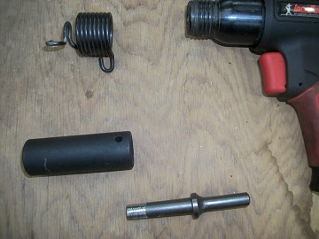

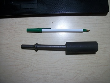

    A good used SDS demolition hammer/drill on Craigslist still starts north of a C note. Let's see if $10.00 worth of Harbor Freight butchered and cobbled together originals can accomplish the ten foot electrical grounding rod driving chore?
    Buy pneumatic chisel set and half-inch drive 3/4" socket from Harbor Freight. Test fit socket/chisel combination on gun cutting to length. Hand lathe the chisel on the bench grinder to decrease the diameter of the cut end so it will fit in the through-hole of the socket. Weld the chisel/socket from both ends.

    A short test with rebar seemed to work well. The first attempt hit a baseball-sized rock three inches in the dirt. I was curious and dug it up off-camera.

    Sunk four 8' ground rods this past week as part of a grounding array. The pneumatic gun setup was perfect for starting the first three feet of the sink. Then, it was faster and easier to bang them in manually with a sledge.
    Still, I consider the effort a success due to the ease with which the first three feet started perfectly straight.
